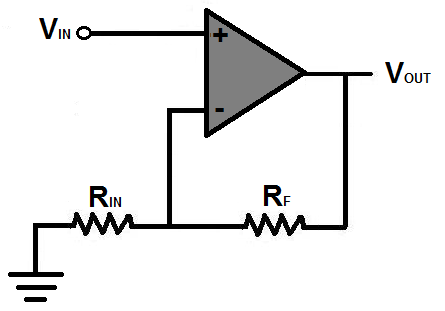

From the schematic we have a feedback resistor : 7,5 KOhms and a resistor to ground 270 Ohms.The gain is : (7500/270) = 27,78 times.
In dB this is 20xlog(27,78) = 28,8 dB.

The input stage of the original Telos has no gain. R feedback is 2k2 and the R to ground is also 2K2. It is only a buffer that drives the attenuator between this input buffer and the power stage.
Jus a simple question about the gain, in another (old) thread, using the same opamp in a similar schematic I came across this statement to calculate gain for Noninverting Op Amp Gain:
try changing the feedback lower resistor to 2k
For a 2times gain set the upper feedback resistor to 2k
If you need extra gain change the lower resistor by paralleling another resistor.
Gain = Upper/Lower +1
2k/2k+1 = 2times
On an amp gain calculator site I found:
attachment.php
attachment.php
Source: Op Amp Gain Calculator
So, much like BYRRT stated, I had figured the gain of the pré amp stage to be 6 dB.

You are absolutely right. In a non inverting amp the gain is 1+Rf/Rin so the input stage has +6dB gain. My calculation is for an inverting amp...
So the goldmund has a gain of 1+ 7500/270 = 28,78 in dB: 20 log (28,78) = 29,18dB or 29 dB as Goldmund states.
Thanks for confirming that :).
