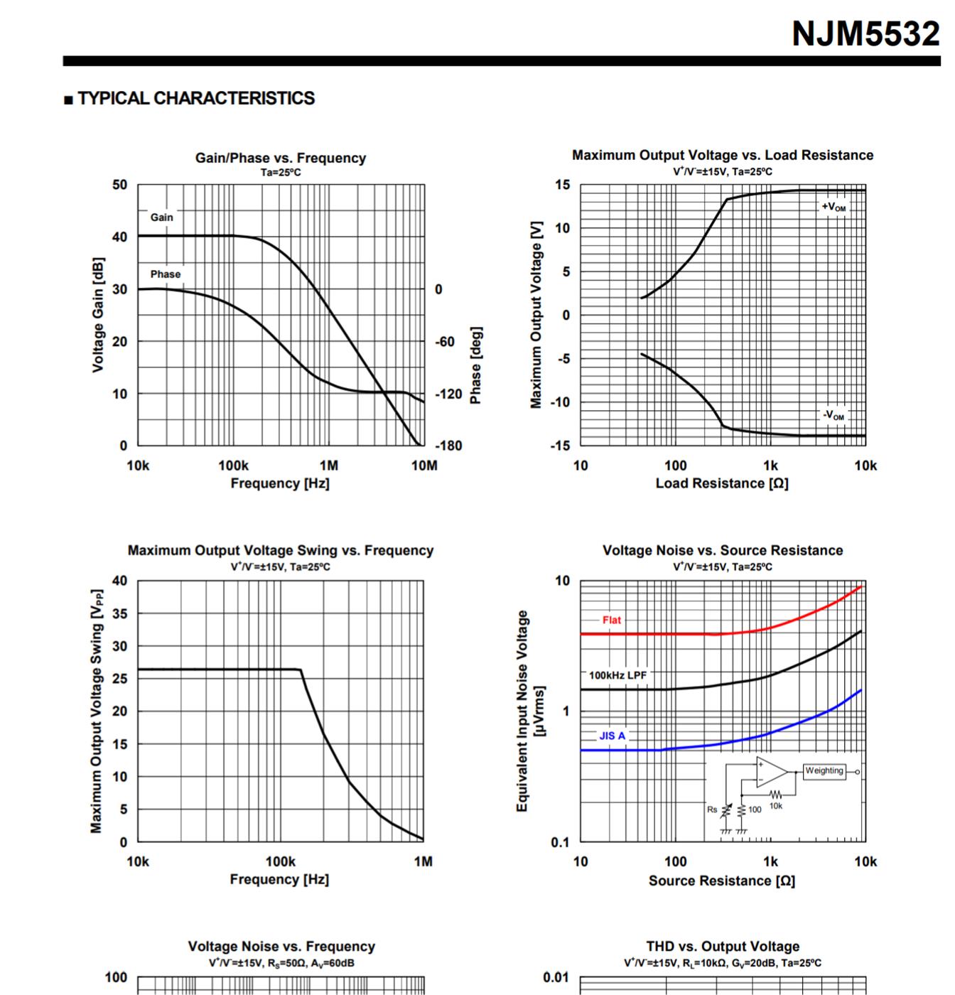

Probably not but from looking at the data sheet, its really quite adequate. OTOH, I'd love to compare its data sheet with what you consider a really good one. I know if I were designing for myself I would pay for a premium device; if I were designing for mass production perhaps not.
Data sheet referenced it as being a high performance version of 1458 op amp. Back in the 70's, 1458 was my bread and butter dual op amp for commodity audio apps. 40-50 years later should find much better devices!
I just have one picture from the data sheet that illuminates previous discussion
Upper left graph shows no significant phase shift until well past 20 khz
Upper right graph shows output limitations with loads under 300 ohms or so. How does this matter? Well cable looks like 100 ohms to the wavefront, which traverses it in a few microseconds, after which the driver sees the input impedance of the amp at the end of the cable. I don't think that is significant for audio. perhaps there could be distortion generated if the cable got long enough.
Lower left graph shows maximum output voltage swing vs frequency. It can swing rail to rail up to 100 khz. Perfectly adequate for audio. Only issue I would see is if the rails weren't far enough apart - i.e. the power supply voltages weren't high enough for the output swing needed.
I don't know enough to say anything about the noise graph but just below I see a teaser title of a graph I'm not showing - THD vs output swing but its a few hundredths of a percent for an audio signal.
Sounds pretty good to me. If you have 5532's in your equipment, I wouldn't worry about them.
