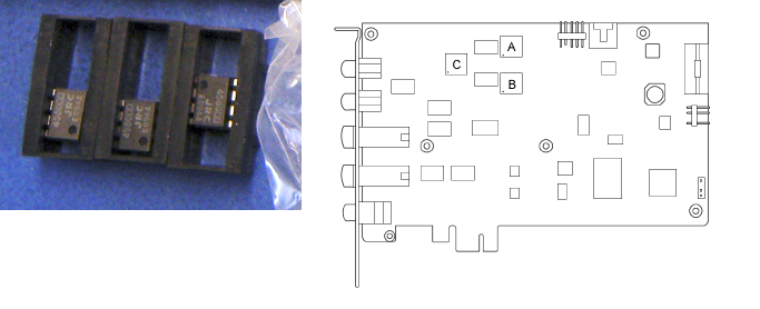

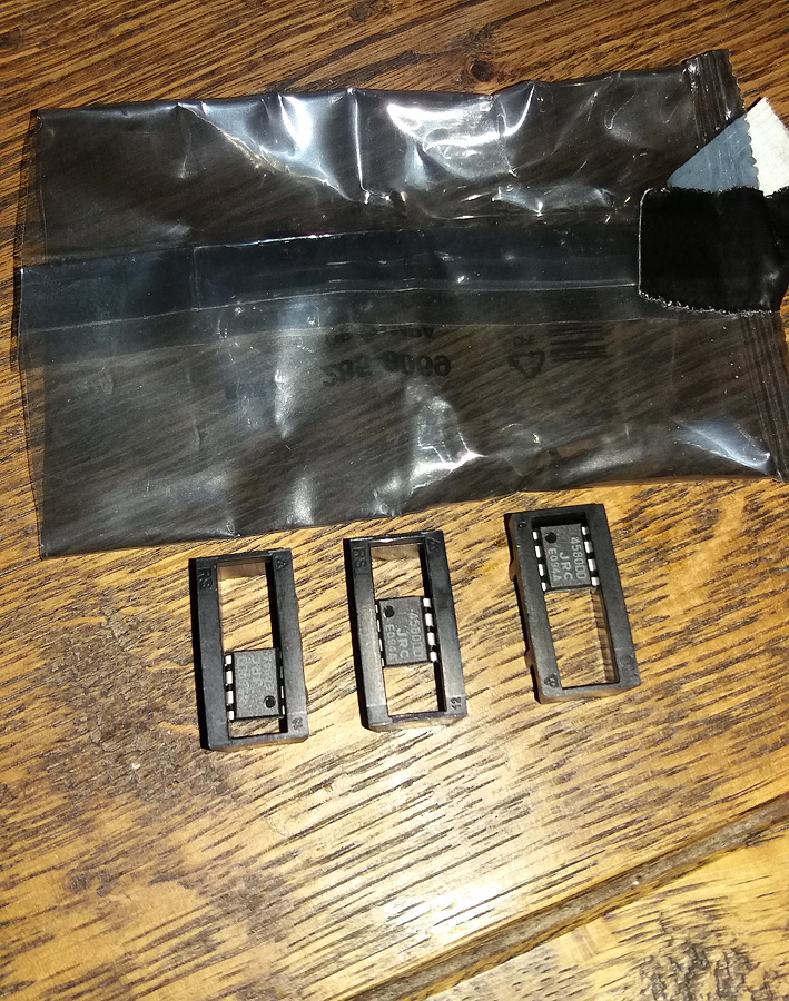

Tweak one is based come to think of i sent you a used ST card back in july 2016 where there was a antistatic plastic bag containing exactly below three opams for rolling test, look in your drawers somewhere : ) myself tryed roll two models of expensive MUSES opamps, then LM4562 in all three positions but tears was lacking then original NJM2114D for A/B positions and LM4562 at C position was better, then rolled one from plastic bag into C position and wau my glasses misted, using same in all positions of A/B/C fuses in my osciliscope blew up because tears jumped down on it, good tweak : ) afterwards rolled the nine ones on daughterboard for the other six channels. Remember worst thing was my mind had a hard time accept the race because it believed the expensive MUSES was probaly best or looking speed in datasheet for LM4562 looked to die for but scientific research showed they didn't tap any water. They ordinary non expensive JRC/NJM4580 sourced at RS components to get the real stuff, hope koldby can agree they are a ordinary non transperant tap water or tears like signature
if you find the time wesayso for rolling research try them hosed directly to Telos clone and via ATOM pre sprayer.

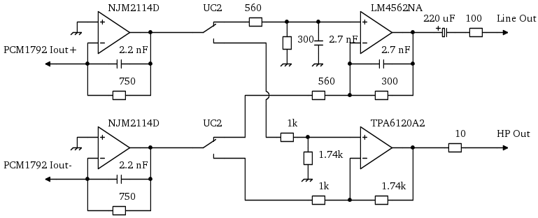

Second tweak to try is tap mains at ST cards HP out because its a lower 10Ω verse 100Ω for line out, but be carefull check for DC offset because that speedy monster of a TI composit CFA amp if remember correct is DC coupled as seen in below schematic, again if you find the time try tweak coupled directly to Telos clone and via ATOM pre.

Nice find that's them, suggest use the roll guide if you have it at HD else lookup ASUS website for "Xonar Essence STX OPamp swapping instruction" because it explain which positions is current to voltage converters and differential to single ended output buffer and the direction marks on socket that shall allign direction mark on chip. Operation is easy enough but can recommend take swapping bit serious and check two times those direction marks are lined up before remount the card.

You were certainly correct to do a blind test. Any engineer reading the data sheets for those two output devices couldn't help but believe they sound much better than commodity op amps or even high performance versions of them. They are so much better specified, many more charts to look at. The distortion characteristics are orders of magnitude better. and only a couple of bucks each! vs nickels and dimes for the commodity chips
No that was stock and really never touched or used more than say half a year or so, so predict it be a very good sparepart to have in reserve.
EDIT the one i rolled and sit here enjoy was STX II that relaesed the failed PCIe version of ST, STX II looks be a clone of ST even its daughter board have exactly same SKU number.

Cant know how JRC4580 rolling works for you other than learn signatures but as with HP-1/Atom tests one can never know and Jack was positive of datasheet coverage thanks, happy rolling
