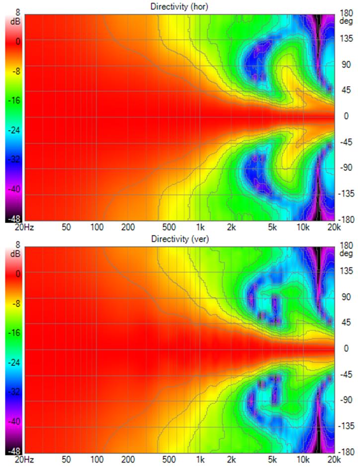

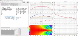

Her, BTW, is what I came up with for polars of a TC9 Tekton array with a central generic 3/4" tweeter
attachment.php
Horizontally, the array's response is narrow and gets broadened by the central tweeter above XO at 8 khz. Its also narrow vertically but at least its not lopsided 🙂
I know. I was lazy and used a tweeter I already had directivity for. Given the way the polars are synthesized, after vituix mirror equalization, all drivers with the same piston diameter will have the same polars. that is why I called it generic tweeter.
If I could trace the graph in the linked tweeter, I could have real directivity but that graph looked to dim to me for tracing. I would certainly use that tweeter if my goal was passive XO because its response is so smooth and flat on its own.

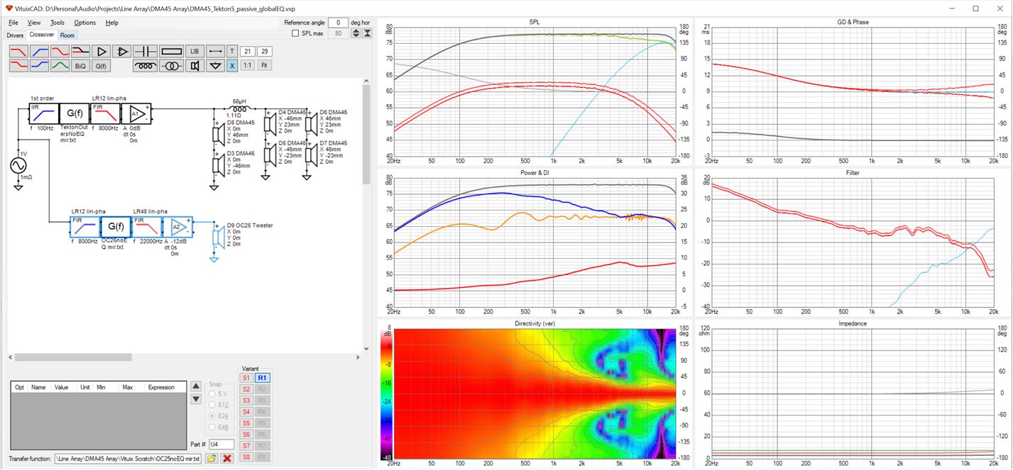

Is this a group of tweeters only? In a "Tekton like" grouping? The bottom end doesn't look like array directivity...
that was the standard tekton array of columns of 2:3:2 devices, In this case, all TC9sexcept for the central tweeter all at 84 mm spacing
attachment.php
room response curve is just wall reflections. there aren't any above 1 khz due to the directivity and 45 degree toe in.
Its not line array directivity at the low end, the array isn't long enough. You could make it longer and extend the vertical control lower ...

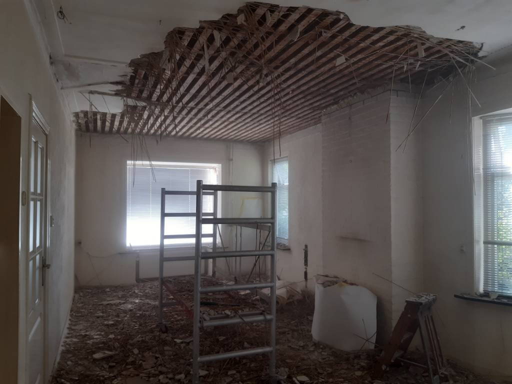

We are finally getting rid of that awful metal ceiling 🙂. Once this is all done I'll 'operate' on the arrays to include frequency dependent shading.
After that is done I'll start with building my 6 channel pré-amp. It will take me quite a while before its all finished. No telling what the outcome will be. 🙂 With this many changes I'll have to start all over again.
There's more to come, the windows will be replaced with glass having better insulation properties, making the space more quiet. Good for comfort and good for audio 😀.
Windows change will be a great change for sure.

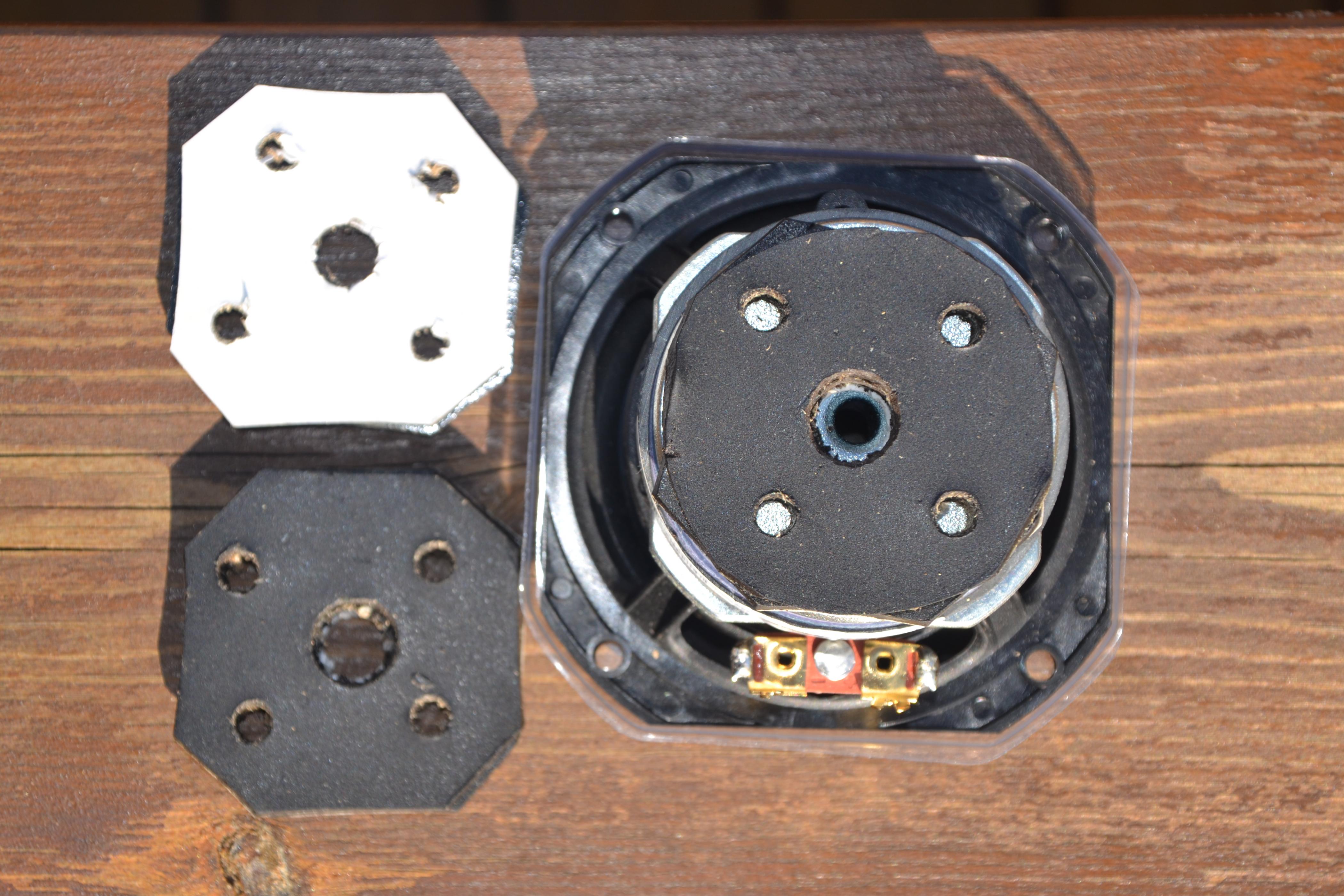

Hello !

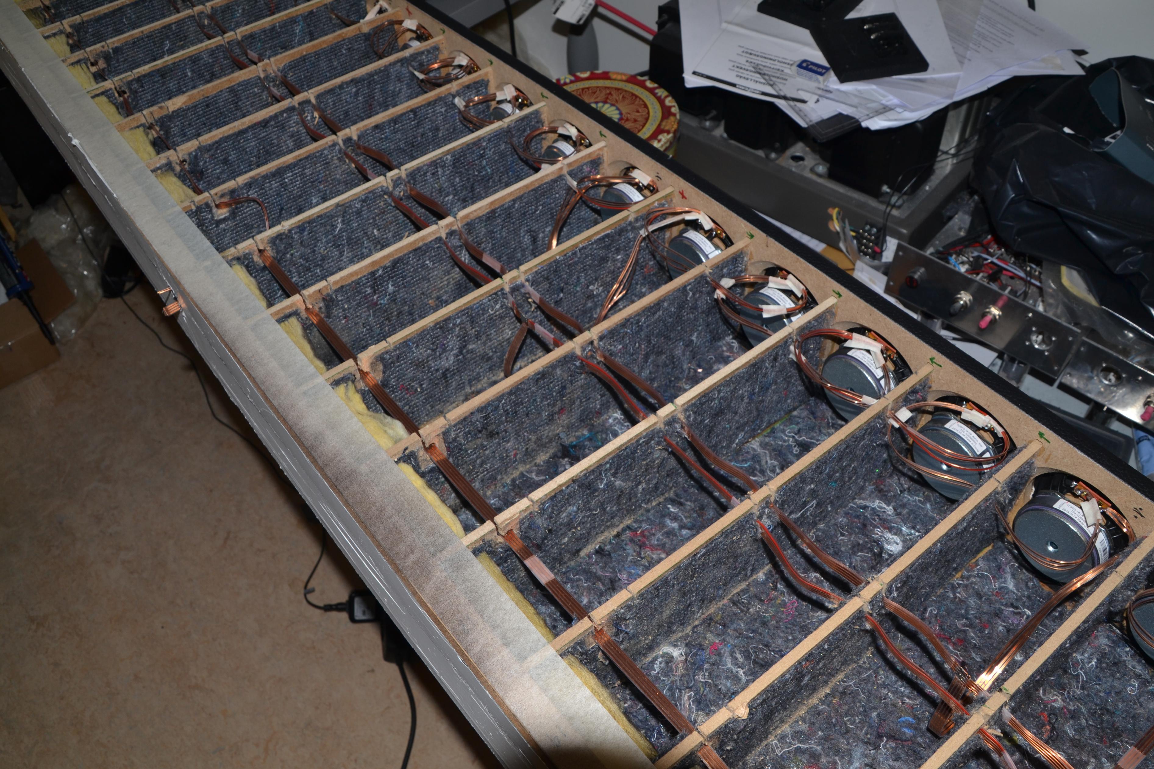

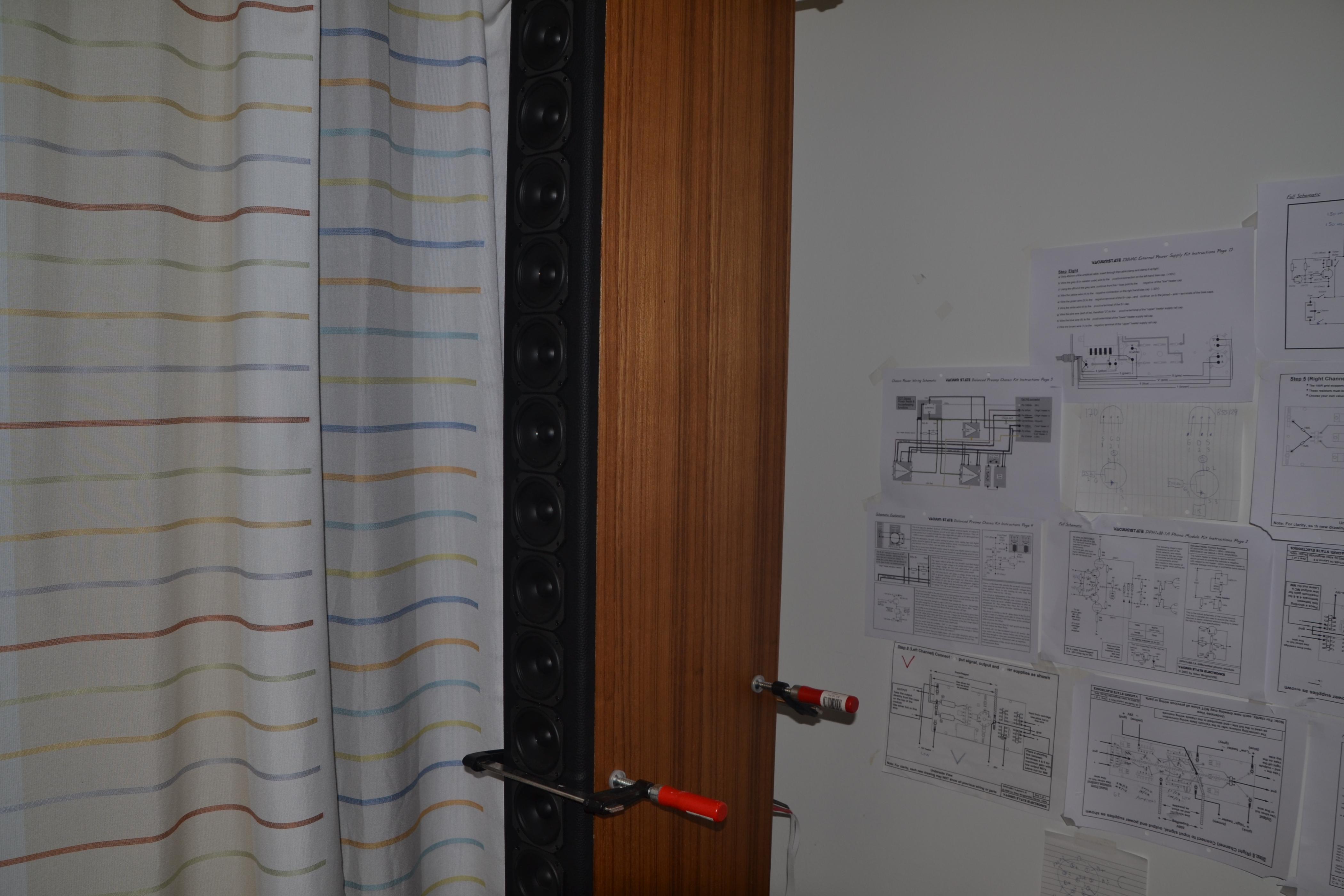

I have buildt a 2 x 25 pieces line source with the Tc 9FD 18-08 element.
I am playing with it and are pleaced with its performing so far. It is still in my smalwork room, and the sideplate is hold in place with fastening tools.
I wandering if some have tryed to have bitumen on the back side of the elements, or have any knowledge of what the effekt of it might be ?
The bitumen I have cut up, have glue on it, but to be sertain that they stikk for several years I have drilled 4 houls to fill with Tec-7.
