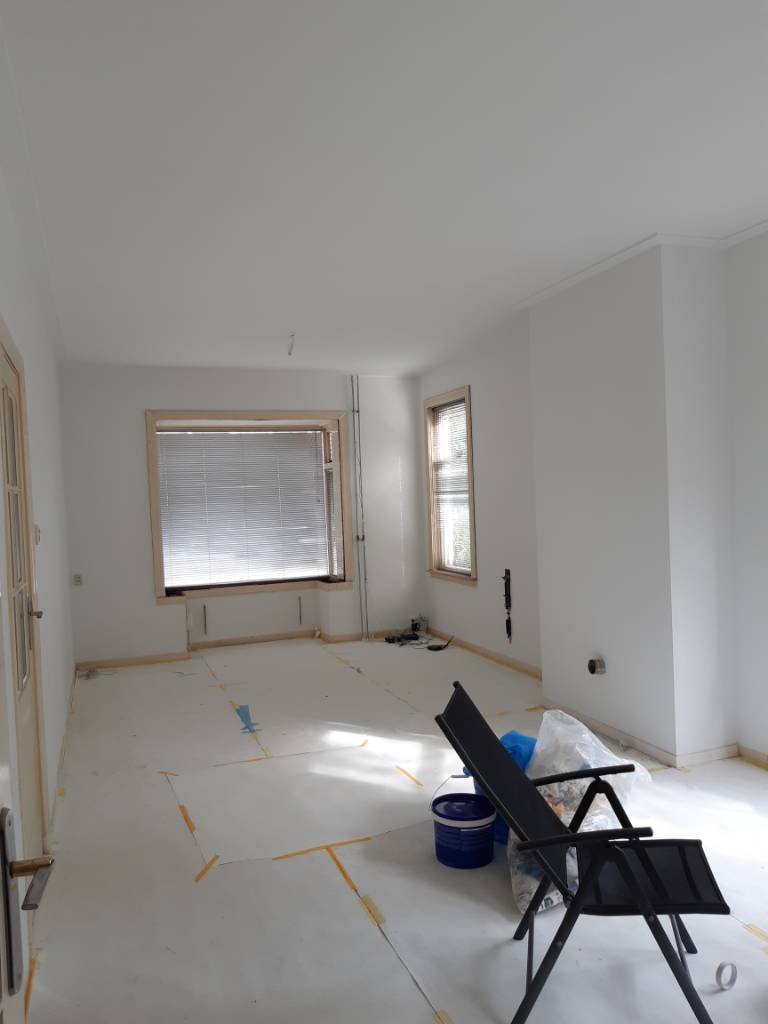

Even though we're building up again we still have a long way to go. After the walls an ceiling are all done we'll start restoring our window sills, trying to recapture the original look of the 20's build style.
I believe its going to look great but it takes up a lot of time.

Still lots to do to finish up, so no hurry yet. This is how it looks right now:20200827_170700.jpg
