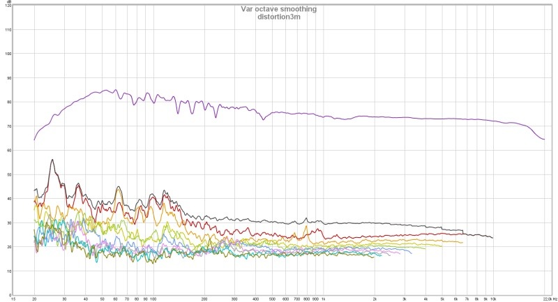

But I am just looking at the distortion curves as well as maxSPL, plus that issue with Cms (which is real)
Even with so many you just touch around 100dB at 40Hz maxSPL.

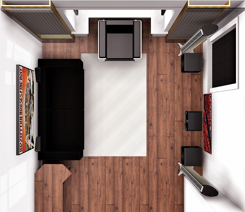

Usually I only change one thing at a time. Adding the filters and remodeling my home was one of the first times I deviated from that.
I get why perceval reacts the way he does, as we have been over this same routine more than once in this thread.
I get it that there are people that want PA levels. I want a reasonable level that I can sustain for hours on end without damage.
-- looking for an average of 85 to 87 dB, see further up --
I have tried the conventional crossover (at least twice). But one sub in one spot reacts to a room in a certain way. It won't have a flawless output at the listening spot plus it's direct environment. 2 Subs do better, if we use the strong points of both subs we can get some averaging going to smooth out the response.
Adding the 2 arrays goes one step further. But I only use them where they do get extra help from their specific spot inside the room. Lots of work, yes. But after all those years I do know what it can and can't do. Where they make the easy SPL levels.
100 dB at 40 Hz is the start, of 25 drivers added in a simple calculator. It isn't factoring in the corner placement and the fact that we've spread the source over a long thin line. So what we get at the listening position is more than that of a 10" woofer of similar size. As it is acting as a distributed source plus being a line source. So over a distance I get to keep more of that SPL level than I do of the single woofer, and a lot smoother output with less dips and/or peaks.
Sd = 36,3 cm2, 25x 36,3 = 907 cm2, but... only usable over 2.55mm x-max. X-mech will be 7 mm, but we need to obey the safety of x-max.

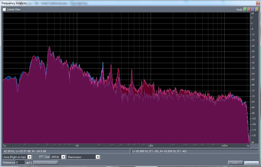

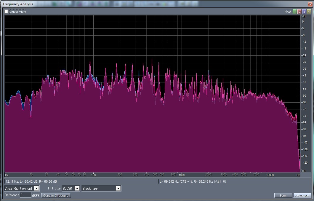

I'm looking for average playback of 85 to 87 dB. A Radioshack SPL meter never is far from the listening position. On top of that I'd like to sustain the dynamic range of music. We have 2 speakers and due to pretty much excellent summing I can get pretty close to my goal inside my room.
I think I have found 3 tracks I could not play at the mentioned average level. (JRiver is making sure each song is being played at similar SPL levels, despite it's dynamic range) 2 of them I forgot about (lack of interest), they may be in this thread somewhere. The one I do remember is a lullaby. to be more exact: "A Perfect Circle - Lullaby"
The pumping bass on that song is marvelous. I think most users have never heard that song in full, with speakers that have 'output' down to ~20 Hz.
I had to bypass JRiver's level feature for that song and adjust volume by hand. JRiver wants the whisper voice to be 85 dB on average. That will make the bass line go
above what I could handle. Dropping it about 5 dB I could still play the song. By memory the peak of the pumping bass is at ~25 Hz. With the Arrays sans sub, I used to add a (safety) first order crossover for movies.
Most songs I play fall between a 12 to 15 dB of dynamic range. I have some silly new stuff that has 6-7 dB of dynamic range as well, just to try it. But hardly any song really has the 20 dB of dynamic range that I want to keep for safety/sanity. I don't need to play louder that what I mention here. I'm not running a PA show, my room is
about 8 meter long, 4 meter wide and 3 meter high. (not large by any means, which helps) I'm using half of that room for the entertainment area.
With the sub-woofers added to the mix, I get what I need plus some decent head room. I can play Lullaby at the right level. It remains a cool track.

I figured I'd have to re-analyze the Lullaby song (again) to show how it deviates from most regular songs:
This is a 'chunk' of the middle part of the song being analyzed. What can be seen clearly is how 40 Hz dominates everything. it is way above mid frequency levels.
25 dB still is loud, trailing about 9-10 dB behind. Unless you have a system that is flat, by EQ or design, you haven't heard this song in it's full glory.
JRiver's analyzing gets into trouble and plays this song too loud for comfort and the bass was overpowering my arrays.
It isn't following the patterns of regular main stream songs... never do the mid frequencies come close to the bass parts.
If we take the live version of Hotel California off of Hell Freezes Over and we analyze the Bongo drums:
It shows a remarkable resemblance to the "Perfect Circle Lullaby" scan.
But if we get further into the song, with background and main vocals:
We see why JRiver has less problems analyzing this song. Even though that Bongo drum still hits hard, and never fails to impress listeners,

Distortion graph of array at 3 meter.
