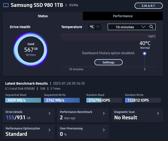

Due to the move to Windows 10 Pro, I figured to spend some time optimizing the PC.
Upgraded my old workhorse (HP Z440 with Xeon E5-1650v4) with a NVMEe M.2 disk as operating system disk.
These drives are very affordable right now, I got a Samsung 980 EVO, as the PRO version (which is quicker) runs at higher temperatures.
I needed a PCIe to NVMe adapter which is currently mounted between my graphics card and my 5.1 extension card of the Sonar Essence ST.
I figured I'd take the slower (and cheaper + cooler) 980 EVO to try this out. M.2 is supported on this workstation but not available native on-board.
I found a couple of posts online about adapter cards that were used successfully with my HP Z440 model and it all worked out well.
Good read/write speeds all around, quicker than the Samsung 256 GB 950 PRO it replaced. Got some more memory on it's way,
updating it to 64 GB, not for the total amount of memory, but because the CPU actually gets access to 4 slots at the same time.
Currently I have 2x 16 GB, upgrading that to 4x 16 GB to make good use of that feature.
I'm planning to stick with this workhorse for a few more years, so an 'in-between' tune-up seems worth it.

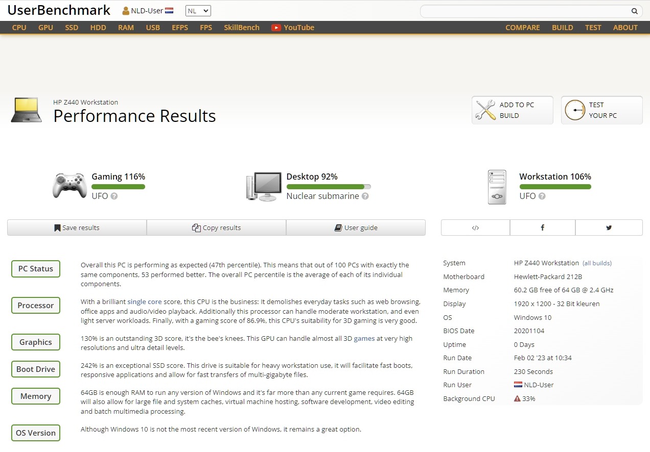

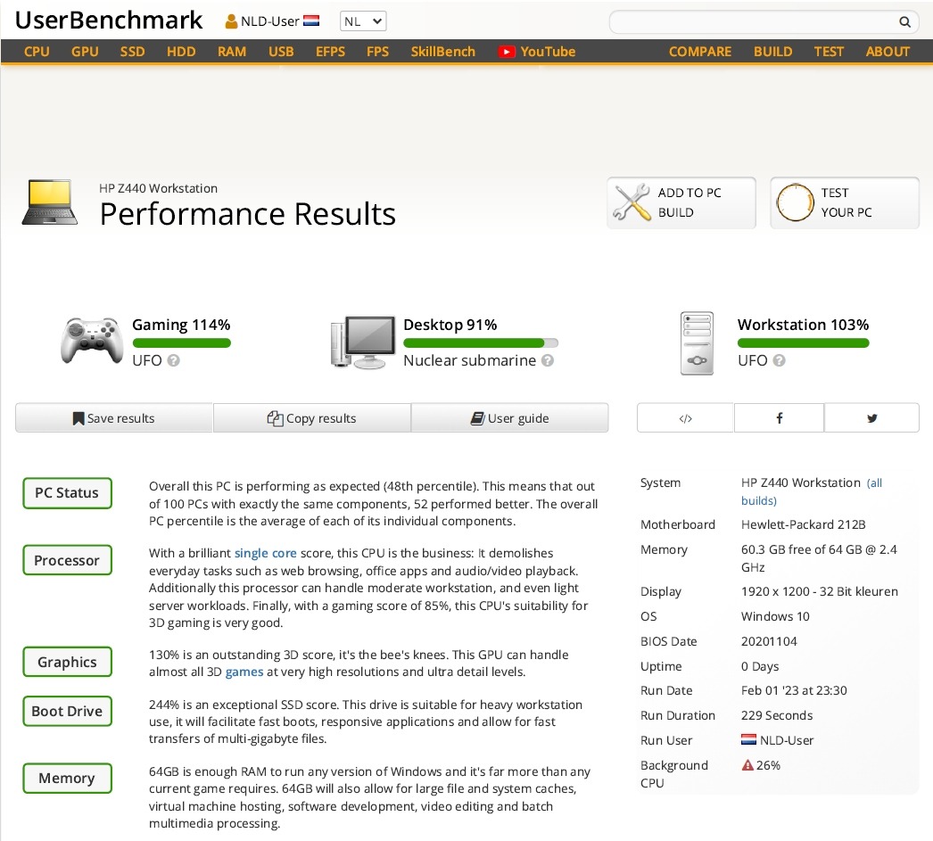

A quick check shows everything in working order
The RAM update made a leap from a 70% score to 105% as the processor can access 4 lanes simultaneously.
The hard drive went from 100% (Samsung 850 Pro SATA model) up to 246% (Samsung NVMe M.2 980 Evo) and even up to 250% if I set it to optimized for speed. I'm sure I could squeeze out even more performance if I really tried, but this will do nicely. (almost all of it is the Graphics card in this particular test).
I've looked at the better performing HP Z440's, they were running up to RTX 3090 cards (lol). I have a 3060 TI which is good value for money for what I (want to) do. Which is run 3D design programs like Autodesk Inventor and Fusion 360, a little Home Theater use (MadVR), some Photoshop etc.
What can I say, I am a tweaker... I just had to try and up the workstation performance... As that is what I use.
This should conclude the Workstation Upgrade. I'm still leaving some points on the table, as this isn't the quickest graphics driver but the Processor, NVMe M.2 disk and memory are doing what they should do.
