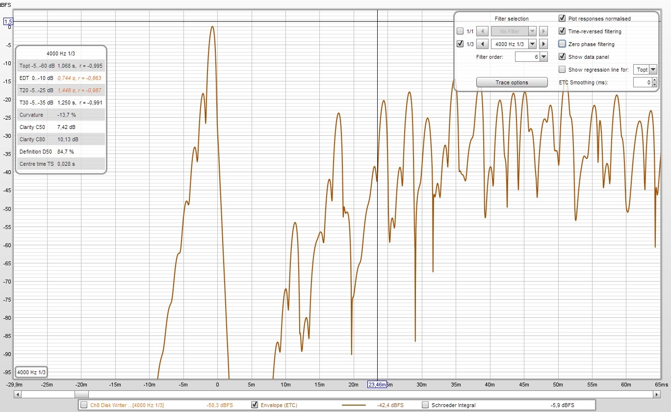

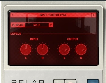

The Relab LX480 reverb in main input mode:
And it's IR when recorded to disk:

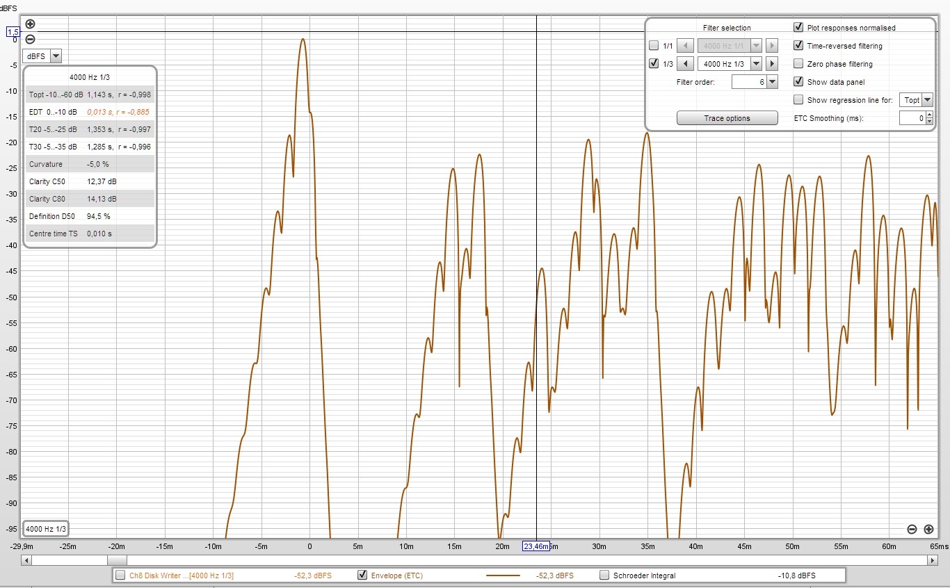

And in contrast the results after setting it to digital input:
it's matching IR:
I've done this particular comparison with the Relab LX480 Complete, its GUI is a bit quicker to respond than the newest v4 version (got that hint from the users @ Gearspace).
Lexicon Random Hall is as clean as Relab with the Digital setting:
A reverb like Valhalla Vintage Reverb looks like that top image (or has an even higher noise floor) and has no additional settings to clean it up. I prefer to use the cleaner versions. The Relab plugin has many additional settings that emulate the old Lexicon 480L hardware input/output sounds.

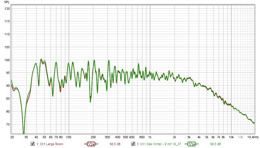

Relab wasn't kidding then they mentioned the sample accuracy of their product. I came across this page yesterday: https://www.housecallfm.com/download-gns-personal-lexicon-480l
It features a library of actual Lexicon 480L IR responses. So I figured to check those results with a run of the Relab LX480 VST plugin saved to disk:
As this was a separate device from the one Relab used to model their plugin, the accuracy is impressive.
I have to add a note to the comparison above: the IR file from that website I linked to was at sample rate 44100. My comparison only lined up when I was having JRiver run its output at 48000 or 96000 sample rate. It made me check and yes, there are more differences to be spotted even between running at 88200 and 96000 sample rate.

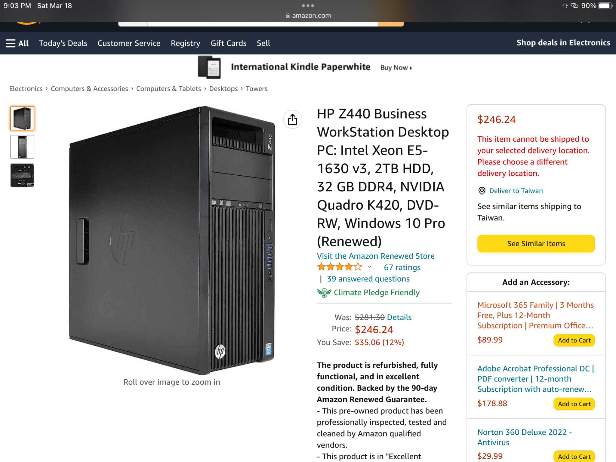

Crazy how things get down fast. $246 is not much money for a beast like that!
not as much ram as yours, and I’m not sure which video card you have, but that’s the same cpu, right?
not bad with a cache of 10Mb.
being a Mac guy, I would love to see the comparison with a M1 cpu.
Trouble is that so many apps you use are PC only. Hard to make a fair comparison. Like there’s no MadVR for Mac.

That's the one, the HP Z440 workhorse. I bought it in 2019 as an overyear product at a nice discount with all bells and whistles except the graphics card.
I have the 1650 v4, 6 core, 12 threads CPU with a nice single core speed. (I believe an I7 6850k would fit too using non ECC memory)
These old workhorses are fun though, they are build like servers, using ECC memory from servers and have internal (optional) memory cooling etc.
The graphics card I use is an Inno3d 3070 TI. A very sleek card, 2 slots heigh that easily fits this slim case. I even glanced at the 4070 TI that comes in a similar package. But its price is way up into the stratosphere.
With a simple (StarTech) PCIe adapter I use an NVME drive for O.S. The original HP card + drive was way more expensive, but those prices have dropped down too.
Lastly a 2 TB + a 4 TB (sata) SSD for data/movies etc. separate NAS for backup.
In all honesty, these days an i5 10400f build (or similar) would make more sense, but I wanted/needed the PCI slot for my Asus ST and in 2019 those options were getting limited.
I meant to say something like the i5 12400f, in comparison, my Xeon would be the same age as the 6th generation.In all honesty, these days an i510400fbuild (or similar) would make more sense, but I wanted/needed the PCI slot for my Asus ST and in 2019 those options were getting limited
In that regard it still keeps up quite nicely (would be about as fast as the 10400f I mentioned by mistake).

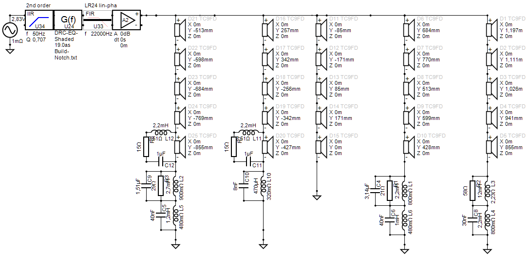

ah... yes. Forgot about that.5x 8 ohm in series woofer.
For the purposes of baffle diffraction, does each driver's enclosure vibrate separately, or do you calculate it all together as a single, long tower?
The baffle is made of 2 separate pieces of aluminium. One inner baffle, where all drivers are bolted onto rigidly. And an outer piece,
that bolts into the enclosure. Between both plates of aluminium there is a layer of butylrope. Between the inner baffle and the enclosure a layer of mass loaded vinyl and a layer of neoprene. That inner baffle is kind of 'floating' between the enclosure and outer (beauty) baffle. But all drivers are bolted to it rigidly.
Does that answer your question?
