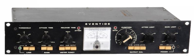

Has anyone heard of the Eventide Omnipressor? I'm curious because it could make for an interesting compressor discussion but I'm not sure what Forum it belongs in. I reverse engineered Walter Becker's personal unit and built my own version and demonstrated it for one of Walter/Donald's producer friends and he liked it better than Walters. It was fun to take a deep dive into such a weird compressor.
This also gets into a discussion about VCAs and I find that pretty interesting too.
I'd be interested. I happen to like the effect and especially how the envelope time constants seems to influence what I do when playing through one. As far as VCA's go, I'm afraid I cant be much help beyond a Vactrol or CA3080 trans amp chip. I also have some GE H11F1 FET output optocouplers, which I havent attempted to use for controlled attenuation yet. Because in my application, the signal voltages are just too high for its 30V kapow-point.

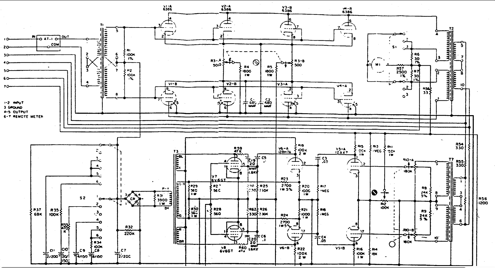

You mentioned the Fairchild compressor, this one?
An amusing bit of circuit, using 6V6s to drive the DC envelope part, that in turn changes the gain of the 6386 tube string. I'm pretty sure those tubes wouldnt work arranged single ended which is part of the reason for all the transformers, which I take it arent just for balanced line compatibility. I read that such a solid, hard drive to the rectifier / filter is what gave it a lightning fast response.

I'll be waiting to hear that story.This gets into Rein Narma and the history of the Fairchild compressor

Is this one a feed forward sidechain ( or a mix of forward/backward)? I suppose it's in the sidechain the 'character' of the unit is. From my experience with solidstate it's most often the case ( dbx165, GML, SSL 4000 mixbus variants,...).

The schematic linked is from 660, the mono version of 670. There is differences between both units : biasing shem of 6386 is different, transformers used too as 670 allowed for MS matrixing through them. There is a difference in overall gain of circuits too, 660 having more (16db vs 7db iirc).
Their targeted use was different too as 660 was more seen as an instrument compressor/limiter, 670 was most often used in front of either transmitters ( radio station) or cuting machine ( for vinyl production).
You are right variable mu design ( tube comp) are 99% of time push pull circuits. It's relative to 'thump' happening, it helps reducing this. I think i remember some people experimented with non push pull config without this much success back in the days at prodigy-pro.com's forum.
You are right about the big sidechain amplifier: 30w rms tube amp needed for such time constant as the one used in 670.
It's needed as the limiter target was to protect the cuting head ( or transmitter amp) from transients so it had to be very fast attack while retaining enough energy to allow for 5sec/20sec release time from a very short peak all this driving 8 grids in //.
Funny you see it as a guitar amp though, the audio part of the circuit is way simpler as a single stage common grounded cathode amplifier ( // 6386 makes for one single stage). The genius of Narma was into the sidechain design imho, as it offered a way to have treshold and ratio availlable ( dc threshold) and satisfied the technical requirements regarding envelope time ( vari mu are most often way slower...).
Psu is often overlooked for this units too. It should'nt: Narma implemented a fully tube regulated psu on 670. It's part of the sound. Funny enough you'll find it implemented in most researched varimu eg from Urei 17X familiy where a (crude) shunt regulator is used to power the gain reduction cell ( an Oa3 which feeds 6bc8)...

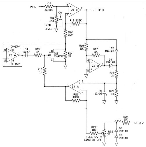

This limiter potentially causes some serious distortion unless... it's set up to never hang out between limiting or not. I'm guessing that RANE designed this circuit to be completely off until it's time to prevent clipping. That is how you get away with such a simple circuit that would not work so well if it were trying to be a Fairchild which is also a feedback limiter but has a wide soft dynamic range that an FET could never handle. The claim to be the most powerful 100 Watt amplfier is cute and true. If you get rid of that pesky headroom problem, the average power goes WAY up. That's another rabbit hole.
I will have a closer look at the RANE circuit and it may prove interesting.

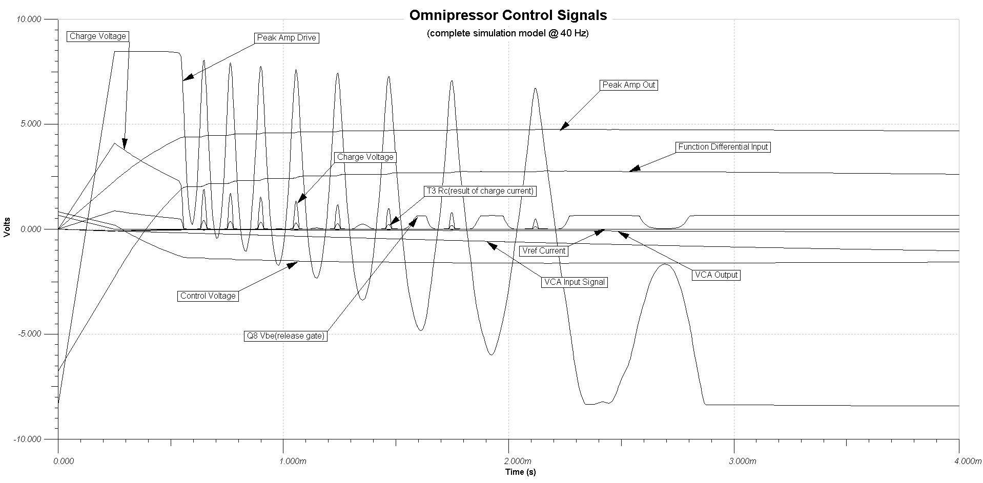

The example below shows the Omnipressor upon attack of a 40 Hz sine wave while in compression mode. It's a great thing to study being such a wild and wooly compressor. This is a also a good exampe of all of the crazy signals going on in an Omnipressor to get the job done. This isn't meaningfull without some schematics and explanation of course and I will get into all of that as I find time.

Giving that Rane circuit a bit more thought, I'm thinking that it's as obvious as it looks. Z2 is simply gives a buffered AC coupled positive feedback that shortens the attack time. I will verify and quantify this with a simulation, but this is what it looks like. There's nothing like seeing the timing plotted an we shall see.

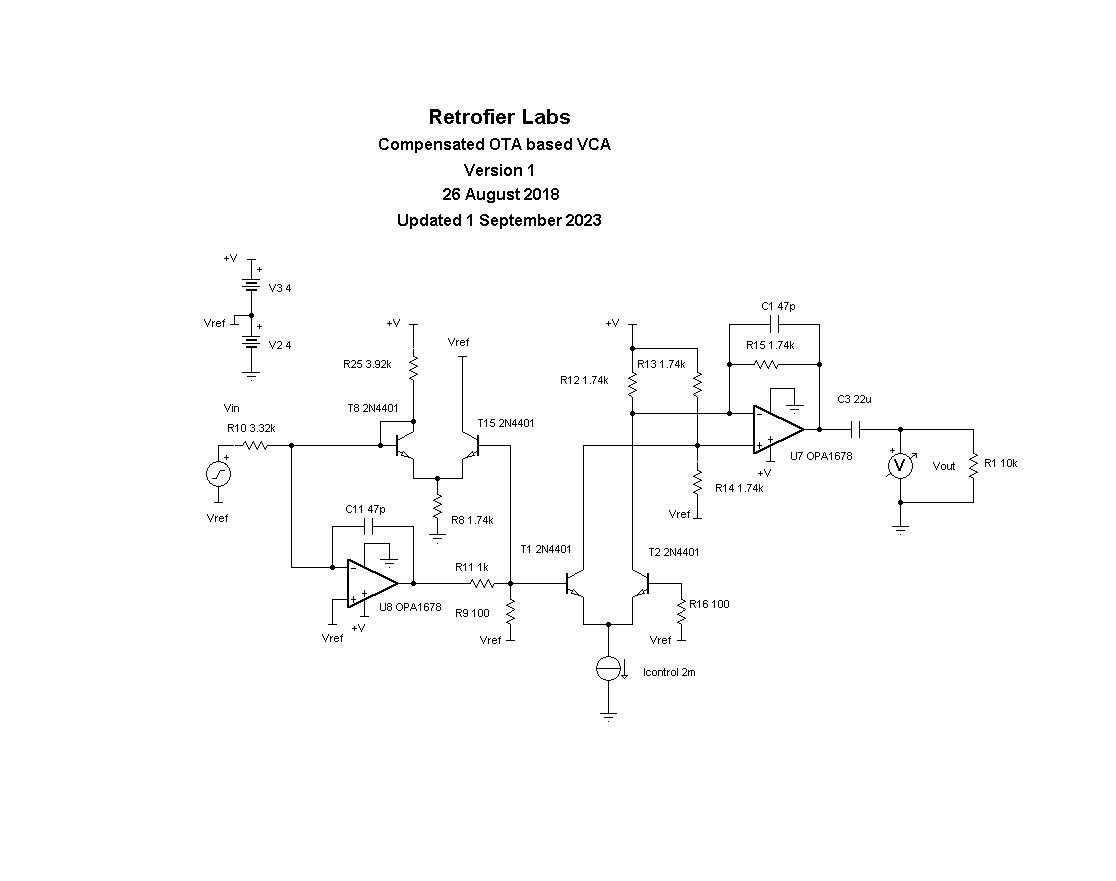

Here's the compensated OTA based VCA that I'm enjoying these days for guitar related thingies. It's a completely public domain circuit that doesn't get the attention that it deserves in my opinion. I have some compressors based on this concept that are pretty mind boggling when all of the other pieces are in place.
The first thing to consider while trying to understand circuits like this is that there is no hfe. Bipolar transistors do not have a "current gain". It's just a leakage and should not even appear in most equations. I have seen some people that I respect a great deal being completely mislead as to the operation of some circuits by falling for the hfe myth. In fact I have seen evidence of this confusion in countless commercial schematics dating from the 1950s to present. It's become something of a hobby to correct or find better approaches to these wayward circuits. It's fun. It's also fun to see how well some apparently bad circuits can work. You just cannot know it all.
This nifty VCA is in my opinion what 3080s should be replaced with. It's also a perfect example of a 60 year or thereabouts old circuit that collects dust becuase its performance depends on the transistor quality and thermal coupling. These problems are solved by several dual surface mount devices that now can be had at very low cost. The Blackmer VCA is the same way. By using modern dual transistors and op-amps, very small DBX style VCAs can be built and one example that I built used a mere $0.50 in parts at quantity. It's worth diging up circits that had restrictions in the past but no longer do.
The magic with this VCA is that the very fundamental OTA is fed by a circuit that produces the opposite distortion and it cancels. This is possible because BJTs have very reliable characteristics as described by the Ebers-Moll equation and modern transistors obey it quite well. I mostly use this for guitar related work so 1% resistors do the job but things can be optimised better for a Hi Fi version although this isn't the approach for that in many cases. Mind you the distortion is less than most tube power amps so it is pretty useful. I have had this simple version running 0.1% at full output and only using the 8 Volt power supply shown. That comes from my guitar circuits that use a single 8 Volt supply to do some pretty remarkable things and sometimes with a 9 Volt battery which I don't like and discourage using but... the guitar world has LOTS of bad habbits and backward conventions etc. Another rabbit hole.
The control current source is what modulates this circuit and it's perfectly linear. This means that it does work predictably for feed forward compressors which is rarely done with OTAs which are considered obsolete by most. But are they obsolete just because 3080s are not so good and out of production?
It should also be noted here that this thing overloads in an accurate hyperbolic tangent fasion. This means that it very closely approximates a push-pull tube circuit and will never let the op-amps clip if set up properly. Very nifty stuff.

Omnipressor got a dual sidechain? A limiter and a comp that's it?
Your compensated OTA look nice. Your description of the inner circuit seems great. I don't totally grasp it atm, i will study furthermore. Thank you.
3080 are a lost for sure but we still have access to 13600/13700. They are not the same of course and might not been as good, but in synth vircuit i used them they are ok.
I think you are right about Z2, it's a buffer to fasten attack time /isolate jfet. Instruments limiters are often a bit weird wrt 'standard' circuit, but their function is a bit different too. As you pointed they are here to make the amps seems 'louder', it's not a bad thing if they implement a kind of soft distortion in them too.

I stumbled upon the answer to my own Z2 A function question, found in one of Rod Elliott's excellent articles at https://sound-au.com/articles/vca-techniques.html
"A JFET used as a 'variable resistance' follows a square-law, and introduces a large second harmonic component - typically up to 25% THD with 50mV on the drain and at 6dB attenuation. To counteract this, it is essential that part of the signal on the drain is applied to the gate to cancel second harmonic distortion. The gate should have exactly half the signal that appears on the drain for optimum distortion cancellation."
So Z2 A was placed in that circuit for a very specific reason...
A non inverting amplfier would be needed in that case. The buffer in the RANE circuit causes positive feedback that would do the opposite. It would seem that Rane does not intend for this to be a compressor but rather a fast brick wall limiter and Z2 speeds up the attack. This is what I'm seeing at this point but I haven't taken a deep dive and drawn a simulation model of it yet. I could be missing something.
What Rod is describing is what you see in some of the old FET compressors like the 1176. I haven't looked at those schematics for a while, but I do remember seeing the technique somehwere. And indeed FETs do not have predicable parameters and need to be corrected somehow. They often have trim pots just to compensate for the difference between one specimen and another. FETs are interesting devices but in the end rather crude in some ways.
Another important point here is that the distortion mentioned is the control voltage, not the audio path. And that wayward control voltage is why this type of FET technique is only seen in feedback compressors that compensate for the control voltage problems to a degree. It has been argued that the shunt feedback from the gate to the drain doesn't really give a very useful effect where a feedback compressor is involved. I would have to carefully quantify this to have my own opinons here.

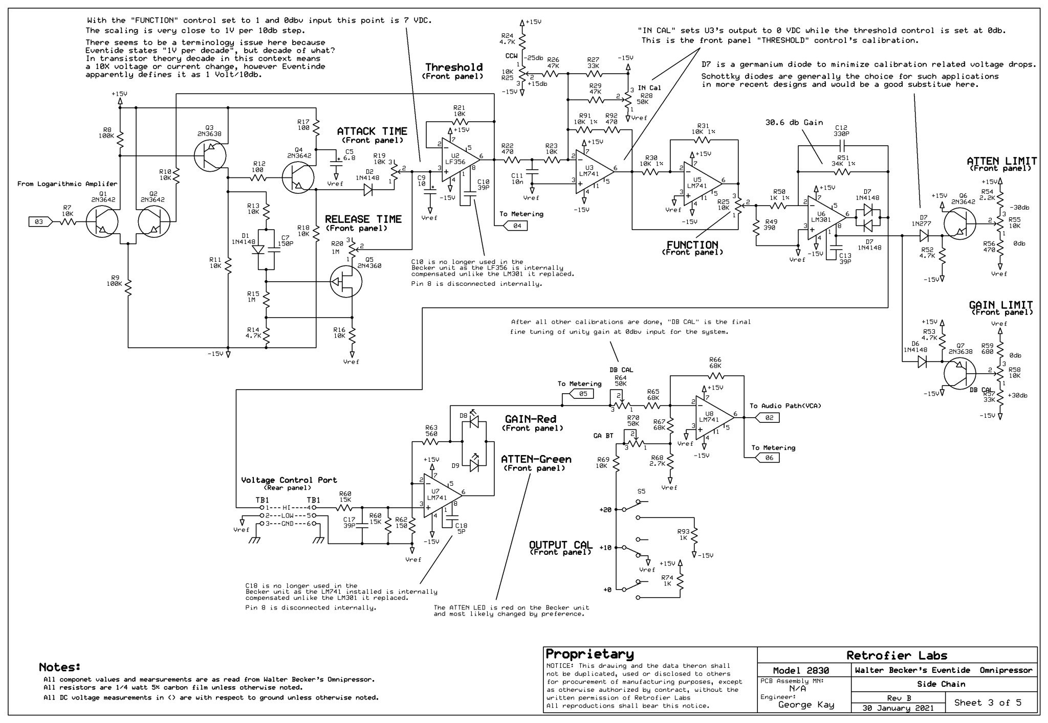

The Omnipressor has a single side chain with a bipolar control voltage. This is where the Blackmer VCA that's referenced to 0 db but can amplify or attenuate from there is key. What you get then is a single control that sweeps from compression to expansion. The rotation of the control then adjusts the ratio in either direction. And yes indeed it can whip up some crazy artifacts and wild behavior but that's the point. It's an artistic tool really. That said, the normal compression range is very nice. I prefer feedback compressors most of the time, but this feed-forward no doubt works well an was fun to use for a while.

Here's the side chain less the RMS detector that's on the previous page.

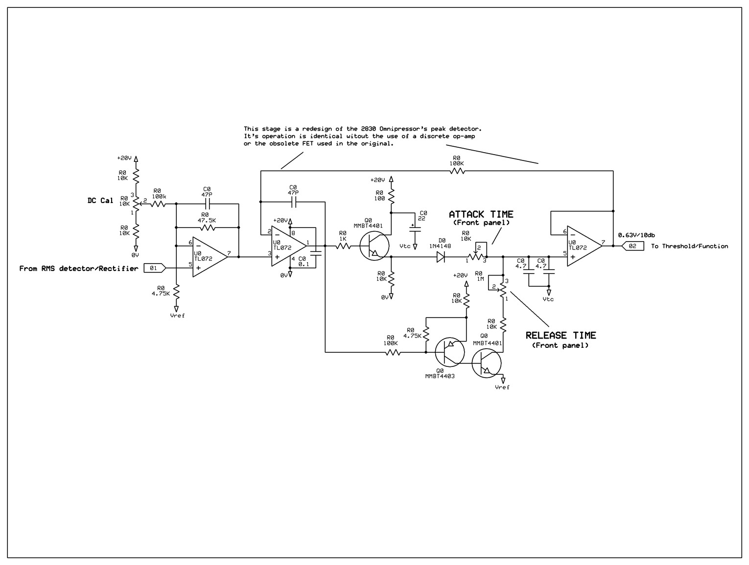

That's fairly easy to see in the schematic, with the op-amp arrangement around the control labeled "FUNCTION", which I assume is that single control.What you get then is a single control that sweeps from compression to expansion.
The envelope generator circuit is harder for me to follow. OK, signal comes out Q4 emitter, though D2, R19 - the attack control - and charges C9, buffered by U2. Simple enough. But then the release time seems to be gated by Q5 in the path of R20, such that only when input signal goes away, is "release" of the charge on C9 allowed. Why so elaborate?
What's the compression advantage of using that gating FET, versus say, a just a sink diode to Vref? The release control is 1M - much larger and of course I get why - versus 10K for the attack control. Is having say, a 500K across the cap while charging it though, say, 5K that bad? It'd be a bit of a voltage divider of course, but ??
I thought at first look Q5 was a constant current sink, so the cap discharges linearly, but now I see its a signal driven gate.
Then the DC envelope out from the U2 cap buffer feeds back to the transistor Q2, the other half of the - I assume - audio signal input LTP - and I just close the laptop screen at that point; completely lost now as to "How It Works". I could think of the gated release discharge, but that DC feedback has me well into "Bill Murray throwing golf club meme" territory.
Anyway - I'm particularly interested in the VCA control voltage deriving circuit. My latest attempt at one is fail; attack too slow, signal feeds through full blast before it get around to drive the VCA to attenuate. I'd be better off Fairchild style; a bridge rectifier, no attack resistor at all and 2uf // 200k.
The Omnipressor gates the release for two reasons. First it simply speeds up the attack time because the realease load on the timing capacitor C9 is completely removed during attack. The really interesting part however is that it allows slow attack while having fast release. The attack can be slower than the release and that's where some of the Omnipressor's crazy settings come from. I have seen some pro guitarists get interesting effects this way but I never worked with it long enough to get good at it. One of the things this does is allow volume swells that sound very volume pedal like.
And yes the Function control is a very simple sweep through the polarity and a cool trick really. The limit controls are also very useful as you can hold back the extremes and I found myself using them extensively to keep things under control.
This is my version of the timing circuits. It uses a single 20 Volt supply and that's why you see Vref and Vtc. Just treat these as the ground in a dual supply. In my circuit they come form reference generators. I'm reviewing all of this myself since I haven't seen it since 2021. It's interesting.
The dual 4.7 µF capacitors are SMD ceramics. There's two for component commonality. This could be a single 10 µF. I found 9.4 µF 5% to be just fine.
This also helps to clarify the original ciruit's use of a discrete op-amp and if I had finished this schematic and numbered the op-amps I could be more specific. Apparently I was in a hurry at the time to get on with the next project.
I'm working on a tube guitar amp and would like to incorporate compression into the design. I started out with "feed-forward", where I take the control envelope right off the incoming guitar signal, then apply it to Vactrols to turn down the output stage volume. It sorta worked.jjasniew, are you trying to build a feedback or feed-forward compressor?
Then after seeing the Fairchild schematic again, I tapped off an independent 70V output winding of the amplifier OPT, run through a full wave bridge, then a cap with a bleed resistor. I moved the Vactrols to the input stage of the amp (reason being the signal is so much less amplitude there) So now it's a feed-back. It sorta works too.
I havent yet got the effect amount dialed in using a panel control. The post volume of course now effects the amount of compression, whereas with the feed-forward only the guitar volume did that. Now when using a signal generator as input, I can crank up the post and watch the signals coming out the input tube diminish in amplitude, then come back up after I quickly close the post volume - in time with the RC time constant, so I know its "working". Unsure which way to go ultimately.
So the amplifier is a fully differential design, with the input tube doing phase split via a 12AX7 LTP arrangement using a current sink on the tubes cathodes. Everything is double from there through the output tubes; two sections of a 12AX7 as a "cold clipper", two 12BH7 driver triodes. Feedback from the OPT secondary is differential too, as I was lucky to get a 16 Ohm output tap.
The two Vactrols have their LED drivers in series and basically just stomp the output of the input phase splitter, after the decoupling caps, to ground. They are in basically parallel with the 250K "pre" volume control - a dual pot whose wipers go to the cold clipper stage.
When I removed the Vactrols from the output stage, I somehow reversed the signal phases so my feedback wasnt negative anymore. Squeel, squeel at full volume when before it was just fine. I thought for sure it had something to do with the Vactrols now being at the front of a very high gain circuit - and driven by that 70V winding. I moved circuits physically around in the chassis, grounded ends of floating circuits, shorted my unregulated (-) supply to ground for 20 minutes before finally figuring that one out and correcting it.
Ultimately, I'd like to get an effect similar to what the Rane does; just be louder longer by sustaining the H*** out of the guitar. I realize I could just buy a compressor and put that between the guitar and amp, but what fun is that?
I was going to say this, I've seen the same thing with the two high-value resistors to the gate for a FET attenuator in The Art of Electronics. I have a suspicion the Z2A voltage follower is overkill. It would be interesting to try the circuit with and without it to see how much difference there is.I stumbled upon the answer to my own Z2 A function question, found in one of Rod Elliott's excellent articles at https://sound-au.com/articles/vca-techniques.html
ETA: I read through Elliot's page and I can see where the buffer prevents control voltage feedthrough, among other things.
