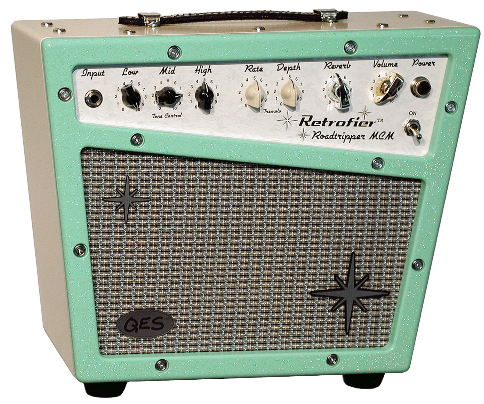

I can tell you that my analog tube emulations are rocking my world. I developed a pedal based on my needs, not the market it ended up in, and it allows me to ride the dynamics of what I'm now thinking is better than a tube amp and certainly better than anything DSP I have played through which is most of it. My reference for that is Kemper but I don't find it very good and don't waste time on DSP or real tubes. I have no use for them.
But getting back to the concept of the influence of gear, our plan last night was to rehearse just a few songs to ease back into playing and see how much work we have ahead of us to get polished again. We ended up playing 25 songs and performed some better than ever. We were playing to the gear and better than I could have imagined.
The PA in my Lab/Studio is a Pioneer SX-580 with a couple of nice Pyle bookshelf speakers fed by a very modest Alesis MultiMix4 mixer that my circuits feed into. The combo sounds like a very produced performance in the room that isn't too loud or soft.
For these rehearsals the Pioneer can't handle the bass guitar and so it went through my guitar amp that I can show you because it's not on the market. The one pictured is a different color, but otherwise the same. My personal one is the only one we have now. The amp did a fine job putting the bass in the room through it's modest 8 inch Jensen and we had quite the good time playing. This amp is very unique and worthy if it's own thread at some point.
Now I'm very fired up about getting my latest compressor circuits going to complete a suitcase system I have in mind. It will feed into my rack mount power amp and Hi Fi tower speakers that we have been gigging with for years. Conventional powered PA speakers are generally horrible and have always used a more Hi Fi approached for my performances.
