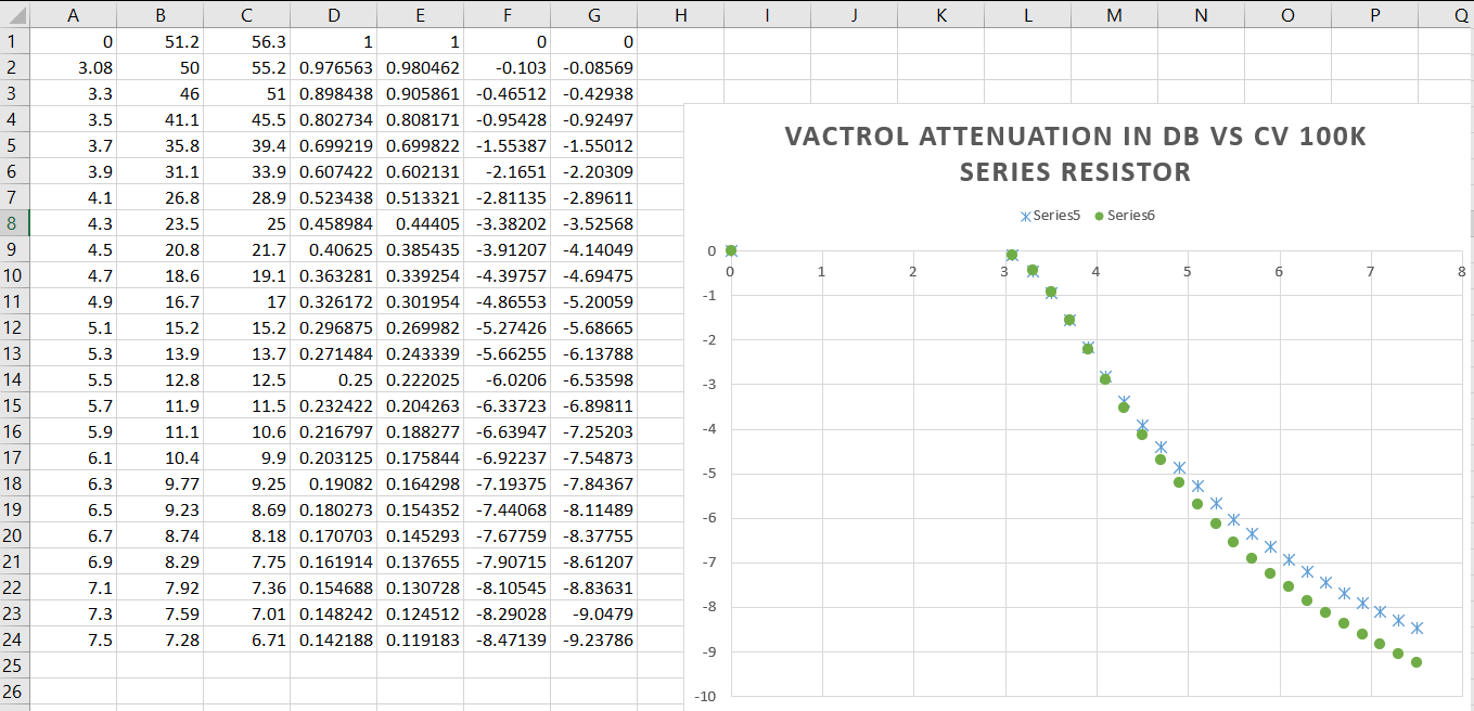

So I did some measurements on my tube amp with the Vactrol attenuators, to see what the raw CV does in terms of their response. There are two, one for each of a ~50V RMS (+) and (-) sinewave signal. I have their illuminating LEDs connected in series, current limited by a 100k resistor. These are in parallel with the input to a 250K pot, which is the post volume. I'll guess ~50K as the source impedance...
I tried to plot db in attenuation versus control voltage; thanks to my wife for the excel formulas that would take me all day otherwise. The Vactrols remain virtually open circuit until CV reached about 3.1 and I'm 6 db down by the time CV has increased to about 5.5V . Even with the LED current exact, they dont track too well at the higher attenuation...for the two of three in a bag I purchased off an ebay seller.
My question is, is the attenuation range "suitable" or "applicable" for a guitar compressor function? It sounds like it's certainly doing something, after offsetting the 3V "threshold" and driving it down with a textbook op-amp full wave rectifier, where the gain has been adjusted to provide a perceptible effect.
Just wondering if I need to use a different topology to get even more attenuation, or would more than 6db never be used practically by a guitar player anyway, as it would squash the sound down well beyond a generally musically useful level? Like, if you did an average across all guitar players who routinely use compressors, what would the average and +3 sigma attenuation in db be? I have no idea -
This is why Vatrols are normally used for feedback compressors. The control voltage is then part of global sidechain feedback loop. This tends to normalize the curve and come up with something useful. Feedback compressors work very well with guitars but Vactrols are slow and why they're mostly used for vocals.
