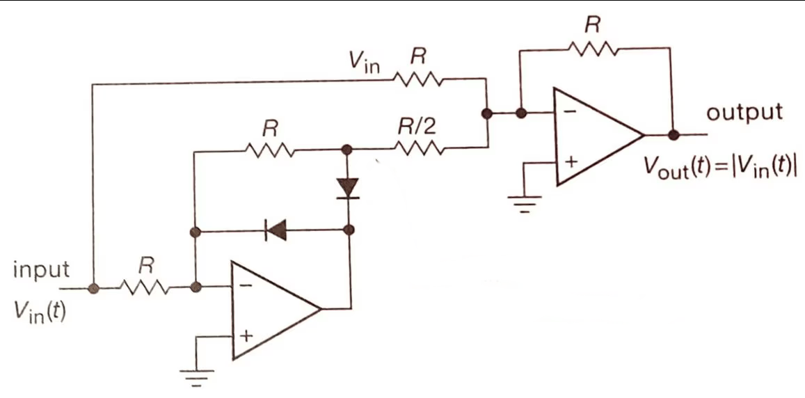

What's your preferred "precision rectifier" circuit, that feeds the attack / release circuity you've posted? I've been using this one;
I put just enough C across the R in the second op amp to minimize the ripple, trading off between that and "attack" speed. I'm up to 100k on the Rs, as I want to minimize the loading of the signal driving it. Better way? Or, if you use your attack / release generator following, you dont need any C at all?

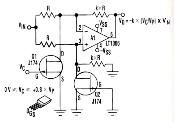

Stumbled upon this today. I wonder what would happen if you put the GE H11F in place of the P channel FETs shown. Light the LED of the grounded gate one with enough current to drive it to minimum Rds, while the other provides current controlled variable gain via its LED.
https://www.electronicdesign.com/te...two-jfets-form-a-voltage-controlled-amplifier

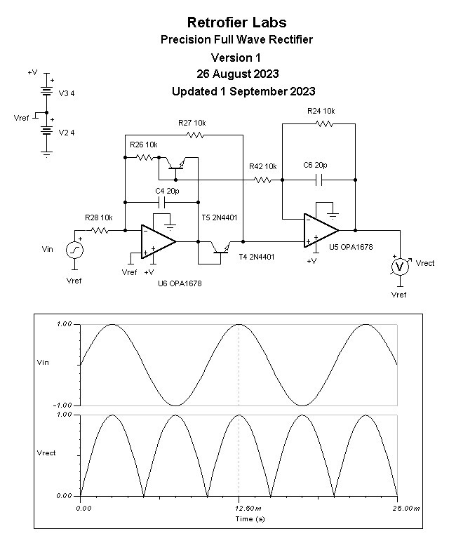

This is the rectifier I'm using for my latest feedback compressor.
The transistors used here are often called "diode connected" but it's not true, they actually do have tranistor action and in some cases it matters but not here. You could just use 1N4148/914 etc.. Also the OPA168 and the 2N4401 are used as convenient simulation models but not what's in the actuall circuit. The transistors in reality are a dual surface mout device and the op-amps depend on the compressor application and supply voltage etc..
This one is designed to run from an LE80 regulator that can work from a 9 Volt battery very well. I have been doing low voltage circuit experiments in general that depend on rail to rail op-amps. What can be done with a single 8 Volt supply is surprising. I haven't done much with 5 Volt audio yet, but I may get around to that too.
The simulation power supply here is used to avoid drawing the reference generator etc. used in the actual circuit.

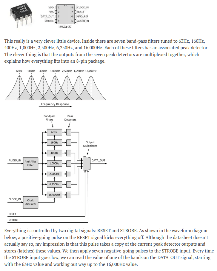

I was thinking AC to DC envelope generation could be sped up by using a graphic EQ and putting a converter after each band; obviously the higher frequencies would require less filter TC to get rid of any ripple and therefore could "attack" faster. I ran into this, which apparently does it in an 8 pin dip. The output is a multiplexed analog level. I suppose you could choose which bands effect the VCA at all, or make up some proprietary blend of which ones effect the VCA CV more. I'm losing grip on my OCD about this, so I better stop now and go play guitar in the sunshine I see out the window!
https://www.eetimes.com/msgeq7-based-diy-audio-spectrum-analyzer-for-badass-display/

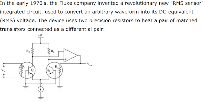

I looked of course, cant find anything about the Fluke chip that implements that circuit. What would you do for DIY? Put the transistors/resistors in a glass bottle and evacuate? Crazy people make their own vacuum tubes on YT...If you have a data sheet I would love to see it.

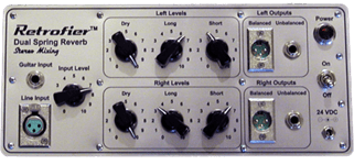

I have considered other reverb experiments but only ever did spring. I made two dual reverb units that used 4 spring and six spring tanks for some amazing sound. The drivers for the tanks were designed to give tube characteristics which warmed up the sound and gave a bit of compression to it. The signal to noise was over 100 db and I didn't even think that was possible for a spring. Making a super quite studio spring was my motivation at first but I didn't think that it would work so well. One of them is in a studio in the Seattle and the other is in a stidop in Sequim which is on the Olymic Peninsula.
I have one professional recording (Birch Piera and the Gin Joints) where the entire band goes through the dual spring and the guitarist is using one of my tweed combo amps that has the classic Accutronics surf spring in it. In all there's 3 tanks involved in the track and panned here and there. It's quite an effect. The dreamy smooth reverb is from a Type 9 tank with six springs, and the more surf sounding units are the classic Type 4 that Fender used.
And regarding getting the evelope, this is a big deal when making a first class noise gate for guitars. You get the control signal just after the input buffer and that means the entire chain. In the case of pedal boards I have set guitarists up with an external input buffer with a control output. My noise gates using this two piece technique are quite impressive. The input buffer is the first thing the guitar sees, and then the gate part goes where you want it. They go right down to the resistive noise of a humbucker.

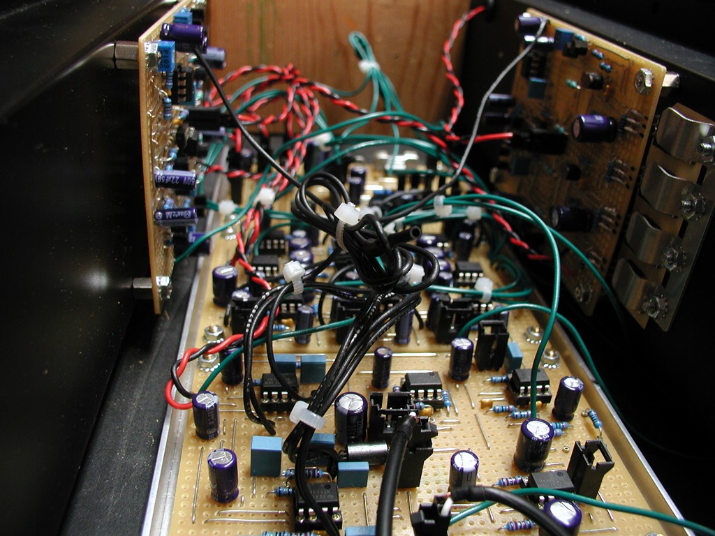

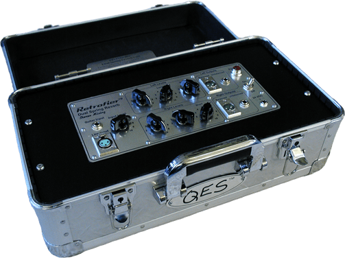

The Dual Spring Reverb was all hand built with through hole parts. I don't do things like that anymore and it already seems like a past life. The case that looks sort of like a flight case is a DJ CD case.
The boards seen here mounted to the reverb tanks are the driver amplifiers. The one on the right shows how the power transistors use the reverb tank as a heat sink. The drive coils are 10 Ohm.
Anyway, that was my adventure with reverb. I hope to get back to it soon. I miss having high quality line level spring in the house.

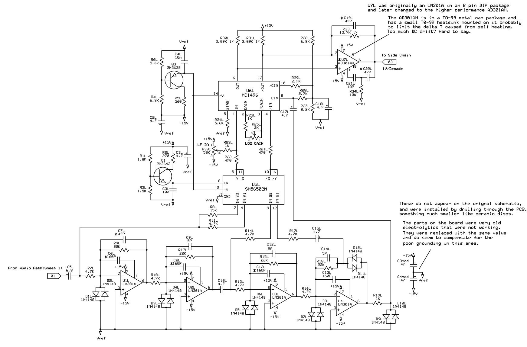

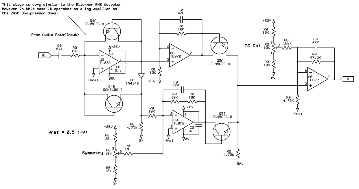

Getting back to the Omnipressor, here's the original log amplifier/rectifier. It was "cookbooked" back in the day from various data sheets etc. as far as I can tell. I found various references to similar circuits. David Blackmer did recognize the problem of the complexety and came up with a much simpler version and Wayne Kirkwood further simplified that circuit and I adapted Wayne's version for my version of the Omnipressor.
This is the version that I used for my Omnipressor with great success and that was a bit of a surprise. It seems too good to be true that it could boil down that much but this has quite a bit to do with the transistors available today. Wayne used a rather costly THAT corporation transistor array and I used some surprisingly cheap and readily available dual transistors and it works great.
From the perspective of an Oscilloscope, this circuit is almost impossible to distinguish from that elaborate orignal Omnipressor version. It's even temperature stable using the devices that I did.
It's very interesting to note here that the Omnipressor did not filter the log amp to end up with an RMS output. It peak detects the log amp instead. This is an important component to the Omnipressors behavior.

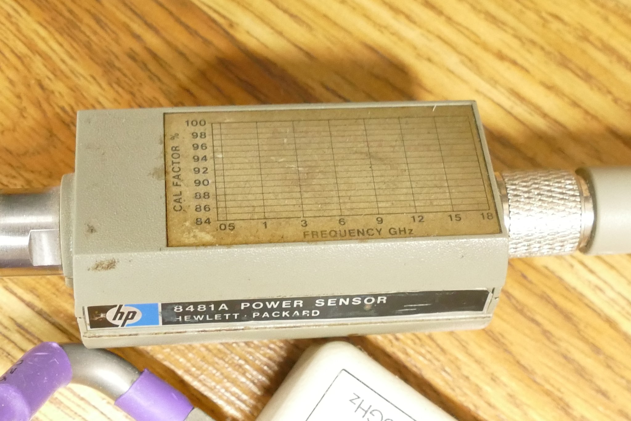

The Hewlett Packard RF power meters from the same time period used a similar bridge circuit with two tiny 50 ohm thermistors in place of the transistors. The bridge had a square wave signal in the 50 KHz range applied to the +V port and the RF signal capacitively coupled to one thermistor to heat it. The RF was limited to 50 MHz on the low end, but the upper end was well into the GHZ region. The opamp would not respond to the milliwatt level RF signals above 50 MHz. My mid 80's version goes to 18 GHz but the factory cal chart wore off long ago.If you really want to go out on the fringes of audio envelope generation; I wonder how fast you could make it go with SMD?
