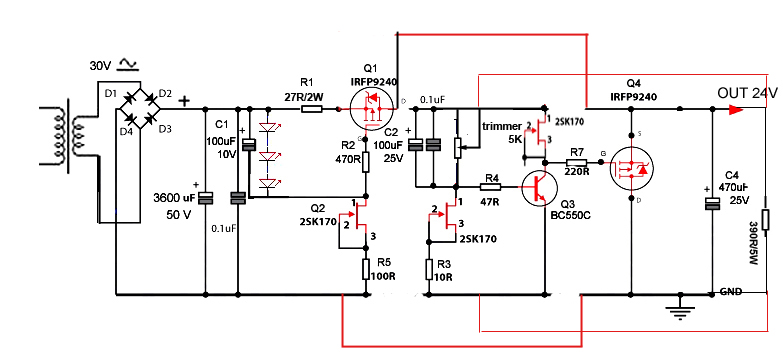

If I measure across jfet (after Trimmer) is 0V. between S and G of Q4 is also 0V.
If you logged out - to gnd is an unbearable humming. If I connect in -B1 from the buzz is minimal, only hitting the ear listening to the speaker. I do not understand, the difference is only 20 cm connection cable (unshielded).
The input transformer is 18-0-18. I connected the two poles (18V)of the bridge rectifier and 0V pole is free. The first capacitor is 4600uF Nichicon. C1 and C2 is Panasonic 150 Panasonic UF (not 100uF). 470uF C4 is known unbranded and 0.1 uF capacitor C4 I deleted.

You got to have VGS readings in all Mosfets. See if you have burned Q3 or Jfet under trimmer. 18+18V could give you around 50V rectified. Waisted heat on CCS Mosfet and R1. Only one 18V secondary must be enough for 18Vout although tight. I would use a 22V single secondary Tx and remote sensing. That would certainly give noticeable resolution when using 20cm wires.
If I understand you correctly then you are telling us that the PSU powers your B! successfully. Good.
But you then go on to tell us that the PSU measures wrongly!
Why did you connect it to an amplifier, before finding the error?
I ask because I do not know if there is an error.
I have to know if measures are correct, but still connecting sounds good (except the hum if I connect the ground directly to the negative output of the regulator).
I connected the two poles of 18V to 24V to get out and make comparisons with an output of 18V.
I will connect one pole of 18v and check the components. I'll post the results!

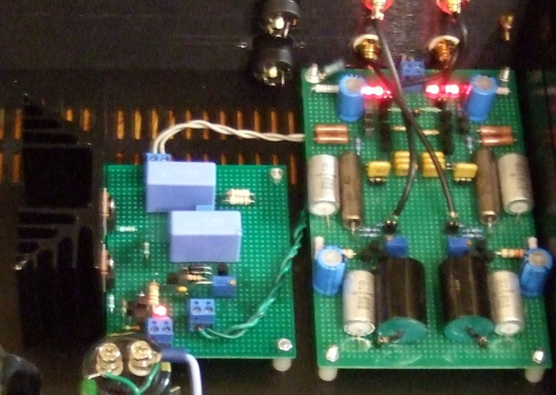

P.S. Quick photo. V1.2 with 9610/9540 feeding 2ch/6 stages at 240mA CCS 47.5Vout 100mA consumption, remote sensed. Buffer BJT stuck underneath shunt MOS far away from error amp. 10uF MKT + 0.5R across its output.

Just follow my schematic looking at the build, forget layouts shown for a while. Is it 100% compliant for connections at least given the pin outs of your semis? BC560 is like 556 for pin out BTW. 2SJ103 is SGD from left to right as we face it, and is P channel. Check carefully. It would need to go as in attached.
