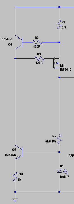

only to clarify, what should be close to what exactly? as it is now, my whole ccs fits a rectangle of 4cm by 2cm, this seems within reason to me...
i will also try the 82r gate stopper

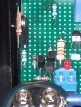

If the LED is not lit strongly then some oscillation in the ccs. Not the bjt type. If the cascode bjts aren't tight to the ccs control bjt is the reason. If you can kick start the reg by touching the ccs gate stopper with a probe then that's it. If it gets warm, it may kick start alone at a point, and then works clean. You may also go 82R gate stoppers for 9540 series. They seem more capacitive than in data, since their ygfs is actually stronger than 9240s.
I have been here before and I found the finger "kick start" by myself once.
The ccs led in V12 do not glow 1/2 the brightness as the one in my v1 implementations.
Lowering the voltage divider resistors from 5k6 to 3k3 did not improve much in terms of led glow in my 37 or 28v shunts.
I can not hear any noises and v12 fullfilm is clearly the winner in terms of speed, detail and dynamics, but in my last build I am registering a slight hum that might be caused by ccs instability.... and gave me a hard time shielding every power line in my build.
My ccs layout is not as closely built as you showed .... can this be the origin of my issues ?

Can't be sure, you may rearrange it and see. In my experience its either sure oscillation or clean. Not some little hum. But it can be a low level oscillation in yours. Without a scope we can only guess. The LED here is about 3-5mA depending on Vout and resistors used, not at idss like in V1, so don't expect a glow like in V1, but it should not be too weak too.
One thing you can do is go one transistor if you can not solve it by layout as it is, and see if the LED glows stronger. It will be much easier to tuck it together. It loses some performance but still very cool. If it will work good and you really had a problem, it will be better than before. Then you will know if the little hum was related or not too.
It is good to know we can do the ccs with only one lower bjt but the performance is so good right now that I do not wish to compromise.
As I already built six v12 with EL output cap with exactly the same pcb layout and these work perfectly, I guess the problem might be in the big output cap and it´s long legs.
Is there anything I can do to minimize Loop area ?

This time you got technically added R outside the cap. If you will bypass any film cap there it will not have an impact on circuit's parameters. Its not a matter of the reg design if you got some hum. Its a whole phono build and regs layout. If you don't target its origin we are talking guesswork. If you had no problem with lytic output, add one across the output film (not including the +0.5R), so to see if you simply need more uf there or not. If nothing changes then its probably pick up due to widened loop area. I use compact radial MKT or MKP caps in V1.2 that can be altered subjectively by MKP1837, Ero KP, FT-1 Teflon etc. bypassing.
