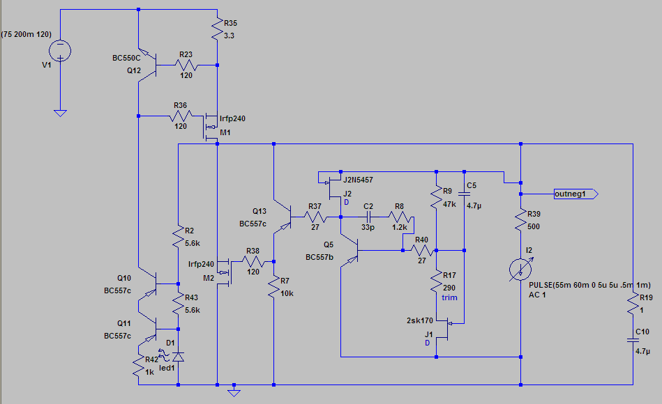

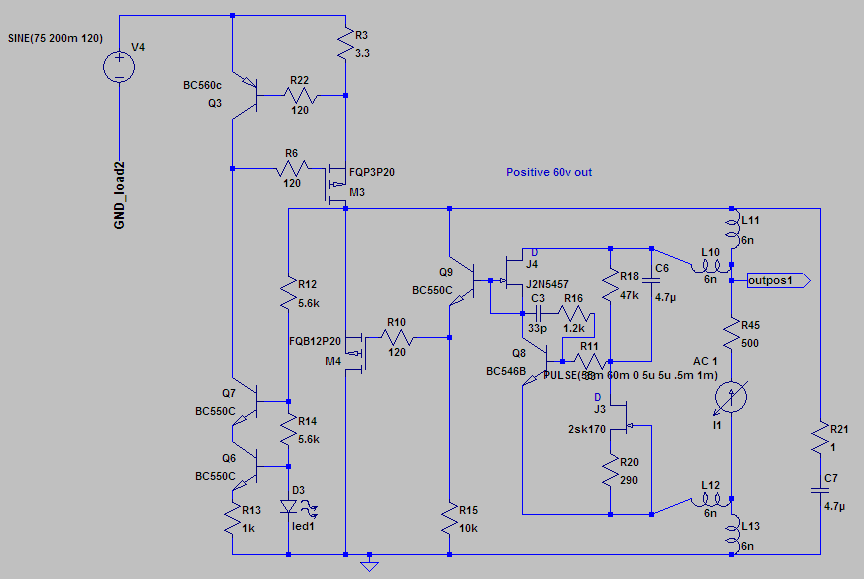

positive and negative regulator at 60v out
Here are my schematics for a positive and a negative regulator for 60volts out about 100ma load. They simulate corectly, are they correct?
Ken
post2928.
Did the simulator indicate any difference in regulator performance when the cable inductances were added/subtracted?
I see you have +ve out and -ve out in the two diagrams.
You have omitted Zero Volts out in both diagrams.
The zero Volts is NOT at the ground symbol.
The junction of L12 to L13 is outposZeroVolts.
