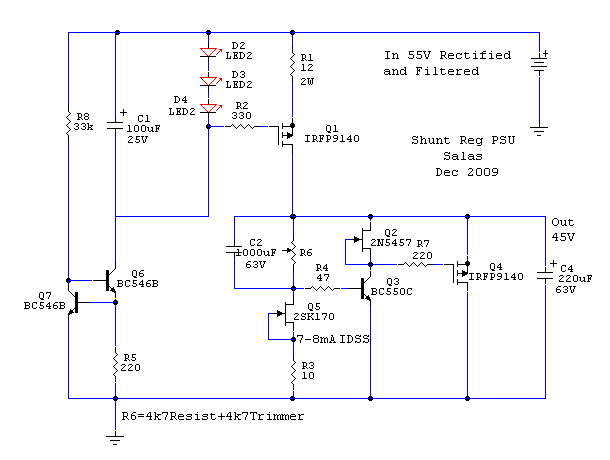

The latest published Salas shunt reg that I'm aware of has the R3 mod, and has added a bjt buffer to drive the shunt mosfet, and a jfet based Vref. I think that's v1.1, Salas, please correct me if I'm wrong. This might be it:

In this circuit R6 adjusts the output voltage.

Iko, that schem isn't v1.1 (where is the BJT buffer?)
That is an higher Vout version conceived for his low MC/hi gain Riaa with 45V p.s.
He stated it was not safe to use v1.1 due to some BJT limits.
This should be v1.1 (with Q7)
Q5 JFET can not take the max if we are talking over 40V out.
massimo, thanks for the correction, indeed, the one I posted has no buffer.
george, yes, that's the latest one I was talking about with Salas last night. I really like the biasing of the CCS in this one. It should have very good psrr, and it has the benefits of remote sensing, buffer, and low noise from using a jfet Vref. If it's stable it should be an improvement in specs. Looking forward to see how it fares.

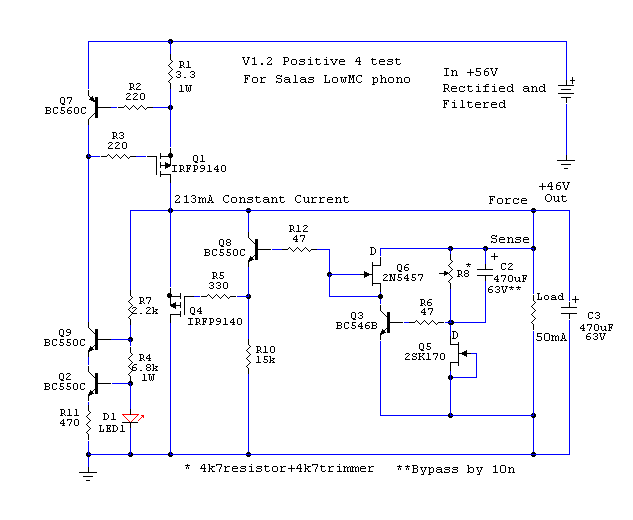

There is a V1.2 waiting to be tested though
That one is the general line, I am afraid of oscillations. Its to be tested and tweaked soon. I think it will work with IRF9610s and a 4.7p Cdom Miller cap from C to B on the 546B more likely, or as it is with a 33p-47p Cdom. The Vbe controller in the CCS and the Mosfets can take less base/gate stopping to help the phase margin too. But many times the theoretical loop gain isn't realized and some other factors work slower so things run easier in reality.

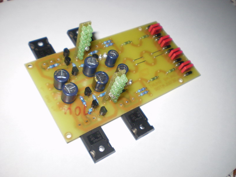

Picture update!
