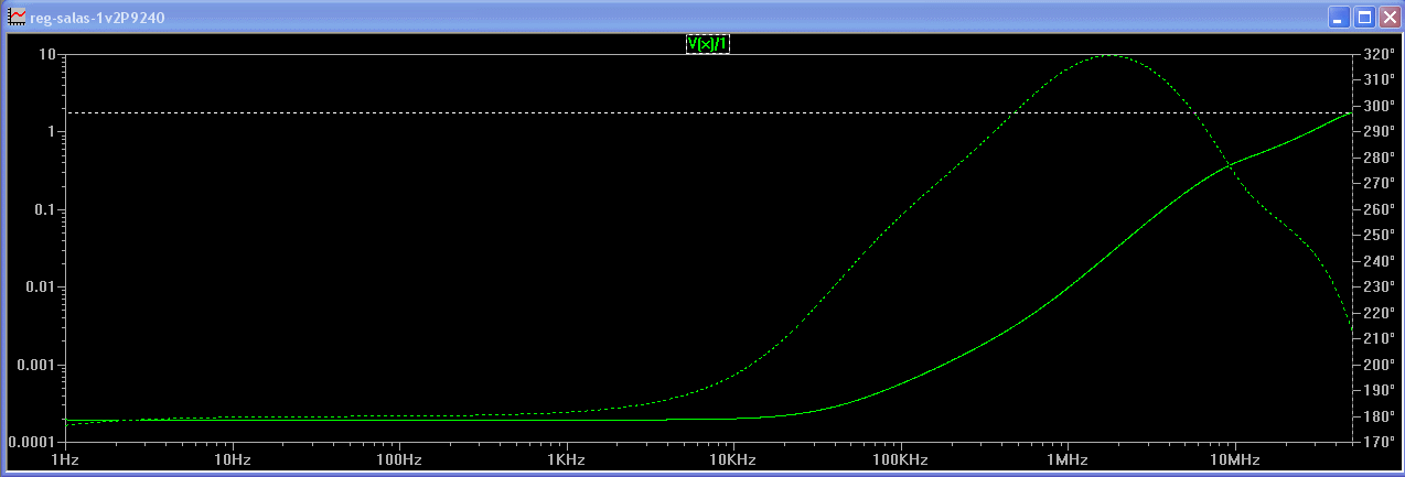

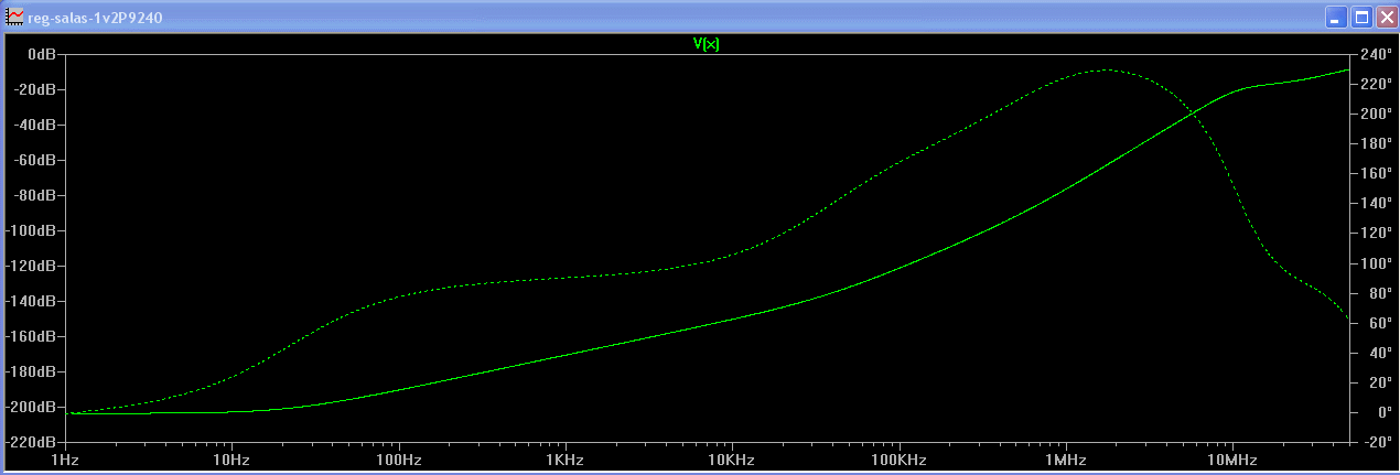

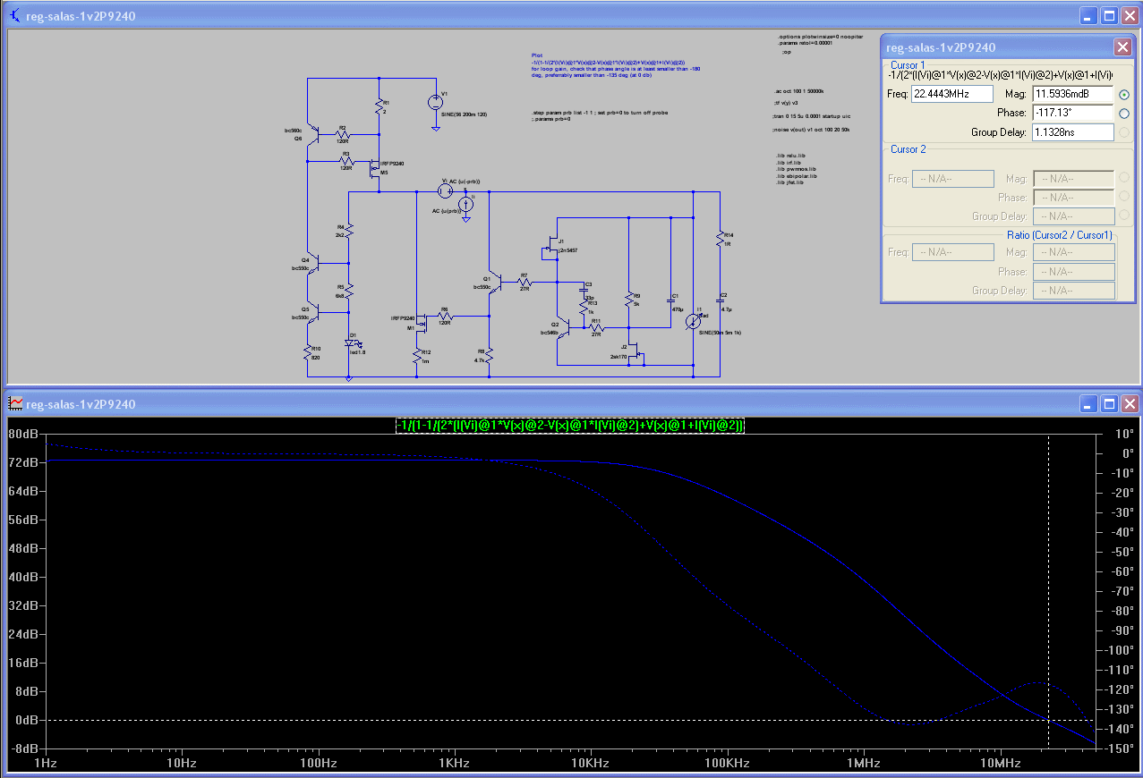

I miss 2 parts and a some heatsinking, got to meet a busy mate to get those, before hitting the perfboard. Meantime I got a bunch of LT Spice models from Iko (thanks man!) and looked a bit on its theoretical performance, also I applied theoretical compensation & termination. It looks responsive on paper to what I had in mind to do with the soldering iron. I thought of terminating with a few uF PP and adding an R series (Zobel) as I do in the simplistic HV. That would save shopping for this or that specific esr electrolytic and its whims with age and ambient. Fixes it for termination, and gets rid of possible Cout big chemical cap's subjective signature. Now, how close those models are to the bugs and the wires that I am going to stick on that Swiss cheese board, only cosmic gurus know.
Encouraging indications non the less, but the proof is (as always) in the pudding.![mischievous :mischiev: :mischiev:](https://files.diyaudio.com/forums/images/smilies/mischiev.gif)
Anyway. The following captures represent loop phase margin, rejection and output impedance.
There is a V1.2 waiting to be tested though
That one is the general line, I am afraid of oscillations. Its to be tested and tweaked soon.

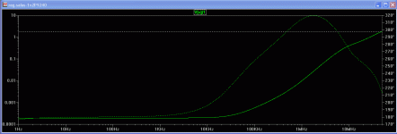

Nice job Salas
