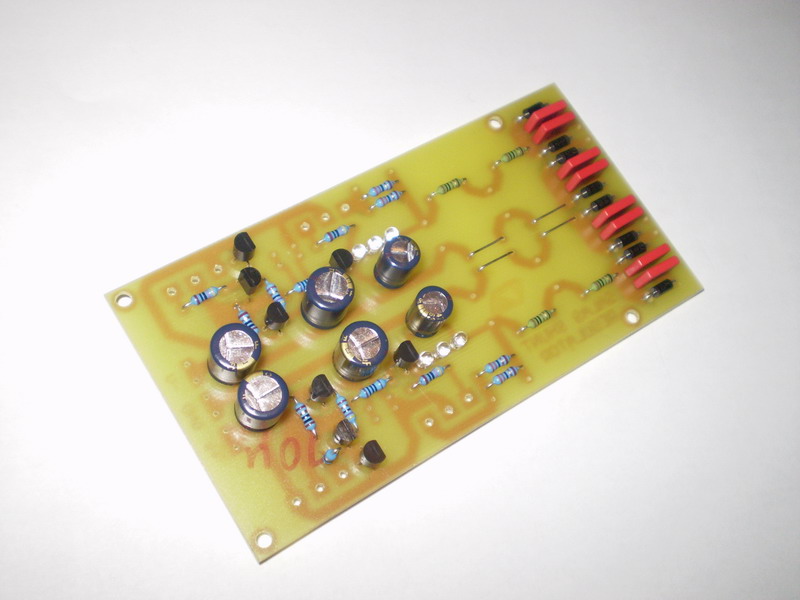

I'd like to know if the Shunt and CCS can be modded for use with a load requirement of around 400mA, Vin(20)-Vout(12/10)Vdc positive rail?

Easily, just a matter of choosing the trafo secondary AC right, setting the CCS resistor for more than the load, adjusting the Vref, calculating the dissipation and sinks.

Perhaps a couple of hints as to what "R" needs adjusting.
My PS.... PT's secondary > FWBR> CLC> 19-20Vdc.
Can the CCS be used stand alone, without the shunt regulator?

If you read the thread you will see that R1 sets the current Iccs=VacrossR1/R1, a Zener or Leds or some resistor can be the fixed Vref. Yes the CCS can be used alone in other applications. I suggest you read -using-hypnotize-general-shunt-reg-pcb for a compact example guide.
