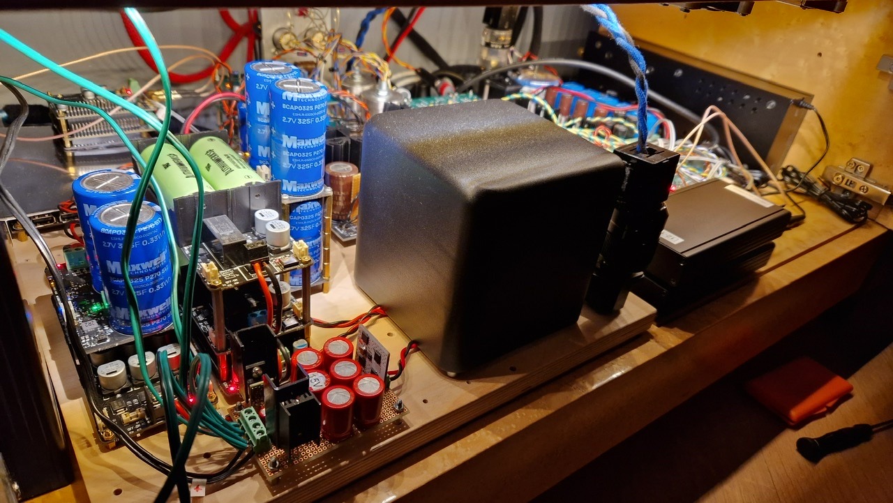

For the clocks I am using A123 batteries with a 67F 20V Ultracap Bank from EATON in parallel. That was for me personally the Sweetspot. Smooth but very detailed and deep stage. I run them without charger connected, so totally floating isolated from mains and earth. The moment I connect (by relays ) the charger the smoothness gets a bit sharper and the holographic image gets a bit smaller. it is mostly the 5,6 and 6 MHz clocks which show this. Not because they are bad, but because they are so good. The 11,12,22,24 MHz clocks are also very good, but lack a bit the magical music touch. Here the effect of the mains supply is still audible but less significantOk, i started to use the battery supply now, for the clocks only at the moment.

H Swak, i am using a “ Ali express “ psu board with CV CC trimmed at 18 volt closing voltage. As said, both mains and secondary are switched off from the clocks with double relays .
it plays for roughly 10 hours. If I need more, I will switch back to charger mode… still great music of course. this is also the normal condition the clocks are in. The batteries are always full and when I start listening I flip a switch. An Arduino controller controls everything and forces charging when the batteries are below 15 volt.
i am not using an ultracap on the DAC ( no more space ….)
yes, the little board on the bottom left in the picture, with the red BG non polars is a power supply with two ps lines for the clocks.Supersurfer,your mosfet rectifier is a Saligny?
Hi Supersurfer,yes, the little board on the bottom left in the picture, with the red BG non polars is a power supply with two ps lines for the clocks. View attachment 1142771
