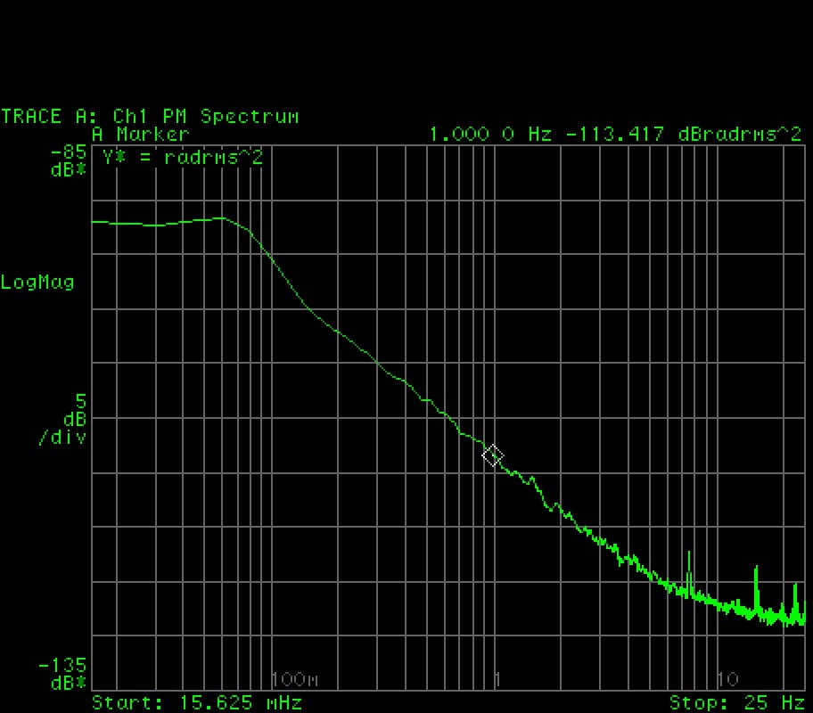

Neither do I. Since I am currently dabbling with oscillators, here's so far my best shot. A 0dB 6.144MHz sine, from a fractional PLL, using a MTI Series 225 VCOCXO (the best of the best, space grade, long live EBay, got it for almost free
Note: the chart shows L(f), to get S(f) add 3dB. -110dBrad^2 @1Hz and -124dB @ 10Hz is not too shabby, but a far cry from what they are claiming <-120dB @ 1Hz and <-148dB @ 10Hz, I haven't seen such numbers even for sapphire oscillators (normalized to frequency). Note the b-4 break shortly before 0.1Hz.
