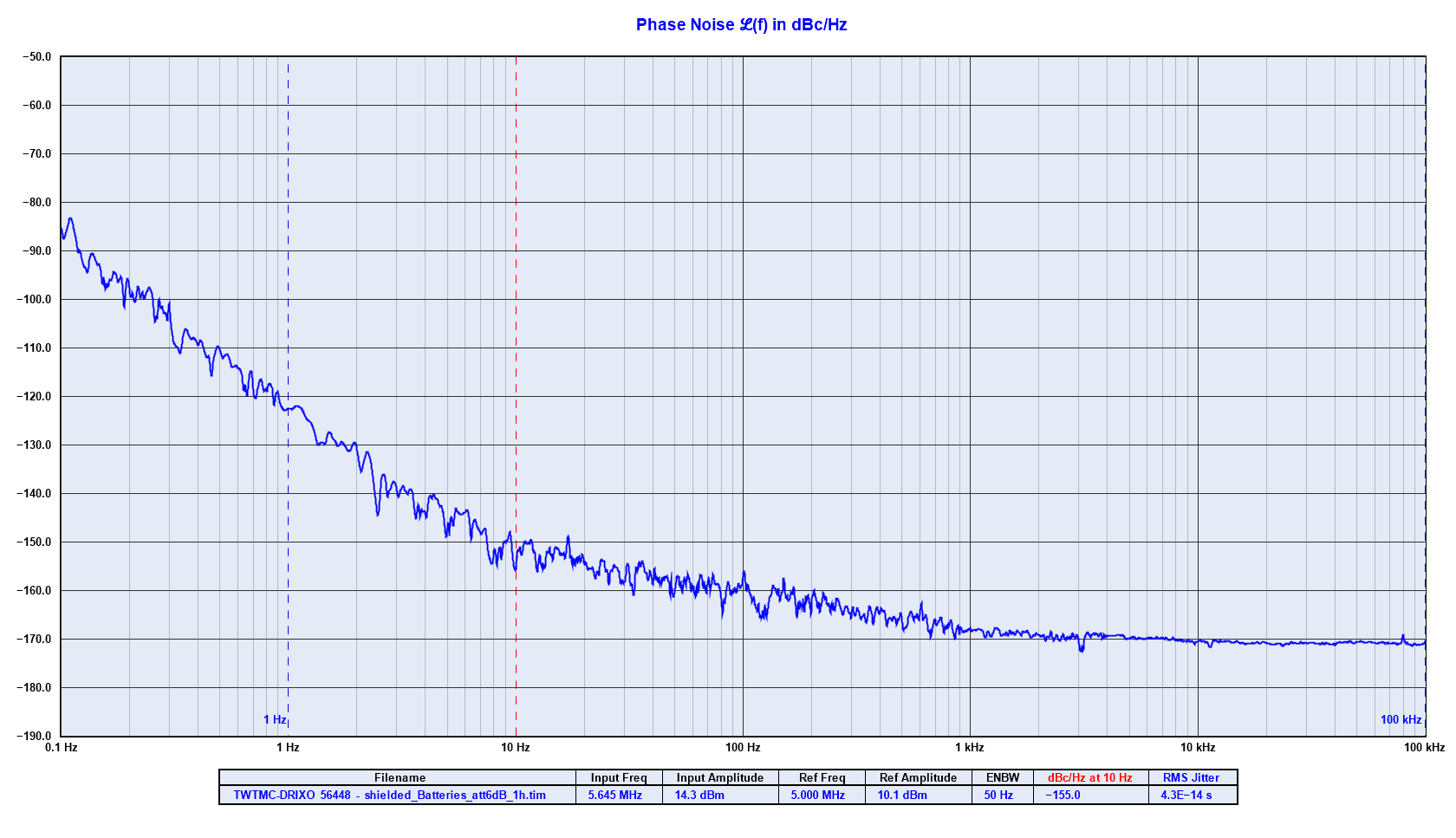

Actually the DRIXO at 5.6448 MHz has a little better phase noise: -123dBc against -120dBc at 1 Hz from the carrier and -155dBc against -148dBc at 10 Hz from the carrier.

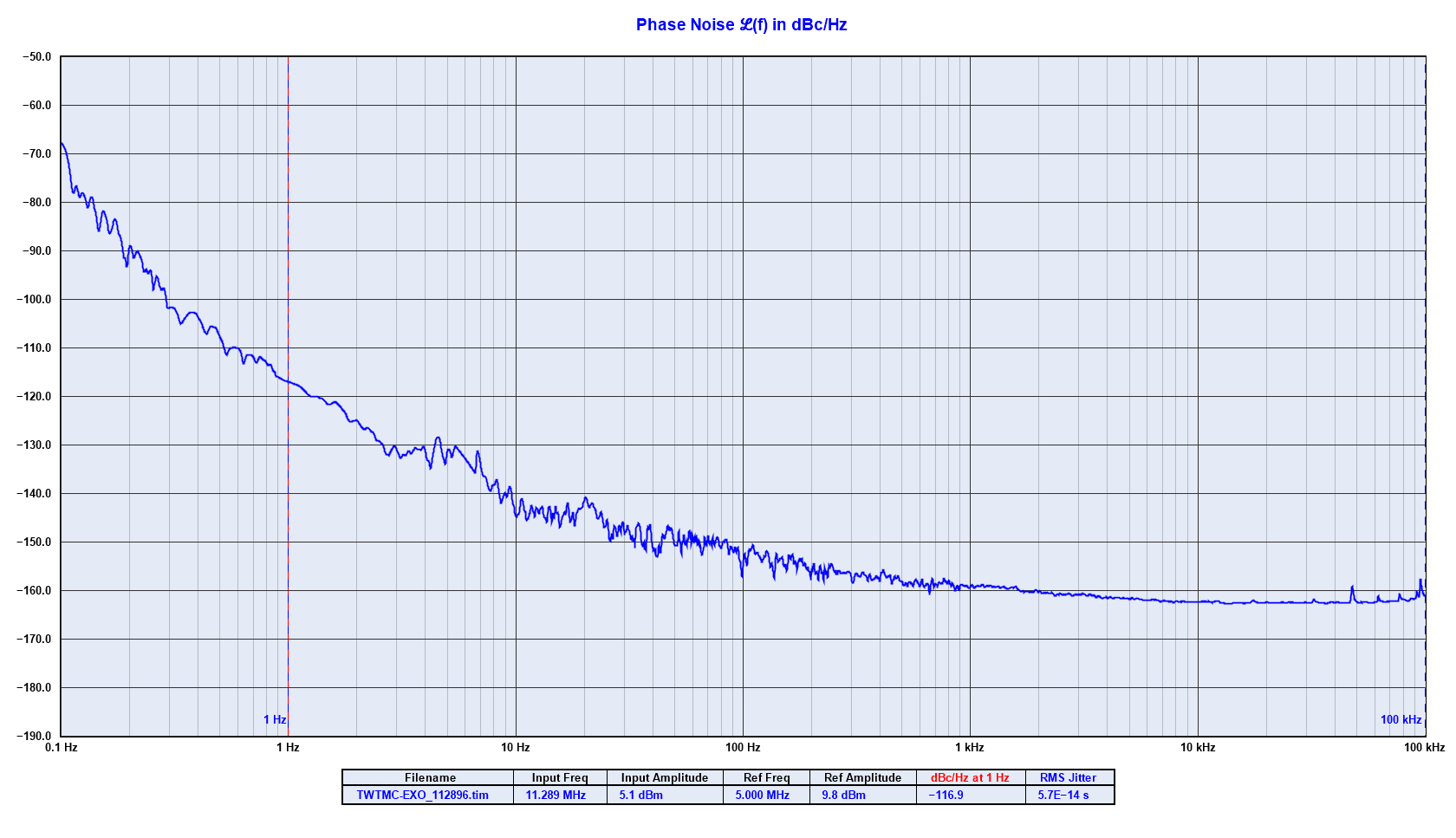

And the EXO at 11.2896 MHz has almost similar phase noise performance (3dB worse): -117dBc against -120dBc at 1 Hz from the carrier and -145dBc against -148dBc at 10 Hz from the carrier.
At these levels of phase noise the crystal makes the difference, the 1/f3 noise is fully dominated by the random walk of the crystal due to the impurity of its surface.
It's would be curious to know what crystal they have used.
Usually higher overtone crystals perform better because they have higher ESR and so the loaded Q is maximized.
We will try soon a 5th overtone crystal at 11.2896 MHz in HC-47/U package.
The Q of this crystal is similar to the 3rd harmonic one (a little higher) but the ESR is double (around 200 ohm) so even the loaded Q will be higher.

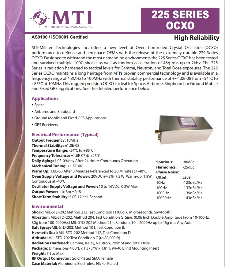

MTI-Milliren 225 OCXO 10MHz
10Hz -123dBc/Hz
100Hz -137dBc/Hz
1000Hz -139dBc/Hz
10000Hz -143dBc/Hz

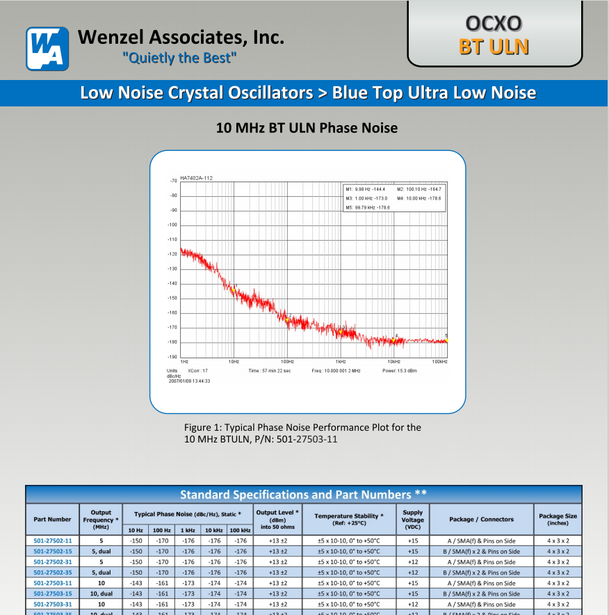

Wenzel BT ULN 10 MHz
10Hz - 143dBc/Hz
100Hz -161dBc/Hz
1000Hz -173dBc/Hz
10000Hz -174dBc/Hz
TWTMC-EXO 11.2896 MHz
10Hz - 145dBc/Hz
100Hz -154dBc/Hz
1000Hz -159dBc/Hz
10000Hz -163dBc/Hz
It looks like the MTI 225 it's not "the best of the best" like someone claims.
Conversely it's "the worst of the compared oscillators".
But maybe I'm wrong, since I'm not measurements obsessed I'm not able to read the measured data.
It looks like somebody is unable to read what was posted. No one compared the MTI Millirad directly with a Wenzel. The MTI 225 was used as VCO in a fractional PLL, which is, ahem, quite a different story.

WRT the MTI- making a good tunable oscillator is another major challenge. Crystals do not pull very far and so you need to do some compromises to even get much tuning range.

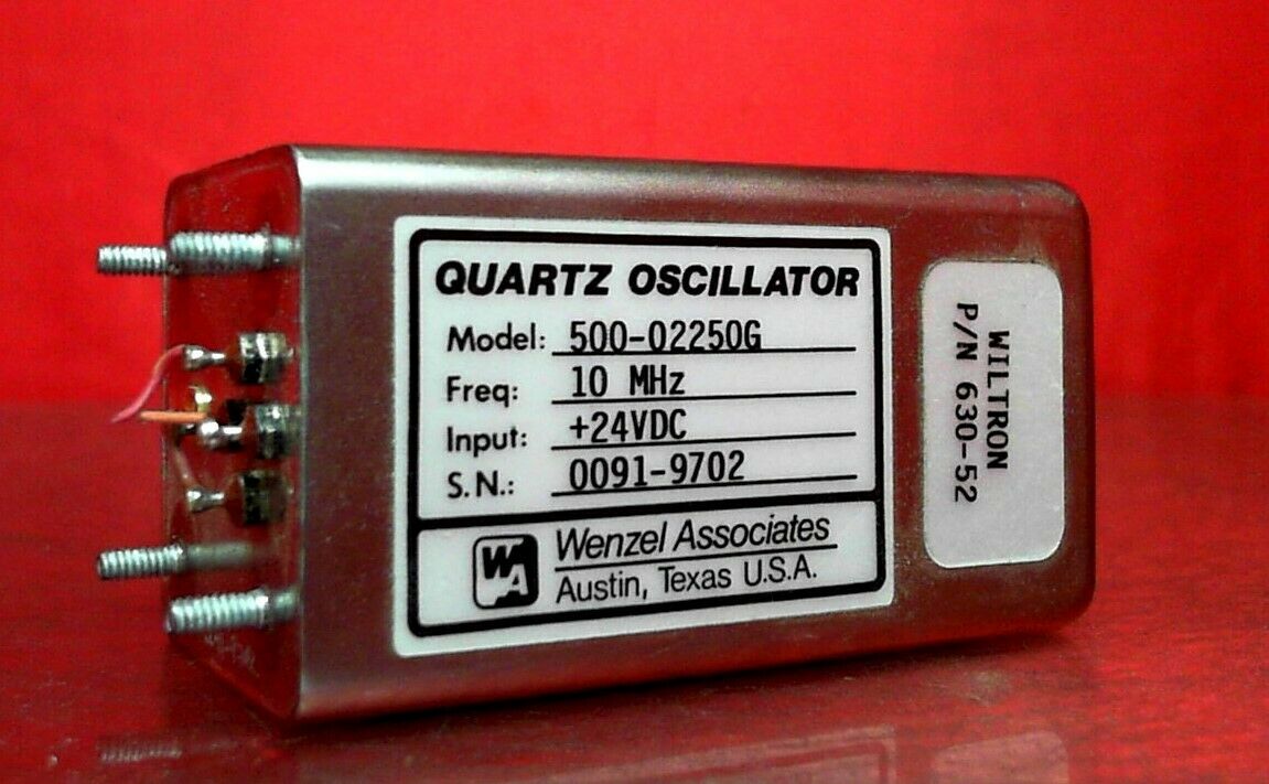

I have myself a 10MHz spare Wenzel 500-02250G for my Anritsu/Wiltron 6769A 40GHz digital synthesizer and also not willing to crack it open. A power monster, takes about 20W from 24V after warming up, but the stability and phase noise are beyond anything that I have measured with my own hands (under -155dBc @10Hz and slightly under -120dBc @1Hz). It is used as a reference in the synthesizer 500MHz PLL reference loop (pic is from the Internet).
