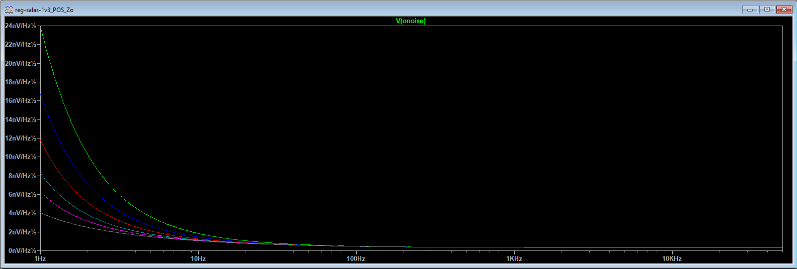

Is/could there be any connection between 1/f noise and phase noise in relation to sound quality? generally that is, not just in clock circuits.
Increasing C2 capacitance on UltraBib regulator has the effect of decreasing 1/f noise. I noticed recently that increasing significantly from the stock value had quite a positive effect on overall sound of both analogue and digital circuits.

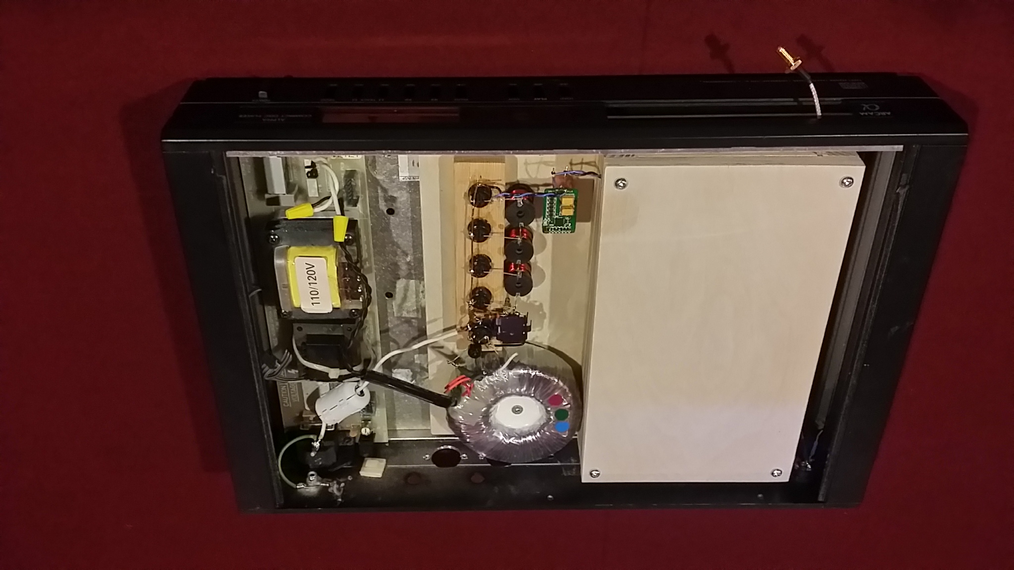

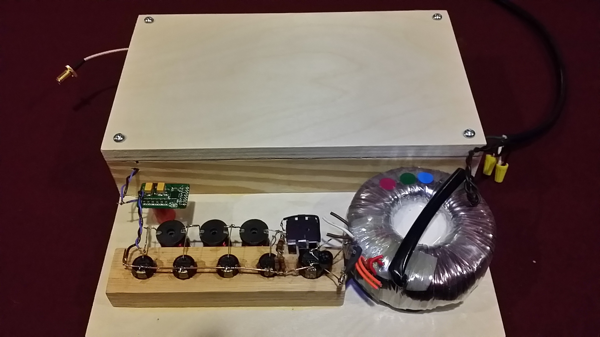

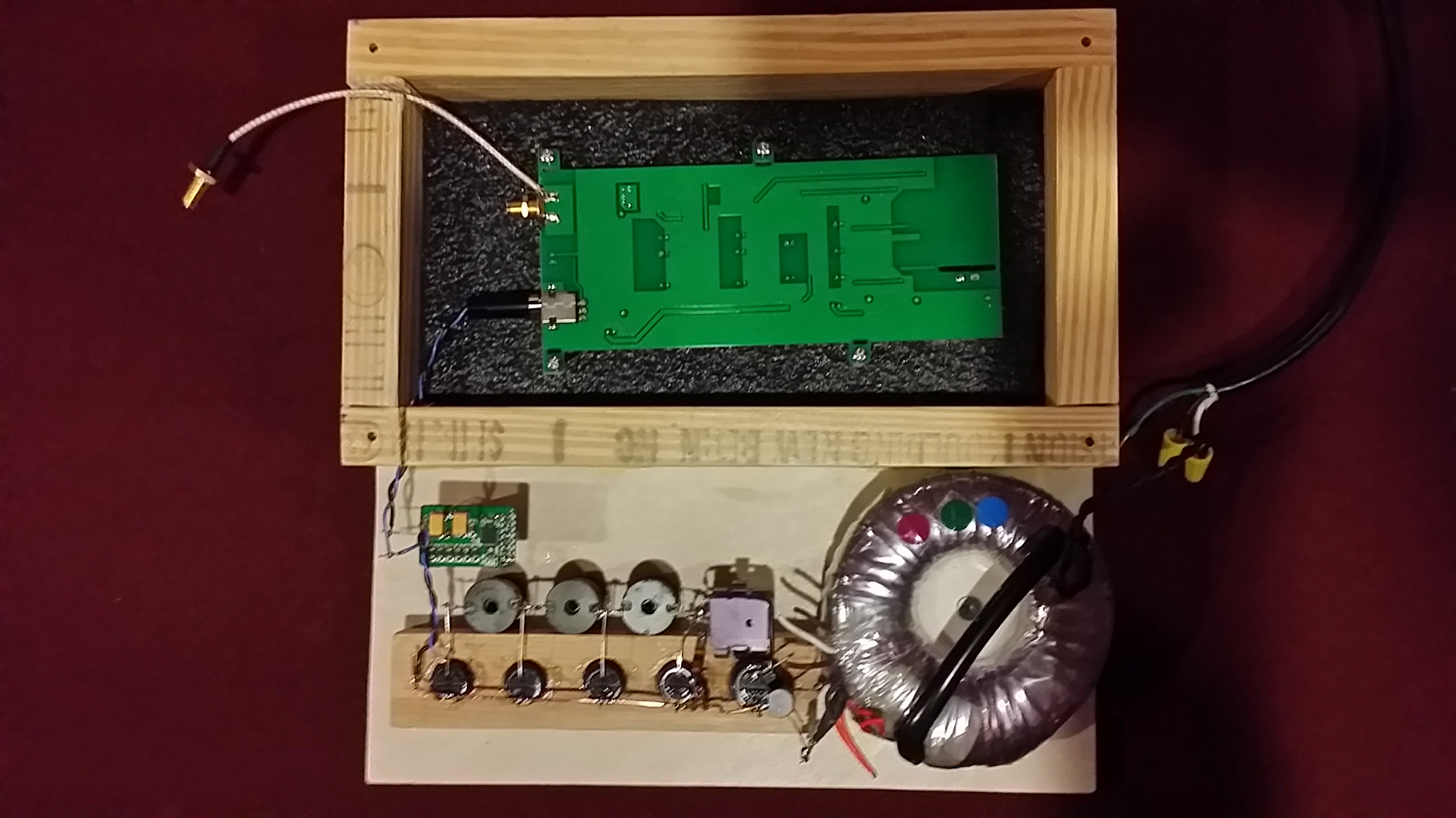

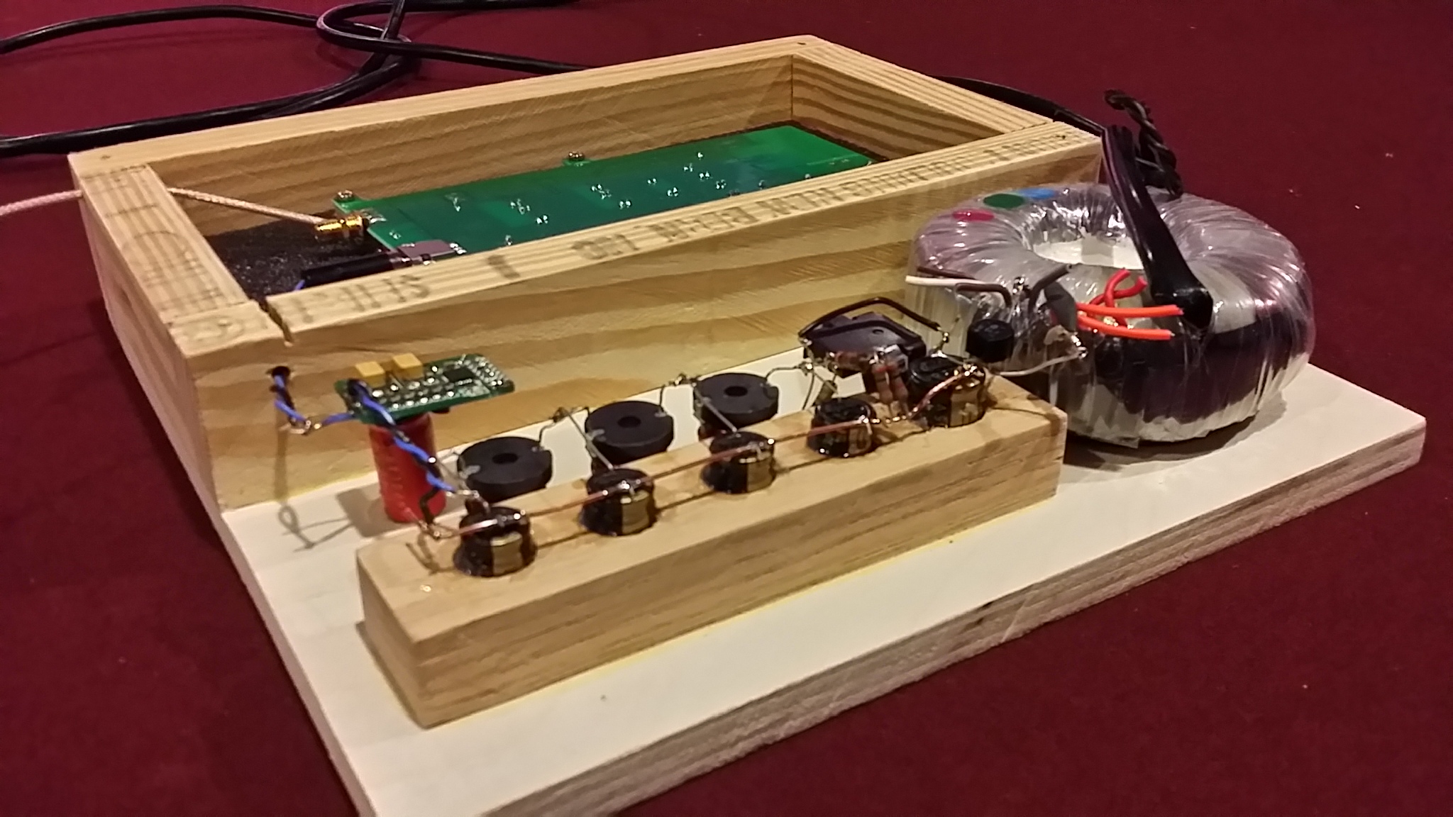

Warning! This post could be hazardous to health of engineers
FWIW, I thought I’d share my implementation which focused on mechanical shielding and power. I use my full arsenal of audio fool Hokus Pokus, so proper engineers should stop reading now. Proceed with caution.
Based on the 2019 WTMC, I feel that these crystals are quite microphonic, and benefit from vibration dampening. I also heed Andrea’s advice to pay attention to RF/EMI shielding and to separate the clock in its own chassis well away from the DAC. I found PS to be important, but feel good is ok, and great may not be required. So rather than battery, I built a reasonable low noise linear supply which will be constantly powered.
Power Supply
It is supplied by 18v tap on a medical grade Plitron transformer. They tend to be very low noise. Panasonic FC filter caps are used (1500uF). After the first cap, there is a LM317 pre regulator taking it down to a pretty clean 22v. That’s followed by 3rd order CLC filters. Then a TPS7A4700 voltage regulator takes it to 16.51V. The reg has been modified with Black Gate caps. I believe this will provide clean power 7/24 for years to come.
Vibration / Isolation
The power supply and the WTMC PCB are mounted on a Baltic Birch structure. The caps are potted with silicone in the wood. The WTMC floats inside a wooden box that is lined with foil. The entire wooden structure floats on silicone inside an aluminum chassis. All of this is to help with vibration dampening.
The PCB sits on packing foam in its wood box. On top of the PCB is a layer of dry sand. I find sand an excellent way to kill vibration. The Laptech crystal is sandwiched in it’s own block of foam which in turn is glued to the PCB. Per Andrea’s suggestion, it’s electrically connected with fine wires. The foam will provide temperature and vibration stability. The layer of sand compresses the PCB into the foam and isolates vibration. The wood has less ring than a metal chassis. The foil lining the box should provide some isolation from the PS. The metal chassis provides a reasonable isolation. The whole thing has mass, and layers of dampening.
But does it work? After 24 hours burn in in the wood box, I listened to some well-known tracks. Then I added the foil and sand and mounted the whole thing in the metal chassis. Then immediately listened to the same play list. There was a clear and substantial improvement in sound quality immediately apparent.
The pics below show the set up. I elected to build all of this from stuff on hand. So the chassis is a repurposed box from my old Arcam 1541a CDP. Seems kind of right that is still powers a TDA1541a based system.

Nice report....
but, one thing concerns me a little, i see you have patched a coax to exit the wooden box... i guess you have soldered the end of the coax to the solderpad of the sma footprint on board.
I think in that position you have killed the constant impedance, and that hurts more than 10meter of cable after it.
I recommend, if i may, to keep the cables connected to the proper, impedance controlled connectors... you surely loose something, but signal integrity should be better ensured.
and also, if you can choose, prefer crimped termination instead of soldered one.
as always, my 2c 🙂
Hi gionag
Thanks,
I agree the soldered bulkhead cable is not ideal. I used what I had on hand.
When I order cables, I'll replace it with an SMA connector to bulkhead. I do not know to what extent it is an issue, but I'll change it if for no other reason to eliminate the concern. Looking at it, I find it hard to believe its much of an issue, but we'll find out when I change it.
Hello,
A medical grade transformer is one with a screen between the prim. and sec. side?
Rod Coleman ( makes heater supplies for DHT) always tells to use split bobbin transformer to get maximum separation between prim. and sec. side.
I am also not sure about the '' connection '' of the cable.
These clocks are sensitive to vibrations in the same way like a cartridge/tone arm/turntable combination?
The idea of Andrea to use thin wires is of course very clever because the circuit board is a big surface that will'' pick up '' vibrations, the coaxial cable and the power cable will also transfer vibrations to the board as well.
I think that like most vibration diminishing solutions foam, sorbothane, spring need a minimum load to actually work. If you mount the circuit in such a way that it will allow the clock to be attached to the board like a swing with two wires will it be influenced by airborne vibrations?
If so could you wrap it in some kind of foam ( just wrap the enclosure of the clock) ,some kind of felt made by natural fibers or piece of cork that can be found in all shapes and seizes.
If there is some space around the clock you can also make a little piece of cork to be glued to the board as an airtight '' enclosure '' which doesnt touch the clock at all.
