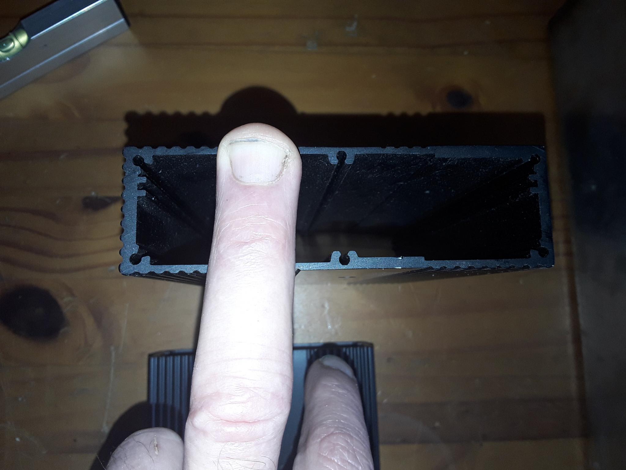

Hello,
Happily i see my idea supported. A few days ago i posted a picture of the rectangular extruded aluminium i will use for my Italian clocks. It is one piece which will screen better. Of course will close one side of the tube airtight.
Will it matter how much space there is between the circuit and the rectangle.?
Of course the other side is a bit difficult to screen with all the connectors.
Maybe sliding the circuit deeper inside and close the rectangle with aluminium with a few tiny holes just big enough to pass the cable and not the connectors. So make the connections and then close the boxes..

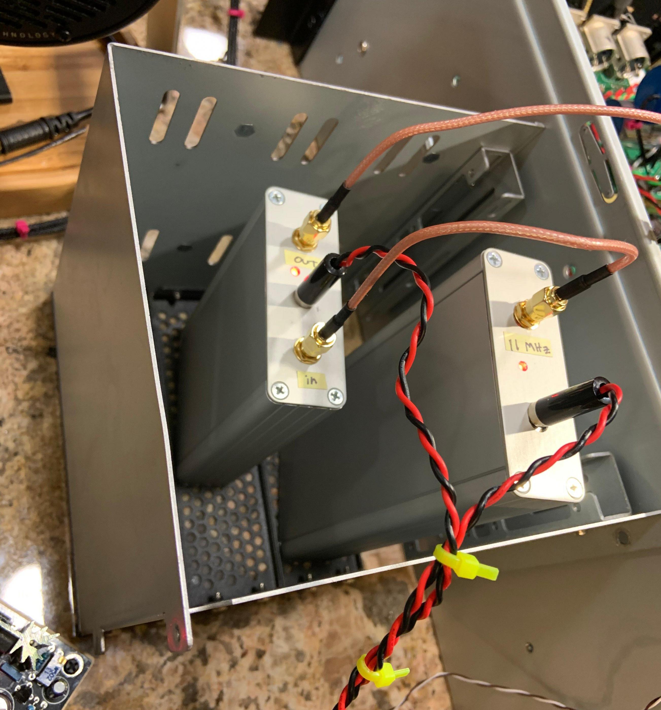

I noticed a SQ problem when I added a doubler. Where I live I need strong RFI attenuation. What always works best here is steel shielding. The SQ problem with the doubler in circuit was fixed by the shielding as shown below. To get the equivalent shielding from aluminum takes about 1/2" thick walls.
Nice. That will stop a lot of the stuff around most houses.
