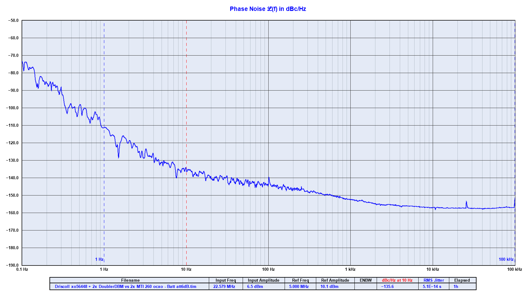

what were the "old" clocks you compared to?
dis you try difference between 44.1 and 192 with same tracks but rendered at those speeds. Linn studio for example does this and makes comparison nice and easy
The old Driscoll boards with SC-cut crystals (45/49) were the clocks before.
I'll try to compare what you wrote.

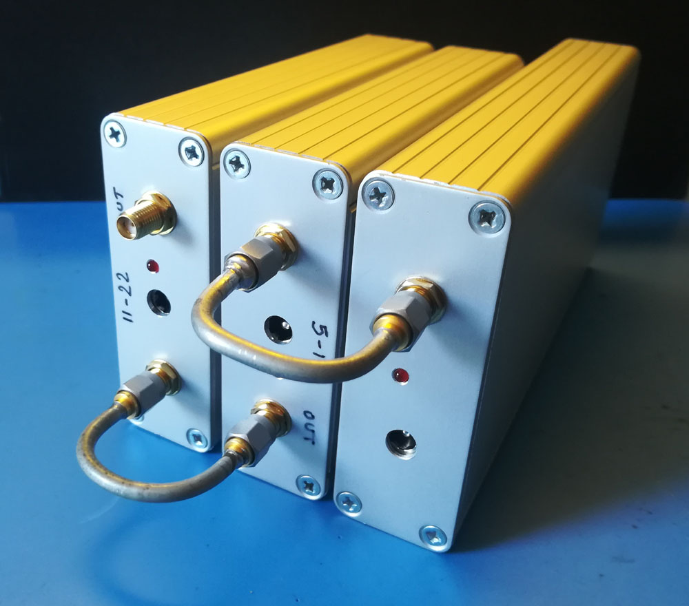

We cannot measure the phase noise in all the possible environments, we have measured them in our environment.
The measurements have been made with the devices boxed and connected as in the attached picture.
We have used RG400 SMA terminated coaxial cables.
All the devices was powered by batteries.
EMI/RFI interferences are different in different environments.
Ground loops are usually related to the whole system.
Every implementation is different from the other, so it's difficult to generalize.

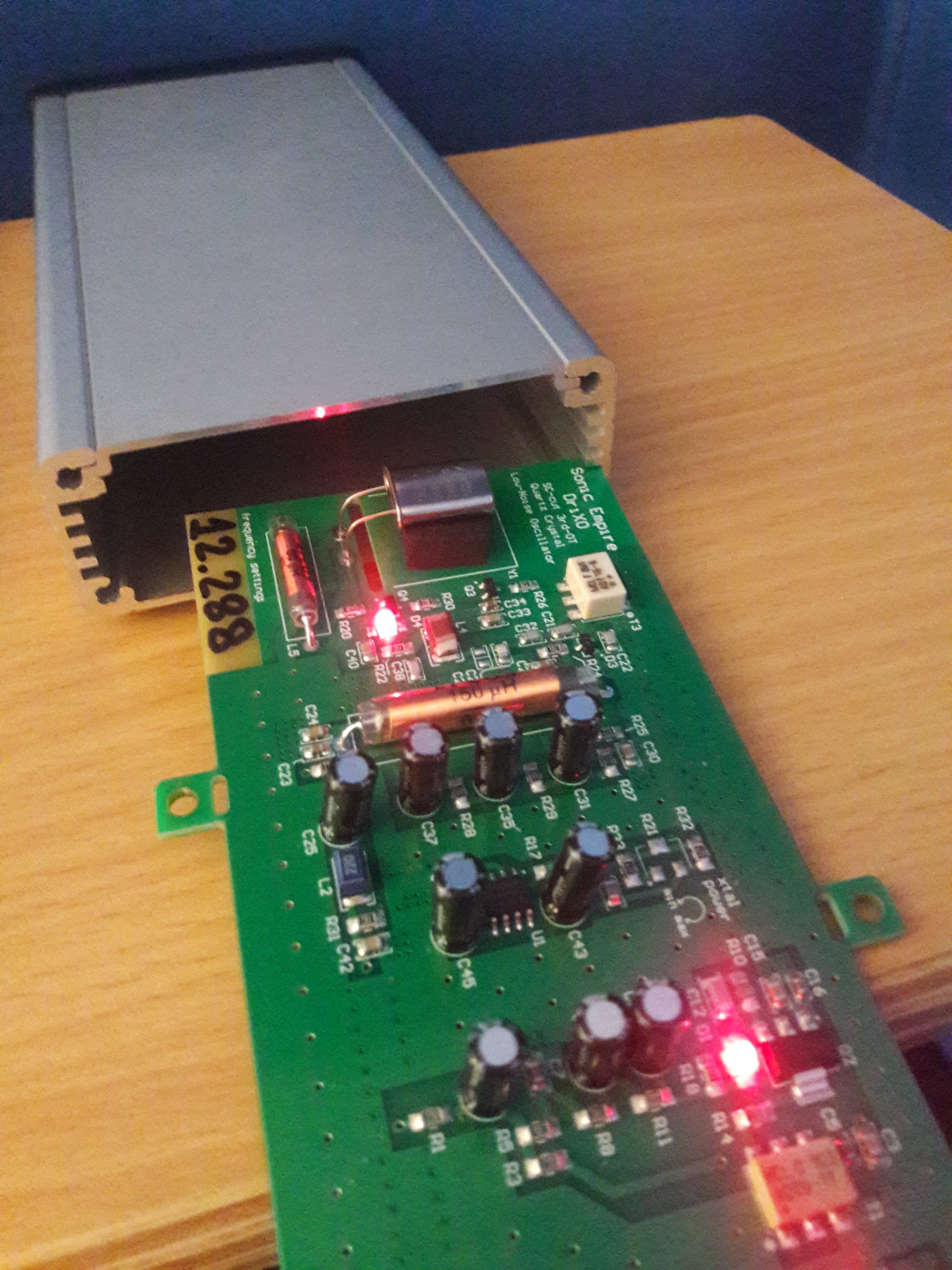

One more tip:
please don't use oscillators and frequency doublers without proper shielding, use the suggested Hammond box or whatever metal enclosure you want, but don't leave them working on air.
EMI/RFI and even moving air heavily affect the close in phase noise performance of oscillators and frequency doublers.

In order to better isolate the crystal from thermal variations and vibrations (mainly high freq ones) i have made some silicone casting of a shell that wraps snugly the HC body and then connects to the pcb via two small holes.
The silicone has a shore grade of 30 (very soft).
Silicone is a good thermal insulator and the mass added helps in smoothing vibrations out.
For low freq i have a stand solution that suspend the whole hammond box with nylon elastic band...
This is just a prototype... I have to fix some bubbling... Is a two piece mold... You can see the joining crease in the middle....![20210509_021200.jpg 20210509_021200.jpg](https://www.diyaudio.com/community/data/attachments/869/869269-e6e64efa726c3ad8a93207de1556685b.jpg)
