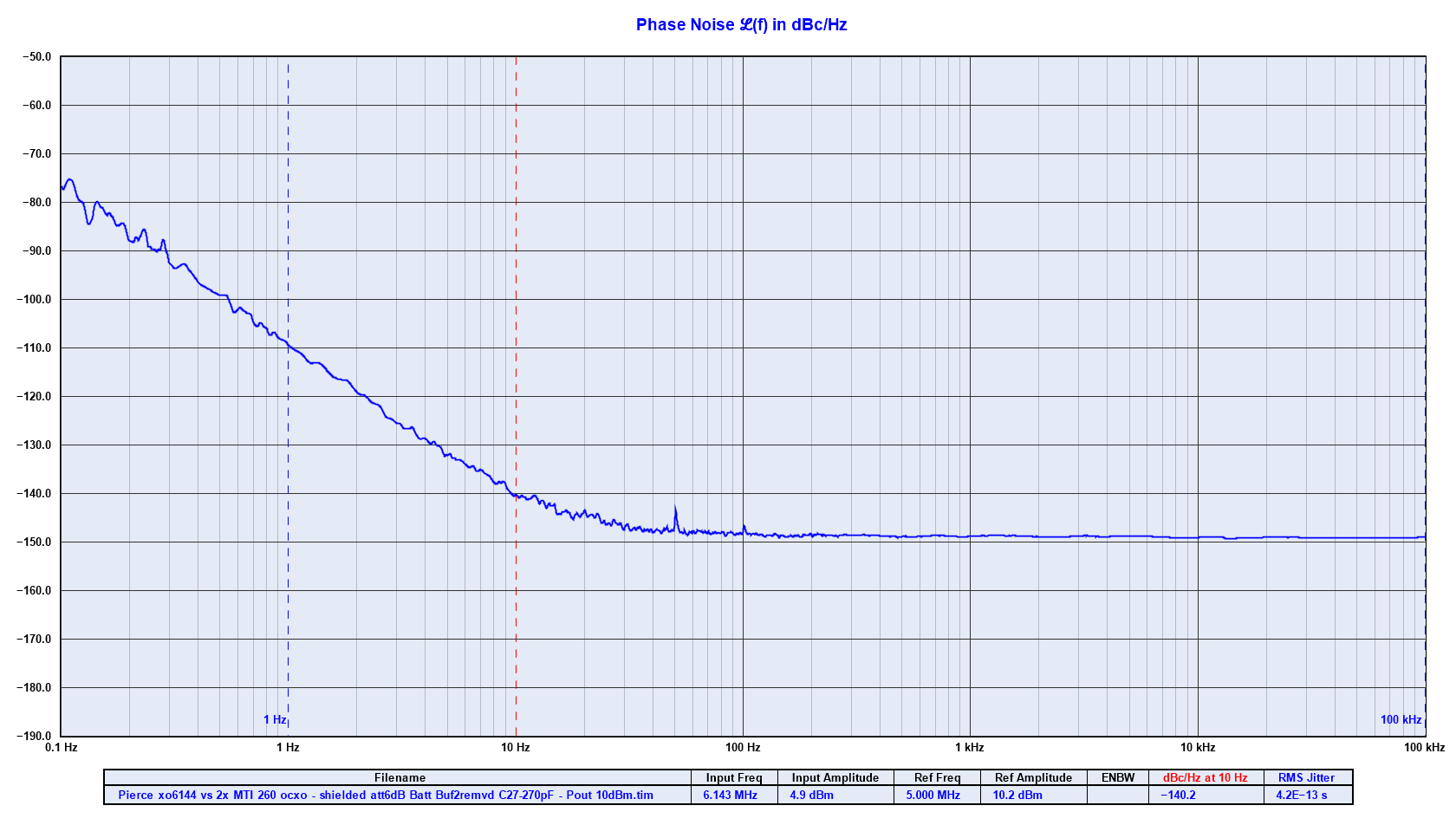

Strange, we have got good result even with a Pierce and AT-Cut crystal, this is a Pierce at 6.144MHz
Possibly air currents,, Xtal quality, I don't know enough about your oscillator to comment.

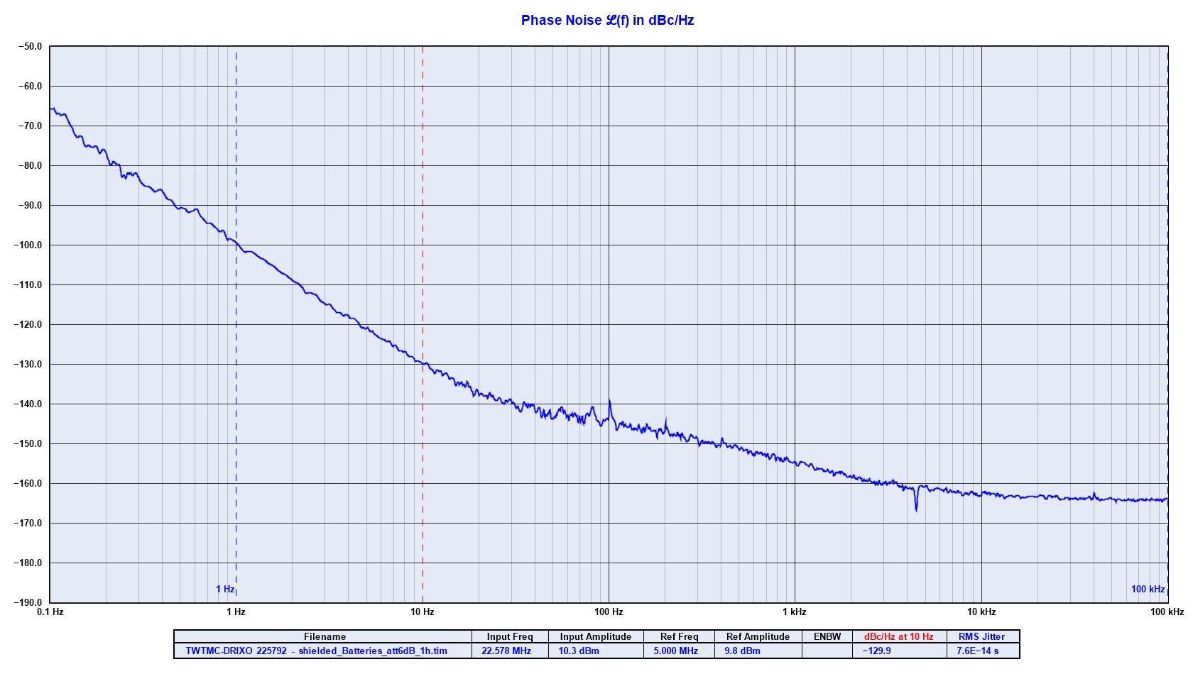

Again, I don't doubt it is good. I do wonder how good is good enough. If you are improving something, you want a baseline to compare to. You have not done that.
The music tests are merely an opinion and basically useless as proof of anything. Yes, I read the darned evaluations. You needed to correlate some measurements to actual tests to show reduced defects in the sound. Music is pretty useless for that purpose. It is good to make others feel good I guess, but falls far short of anything concrete that you should use to sell your oscillator.
I don't see you ever making measurements to see what the average oscillators performance is, or what makes a difference. You will leave that to others I guess. So I will devote my time to something that is worthwhile. Believe it or not, I was trying to help you. The information I was asking of you would have been useful to you and others. You just don't see it.

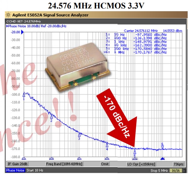

30dB better than the Crystek CCHD-957 at 10 Hz from the carrier?

That is what happens when the experiment hasn't been well designed. As he stated, it was a quick test and did not apply to this oscillator or situation. It was a proof of concept more than anything.
