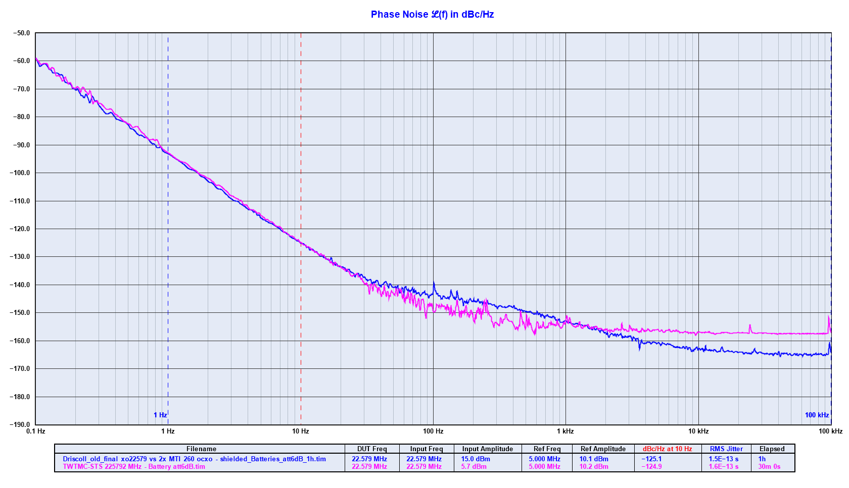

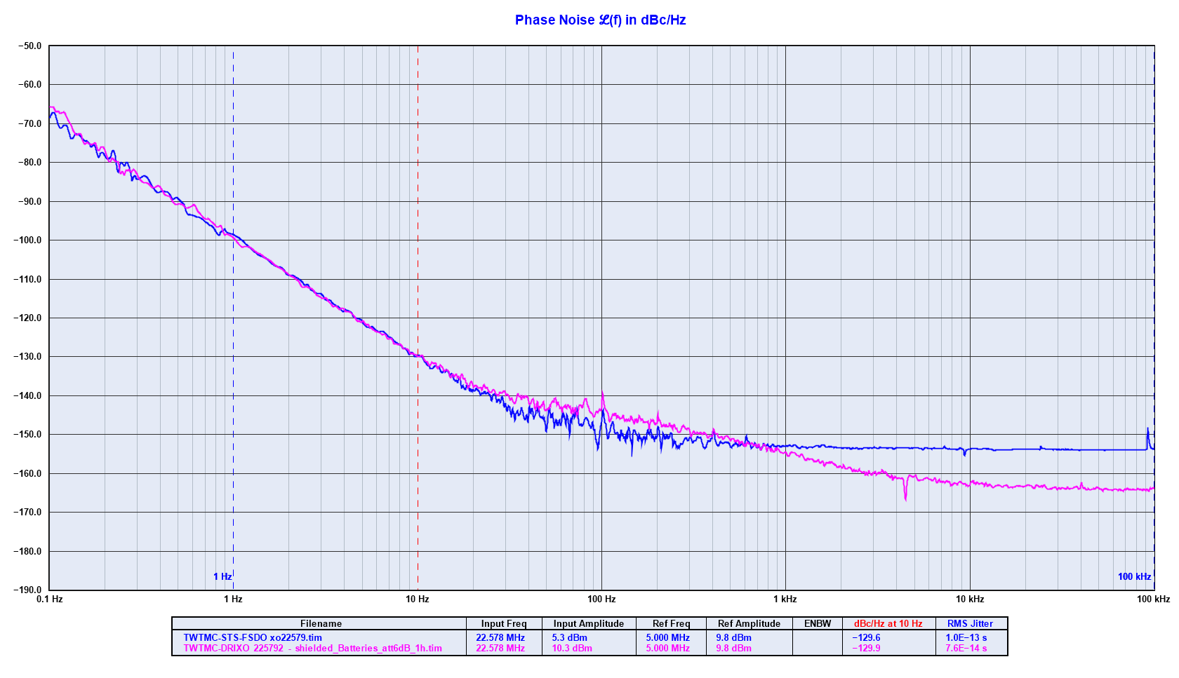

yes, we have made several measurements of the clock signal after a simple sine to square converter (using the AC04), after a sine to square converter/fanout (using the LTC6957) and BCK/LRCK signals after the FIFO buffer/reclocker.
The first plot compares the phase noise of the sine wave oscillator to the square wave output from the converter.
There is no degradation in the close in phase noise, just a negligeable noise floor is added.
The second plot compares the phase noise of the sine wave oscillator to the square wave output from the converter/fanout buffer.
Again there is no degradation in the close in phase noise, just a little noise floor is added by the LTC6957.

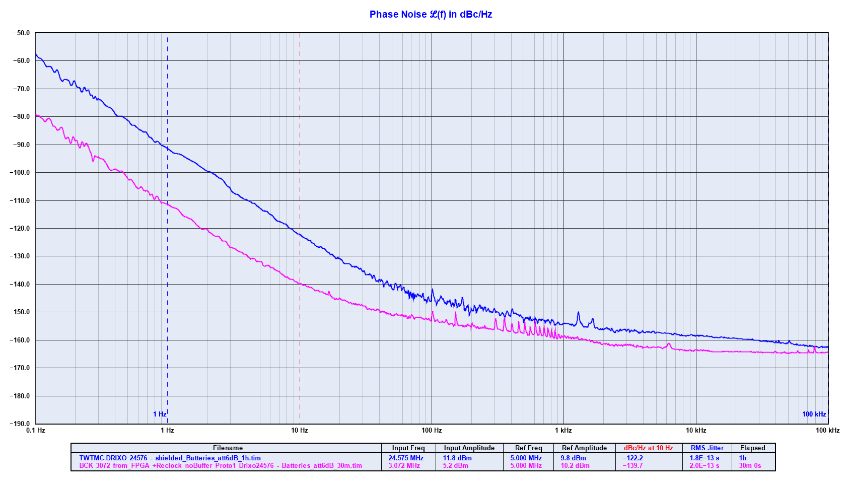

The third plot compares the phase noise of the sine wave oscillator to the BCK output from the FIFO buffer/reclocker.
The MCK was divided down by 8 so, as espected, the phase noise of the BCK is better than the one of the oscillator by several dB along all the spectrum, mostly in the close in region.

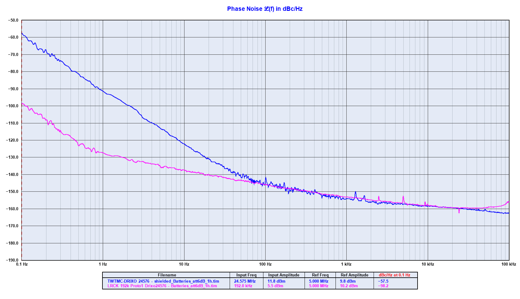

The fourth plot compares the phase noise of the sine wave oscillator to the LRCK output from the FIFO buffer.
Again, as espected, the phase noise of the LRCK is better than the one of the oscillator by several dB, mostly in the close in region. The noise floor is the same of the sine wave oscillator.
The 1/f3 noise starts below 1Hz from the carrier, where the phase noise of the LRCK is improved by 35dB, almost -130dBc at 1Hz and almost -100dBc at 0.1Hz from the carrier, that's a very good performance.
