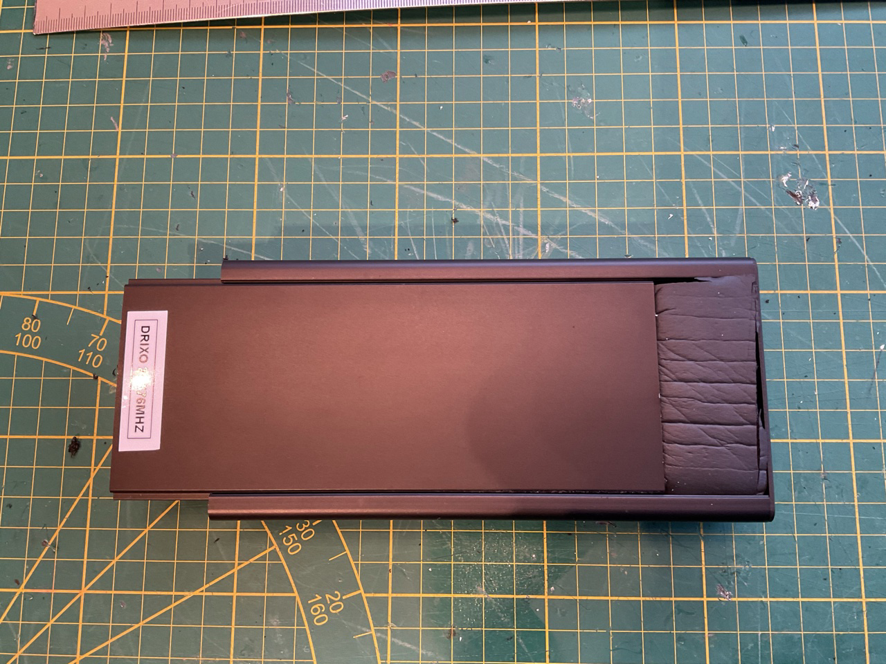

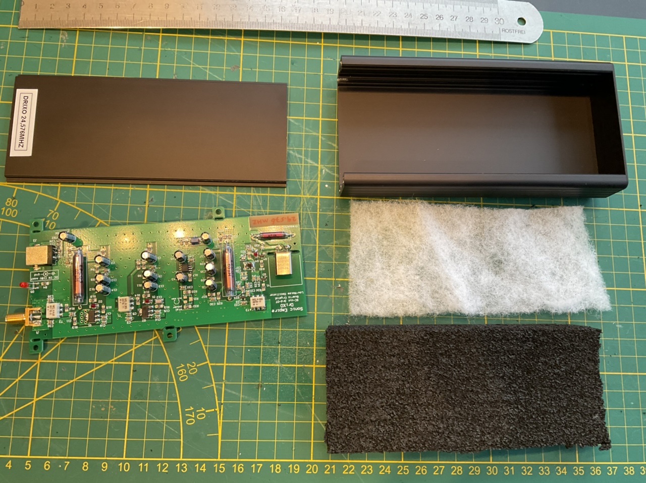

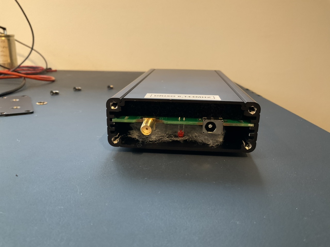

I have put some damping material in the clock units that I had left from some loudspeaker design.
Below the pcb is the black foam, on the component side I use some filter/isolation fabric as per Andrea’s proopsal.
The black foam dampens the resonance of the box very nicely. I put it on the side of the lid to keep it from resonating.

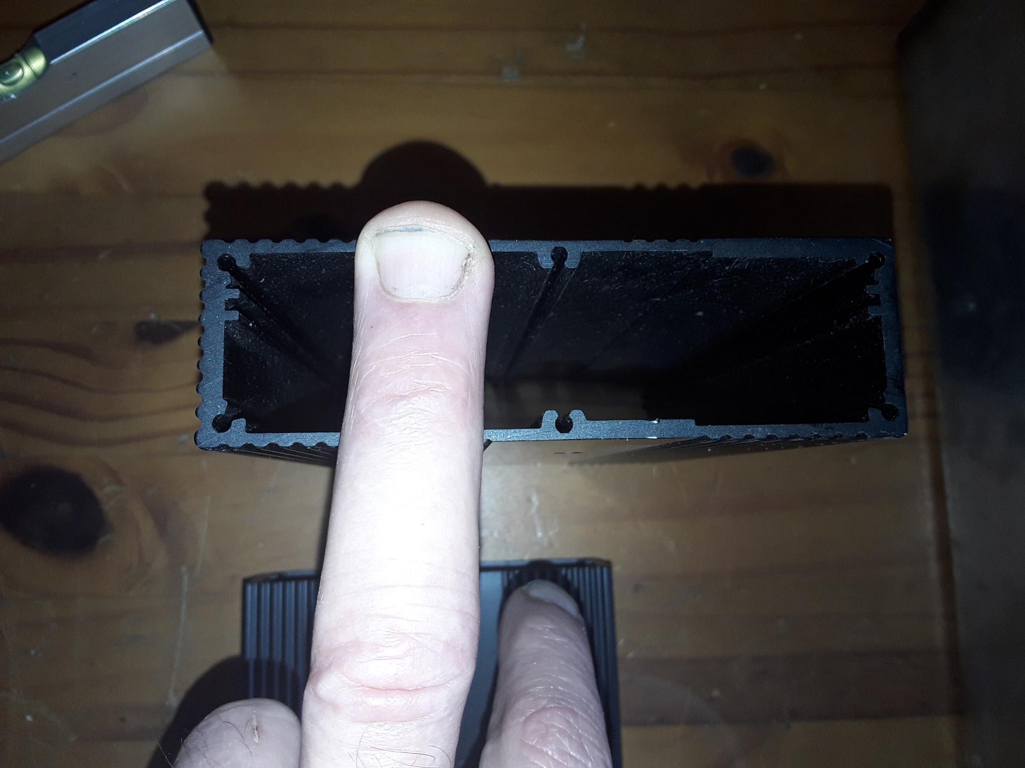

Hello,

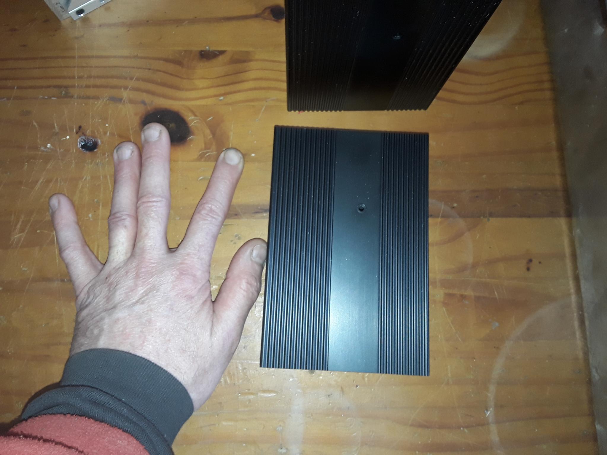

I decided to go for one piece extruded aluminium rectangular tubes. They are leftovers i took home from work instead of having them melted.Whenever there are several parts connected together chances something will " rattle " are bigger.
My clock circuits are still in Italy waiting for clocks to arrive. In the pdf the board is wrapped in a fabric or foam to keep it from wandering around.
The clock is attached with 2 leads to the circuit. The clock is the main element that has to be isolated from vibration so have it connection by two TINY wires is probably the best way to go. The board will pick up a bigger amount of vibration because of its dimensions.
Isn't a clock sensitive to vibrations because the elements inside do not consist of one " lump" like you well get by vacuum impregnation? IF so wrapping it in foam ( wanna try a cork) can isolate it from airborn vibration and also dampen the clock's little metal cover.
Attaching the foam to the circuit will probably introduce more vibration to the clock. I would rely upon the thin wires.
With just these two hairlike wires the only vibration to worry about should be the airborn or not? So should we place the 6 aluminium tubes in a sort of soundproof box.

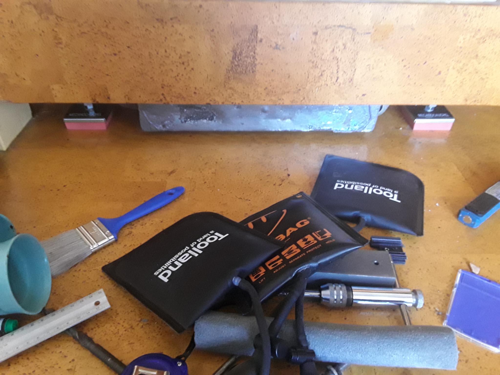

I have done some projects with double sided sand filled wooden boxes and recently added some heavy diy lead objects to my speakers. But soundproof is a different matter. Do these clocks have a frequency range that they want keep knocking? Then we could adjust the material to be used.
Any ideas are welcome. Normally i would check results with a stethoscope but for a tiny clock we need something else. Can measure isolation with my little Dayton microphone and AudioTool software.
Greetings,Eduard
