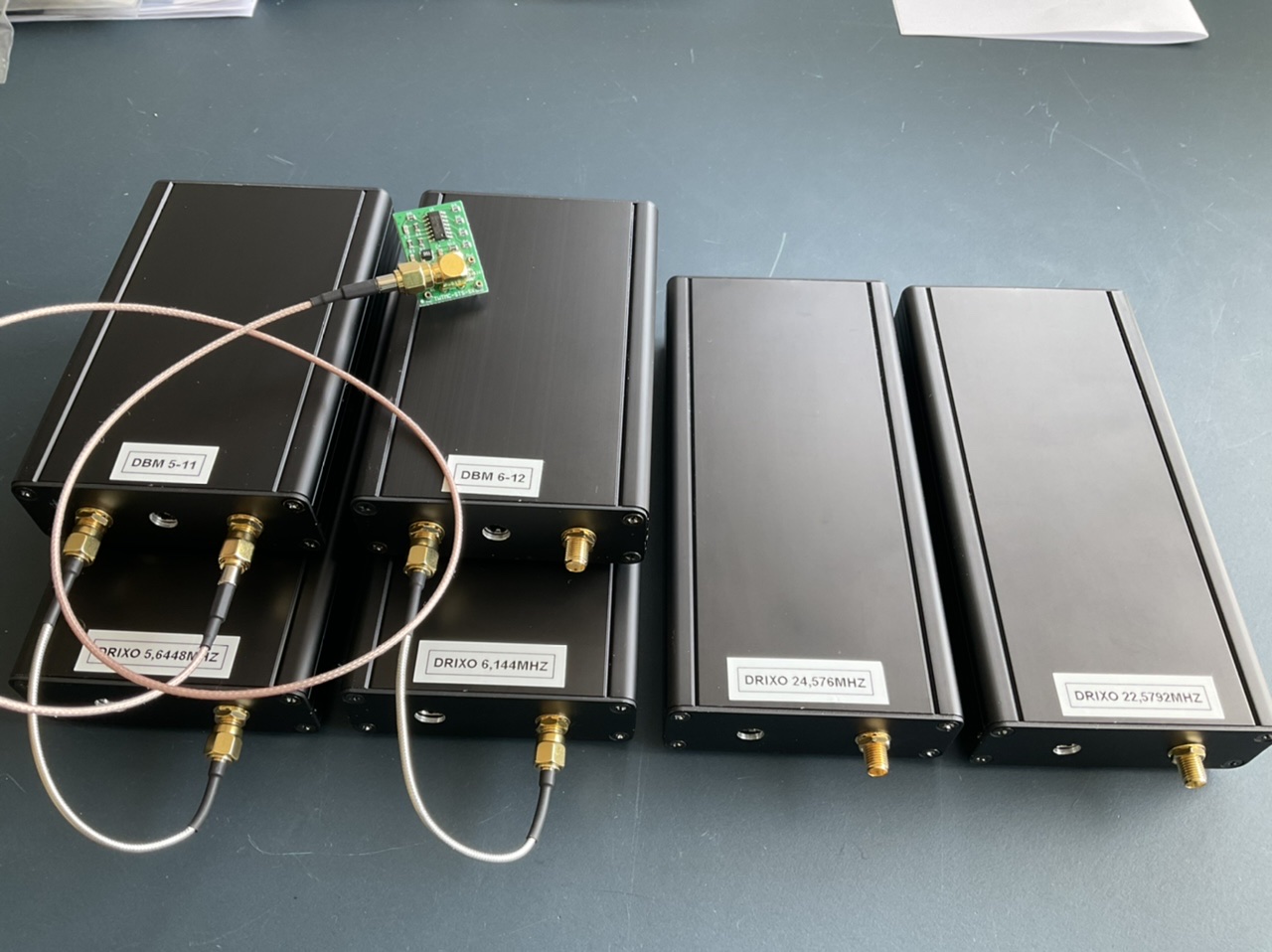

I bought this cable RG 142, with silver plate connectors.
RG142 Silver SMA MALE to SMA MALE ANGLE Coax RF Cable USA Lot | eBay

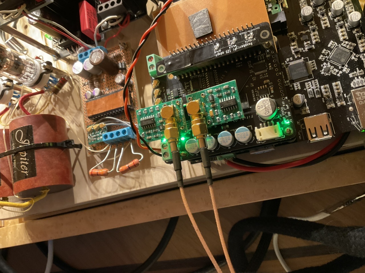

A warning for everybody that uses the fifopi.
The squarer boards are plugged onto the fifopi with some thin pins, and they are not tightly fixed. This is not an issue with crystek style clocks but it can be a problem when a cable is pulling on it.
I use semi rigid cables for the connection between clock and doubler but to the squarer I use a thinner type in order not to stress the pins too much.
It would be an even better idea to solder the squarer boards to the fifopi.

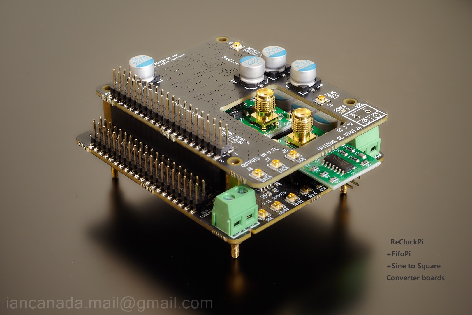

If/when you install ReclockPi, you will see they are not going to fall out. Perhaps a little insulating tape on top of the squarer PCB will be a good idea. When they raise up from FIFOPi they will soon hit the bottom side of ReclockPi meaning IC to IC contact. Likely no issue but some Kapton tape or thick paper will work well. Then a good idea to have some stress relief on the RC cable. I use a wood chassis & connect the RC cable to the side of the chassis so if there is a tug on the cable it won't pull the FIFO stack.

The right angle SMA works well to avoid stress. I installed one and from that perspective it works well. Again if you are going with ReclockPi, that can be tricky. I use only one clock so I pointed it toward the front of FIFO so there is room for the connector. The cable just clears the pcb mount, then secure the cable mechanically to isolate the FIFO stack from stress if there is a tug on the cable. Another way that works very well which I am using until final cables arrive is a U.FL terminated RF patch cable. They have a right angle U.FL on the end that attaches to the squarer pcb and whatever SMA you want on the other. These are used commercially to provide the SMA outlet on the chassis and connect to the PCB. Works great and there is no stress and fits neatly under ReclockPi. I simply soldered both a U.FL connector and the right angle SMA onto the squarer to provide both connection alternatives.

Nice looking DAC eduard. With the 4x DDDAC and the FIFO stack it is a pretty serious looking setup.
Looking back at the FIFO/RCP stack with straight SMA installed, a right angle terminated cable or a right angle connector to a straight ended cable will clear the RCP nicely. Only my right angle SMA soldered to the squarer will have clearance issues.

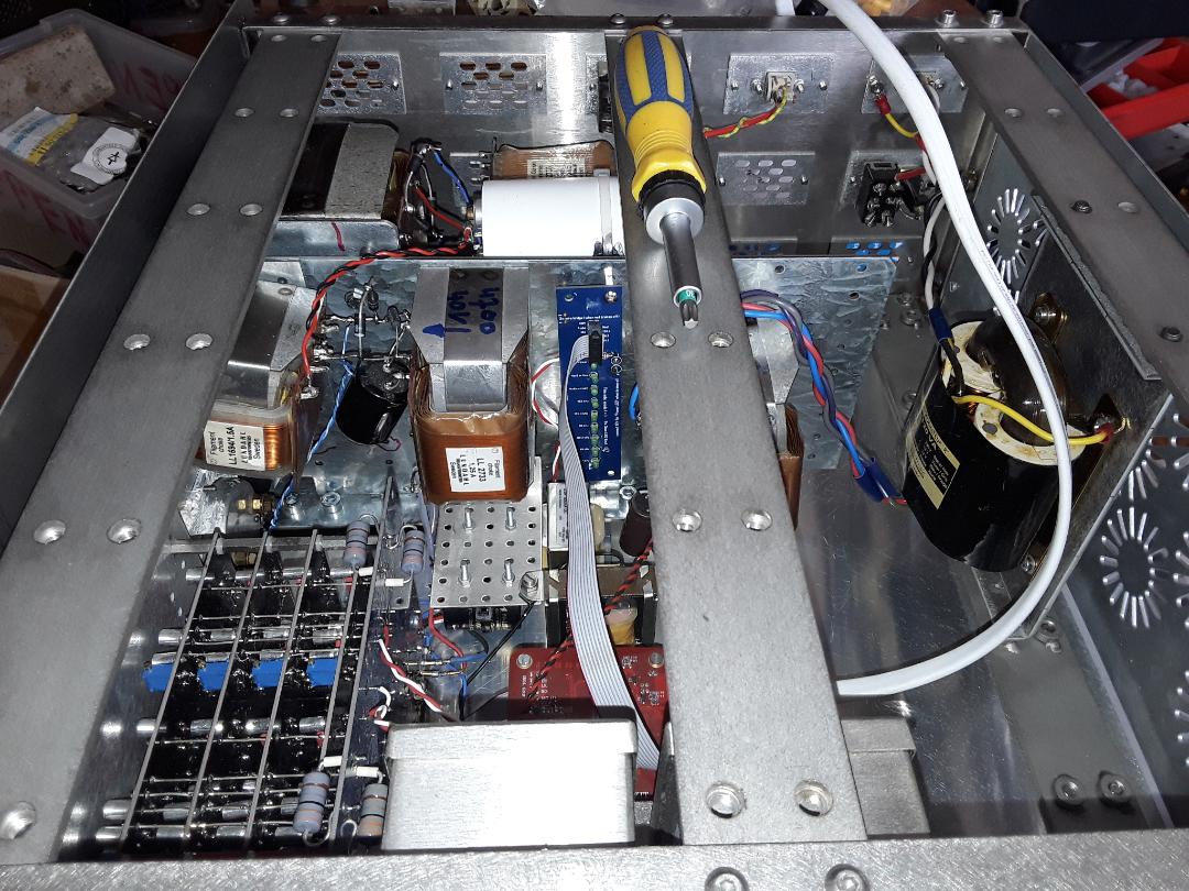

Hello,
After removing the wave IO
It will be easy to install the stationpi pcb kit with the i2S output facing the DDDAC board.
IF the 90 degrees angled touch or nearly touch the Reclockpi it is NOT a good idea to use them. I remember asking Ian if the STS boards from Italy and his reclockpi will fit together after that he added a new photo.

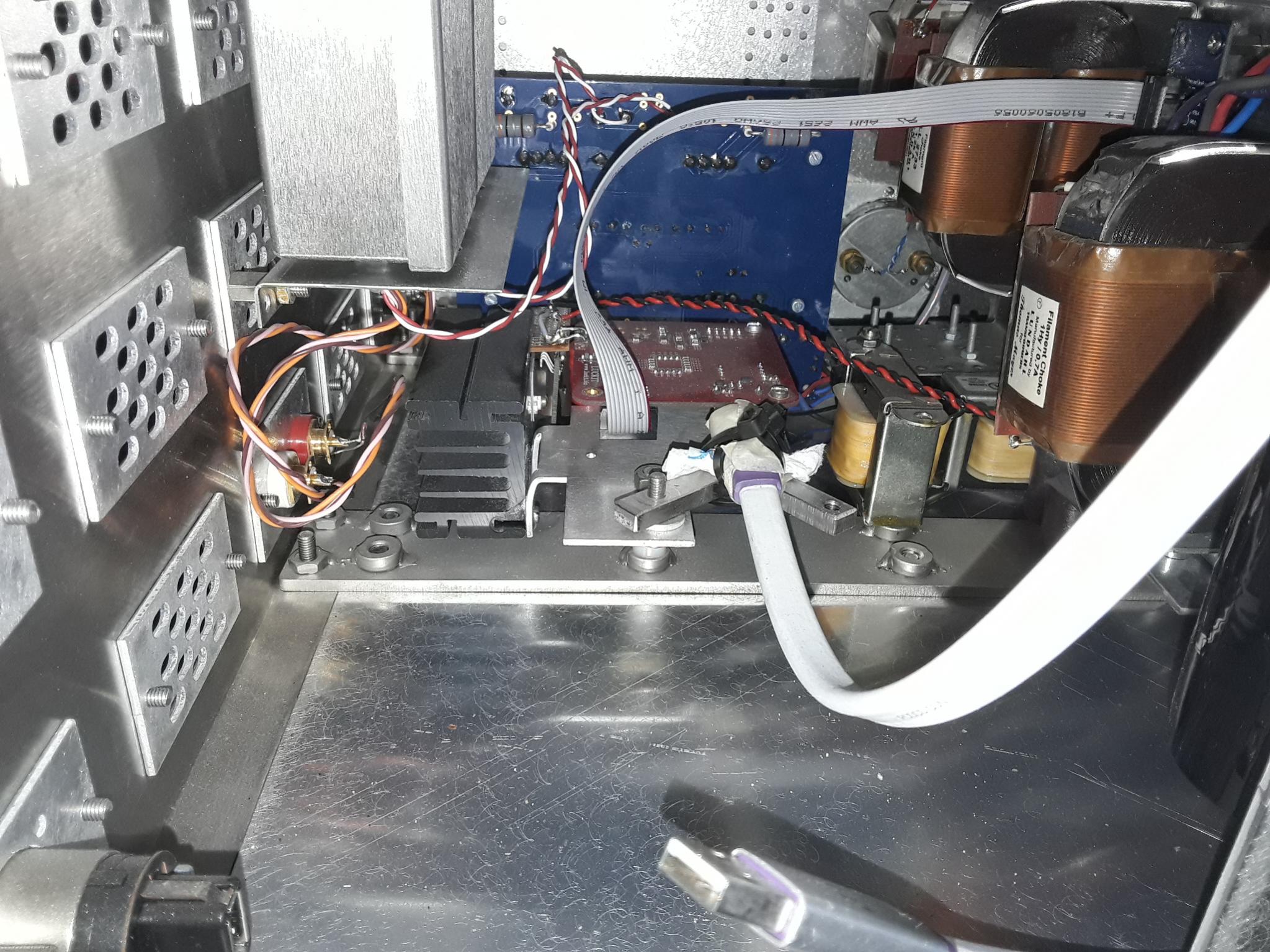

The DDDAC circuit is right behind the front plate so if the two RG400 go straight up i can guide them outside through the rectangular holes that are '' everywhere '' on the side panels. Can them have a nice curve before going outside to the 6 board clock factory.
I think there the 90 degree angled connectors can safe some space. . Probably i will slide the clock board deeper inside so one will be straight angled.
Long time ago there was a publication about a vibration killing support using copper sponge material in France. If the aluminium housings can touch each other (i think they can if the circuit is wrapped in foam before sliding inside) this material works very well.
Greetings, Eduard
