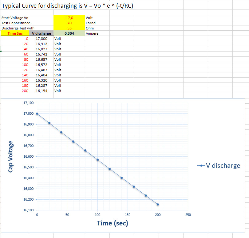

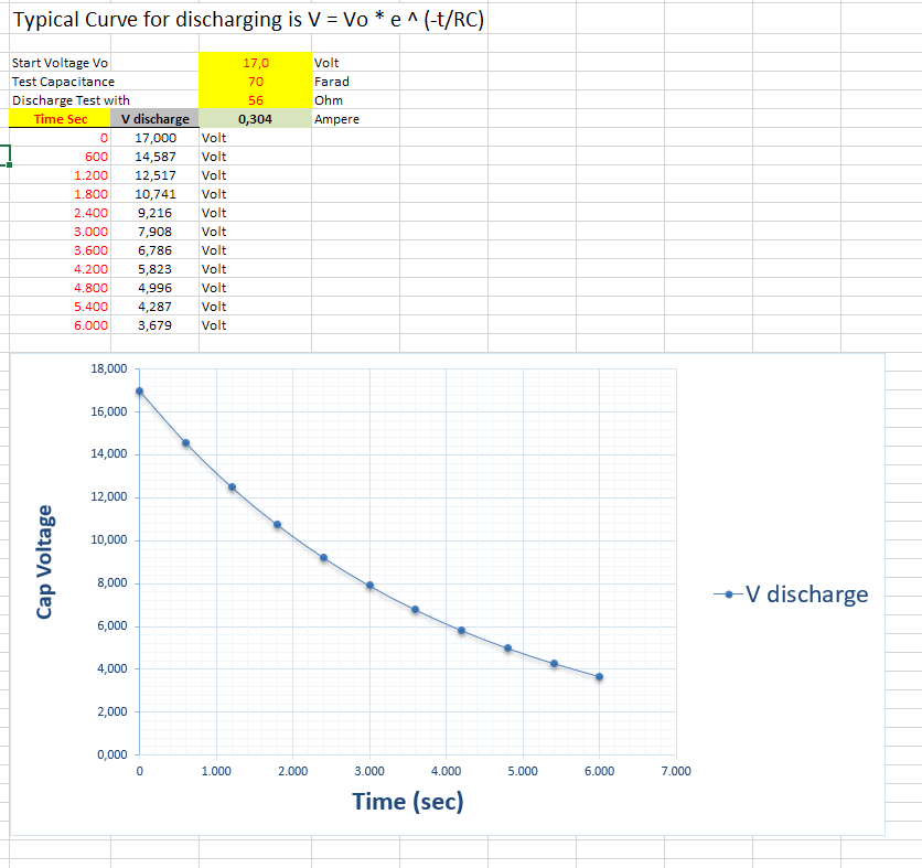

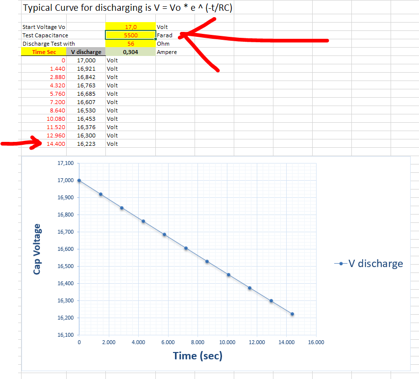

BUT if two super caps can play for 4 Hours and in that go down from 17 to 16,2 volts and then be " recharged " up to 17 volts again in a short time.
Greetings, Eduard
no way... Physics is not supporting this
![scratch2 :scratch2: :scratch2:](https://files.diyaudio.com/forums/images/smilies/scratch2.gif)
assumed 300mA current for discharge by the way
The 70F caps will be long gone empty after hours.
your idea from 17 to 16,2 will take 200 seconds for 70F
meaning for 4 hours you need a 5500F cap (~80 in parallel of the Eaton one)
To "quickly" charge this mega bank back from 16.2 to 17 (1 minute?) you would need a power supply delivering ~70A(forget the cabling for a moment)

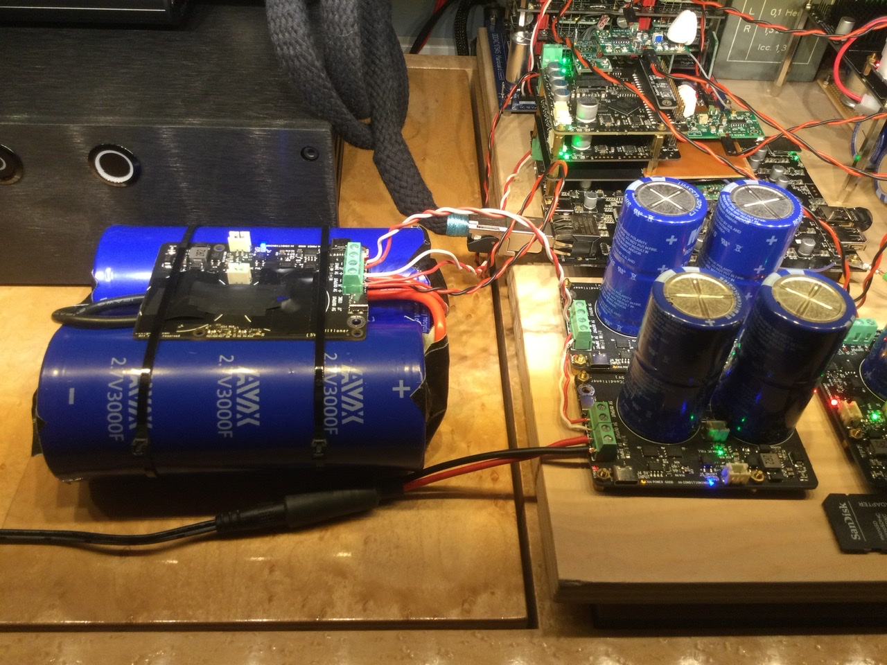

I tried the 3000F caps. Doing well but not very practical with the very lage size. Minor improvement in comparison to the 325F versions. Both are used with UcConditioner pcb so are constantly powered.
I think there is more to benefit with focus on other details. Battery supply for clocks is very good, no need to go over the top.

did you put three UC banks in series?
Ah, you noticed
Yes, this was only for a test. Is was even powered with an Allo Shanti that also has ultracaps in the output stage
