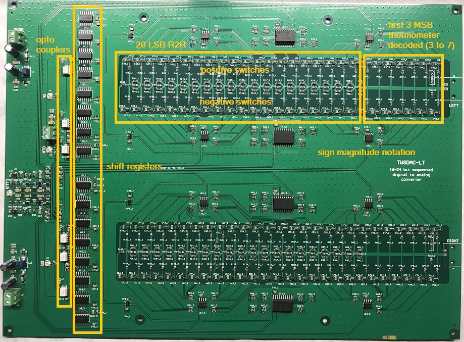

I attach a picture of the DAC Lite prototype.
It's a 24 bit 192kHz DAC (384 kHz to be tested).
It implements sign magnitude notation so the MSB does not switch during zero crossing.
It uses a segmented architecture, the first 3 MSB are thermometer decoded (in order to lower the glitch) while the other 20 bit are R2R decoded.
It's a voltage output DAC so it does not need a I to V conversion stage, although a buffer is recommended.
It uses a custom protocol and when used with the FIFO Lite the ladder resistor network can be digitally calibrated to reach the best linearity up to 22-23th bit.
It works with stopped clock in order to avoide any interference from the BCK during the word transiction.
The dirty signals like DATA and BCK are optically isolated from the DAC to avoid interference with the crucial LRCK signal.
It runs up to 24 bit/192 kHz with 5.6448 MHz and 6.144 MHz clocks.
It needs +/- 3V3 clean power supply, battery suggested.

The positive and the negative references voltage could be a little different, to be measured if the distortion will be negligeable.
Usually we don't like to design for the lowest THD but if it will be too high we add a tracking regulator after the battery.
We will also try LTO battery.
