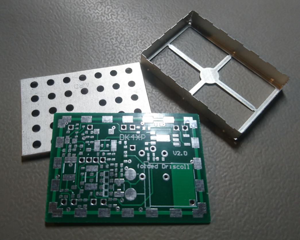

Recalculating the components value to get the Driscoll oscillator working at 10 MHz is not a problem, but the MOQ for the crystal required by the manufacturer is at least 10 pcs.
I hope there will be enough applicants.

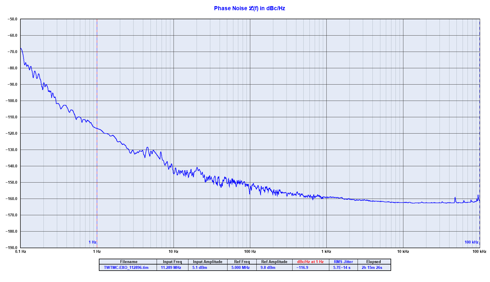

There is a big price difference, but what about the difference in the parameters of the two devices?
The difference is that the Gustard C18 is an OCXO so it implements a oven, while our oscillators does not implement the oven.
This means that the Gustard has better long term stability than our oscillators but usually long term stability does not matter in digital audio.
The most important feauture for audio application is the short term stability.
I have not found any phase noise plot of the Gustard C18 Audio Clock, they claim -110dBc at 1Hz from the carrier.
Although we have not yet built a 10 MHz oscillator you can assume a phase noise similar to the 11.2896 MHz one.
Both TWTMC-DRIXO and TWTMC-EXO perform 6dB better at 1Hz from the carrier than the Gustard (-116dBc and -116.9dBc).

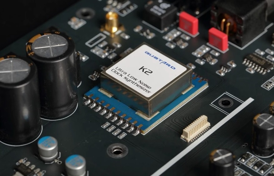

Or I cant find what C18 is meant to be paired with, maybe not a DAC?
If the C18 was designed to be used with the X26 PRO DAC then this DAC uses a PLL.
"The master clock of the ES9038PRO decoder chip built in X26pro is also controlled by the K2 high-precision lock synthesizer, which directly works in super-synchronous mode to synchronize ASRC re-sampling, and USB IIS AES coaxial optical fiber Bluetooth can also enjoy the improvement brought by local femtosecond or external 10M clock."
It looks like the ESS DAC chip works in true sync mode (internal DPLL bypassed) so the PLL has been implemented externally, so called K2.
"Tech Inside X26 PRO
X26 PRO uses a custom built high-quality femto-second clock generator which is integrated into a jitter reduction architecture. It does not require any Asynchronous Sample Rate Conversion solution to achieve this. Instead of going with an off-the-shelf, but high-quality crystal clock as Crystek and Accusilicon, Gustard designed their own Ultra-Low Noise PLL clock that is called K2."
