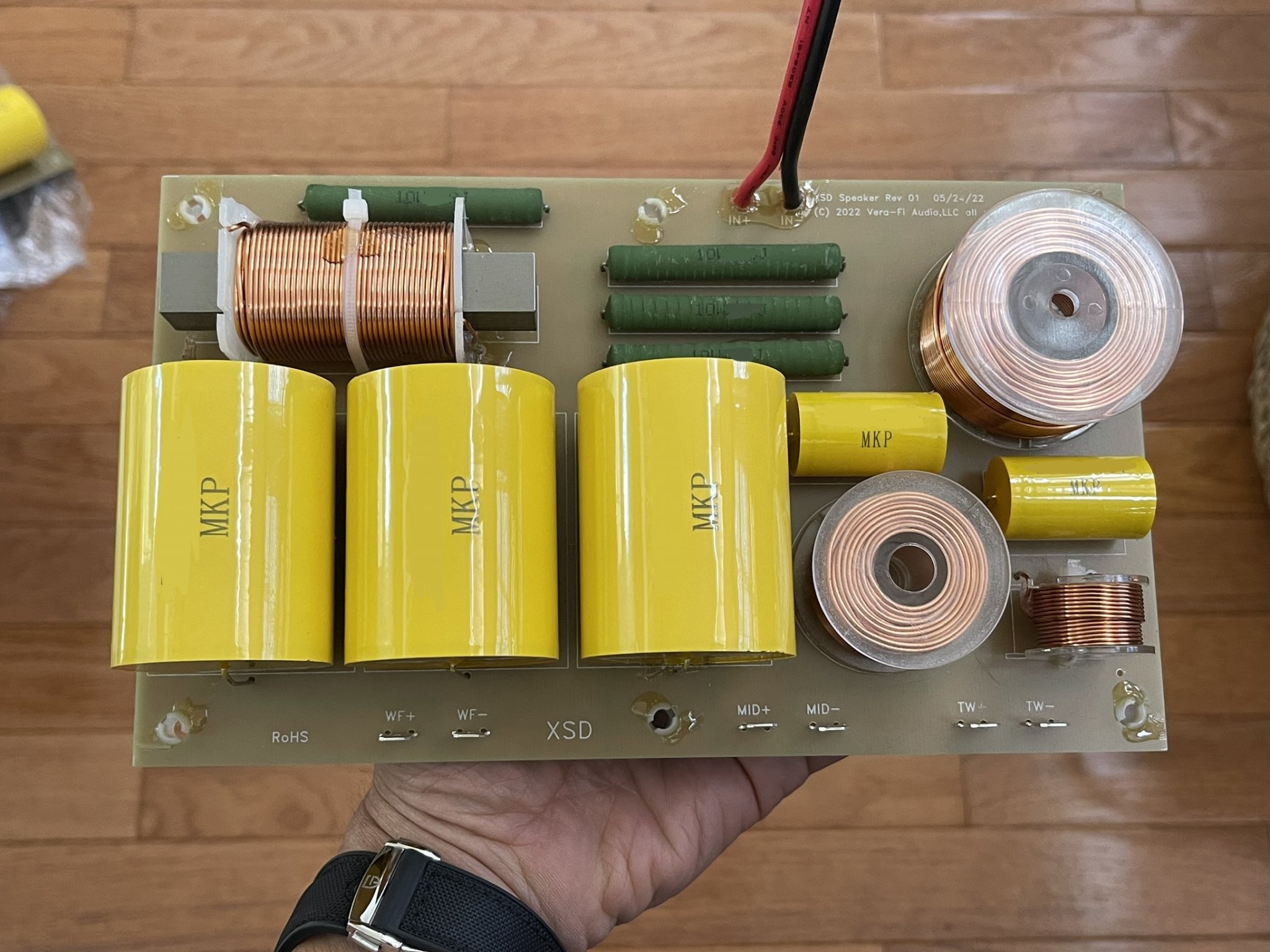

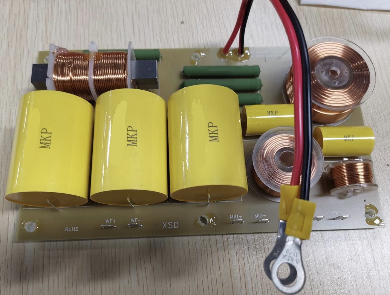

The pre-production sample crossovers for the XSD just got made. I should be receiving them soon. I might have to rotate the middle air core coil 90 deg on its edge to make all three axis orthogonal to avoid crosstalk. It might not be a big deal as the two larger ones are on the same driver (mid range). The iron core is far enough away I think. A high quality all MKP film cap solution though. This XO board is pretty big at 220mm x 130mm. Perfect size for the “back porch” of the speaker though.
Will the crossover be open, as in your prototype, or will it be sealed inside the cabinet?The pre-production sample crossovers for the XSD just got made. I should be receiving them soon. I might have to rotate the middle air core coil 90 deg on its edge to make all three axis orthogonal to avoid crosstalk. It might not be a big deal as the two larger ones are on the same driver (mid range). The iron core is far enough away I think. A high quality all MKP film cap solution though. This XO board is pretty big at 220mm x 130mm. Perfect size for the “back porch” of the speaker though.

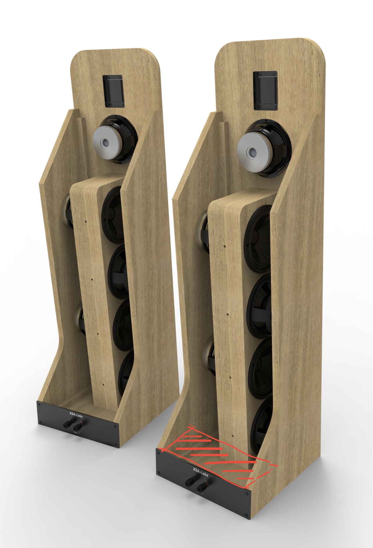

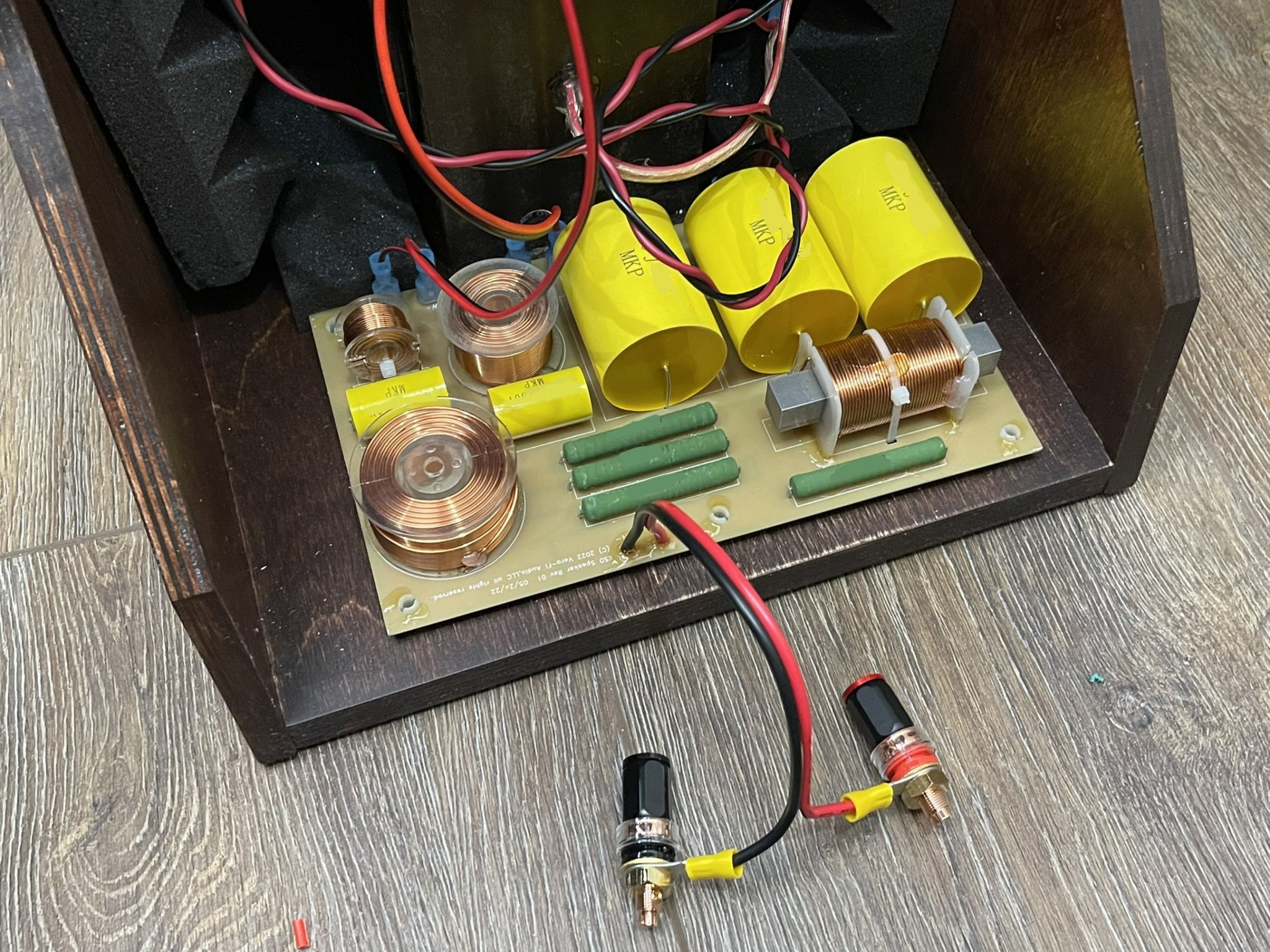

It’s going to be located in the space on the base I call the “back porch” and covered with a piece of tinted plexiglas held on with screws. It is open otherwise for the wires to come from the 3 pairs of Faston spades up to the drivers. The cover will go approximately where I have the red crosshatched sketch here. I will have a machined aluminum plate with the binding posts (8mm solid copper threaded shaft) that connect to the M8 loop crimped speaker input wires (14ga).
