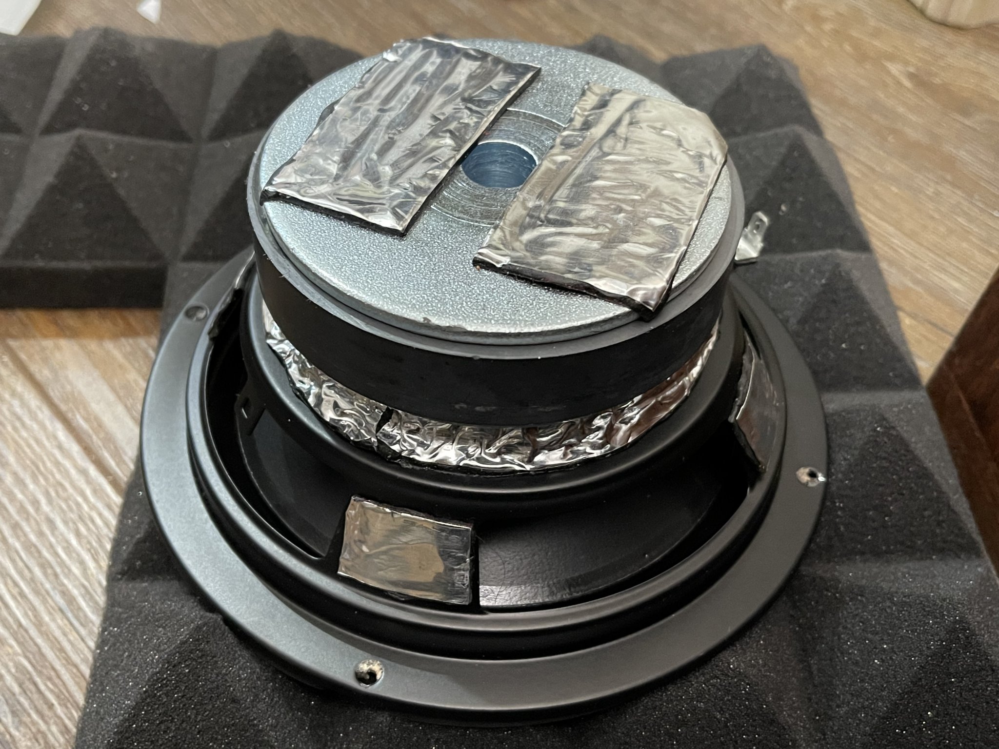

I got a question from Bryguy on how to do the Noico on the driver baskets. Basically a small rectangle on each leg and a long strip around the interface of the basket and magnet assembly. Push it all down with a blunt object so that the sticky rubber adheres to the basket and magnet assembly. I don’t think the strips on the back of the magnet are needed but I put some there just for insurance.

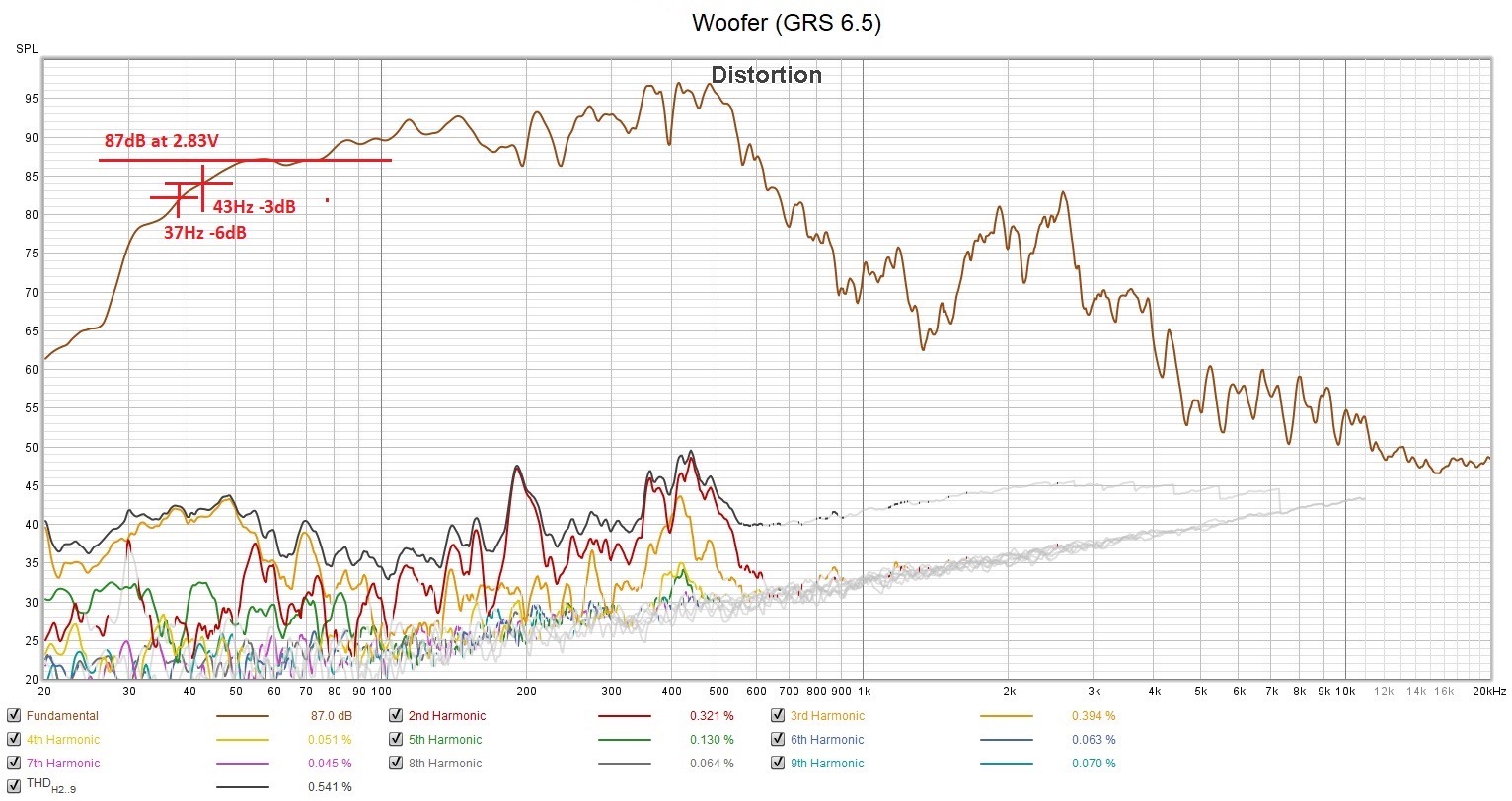

You can test the efficacy by tapping on the basket before and after. The distortion spectrum shows a marked decrease in the 200Hz region after it is applied.

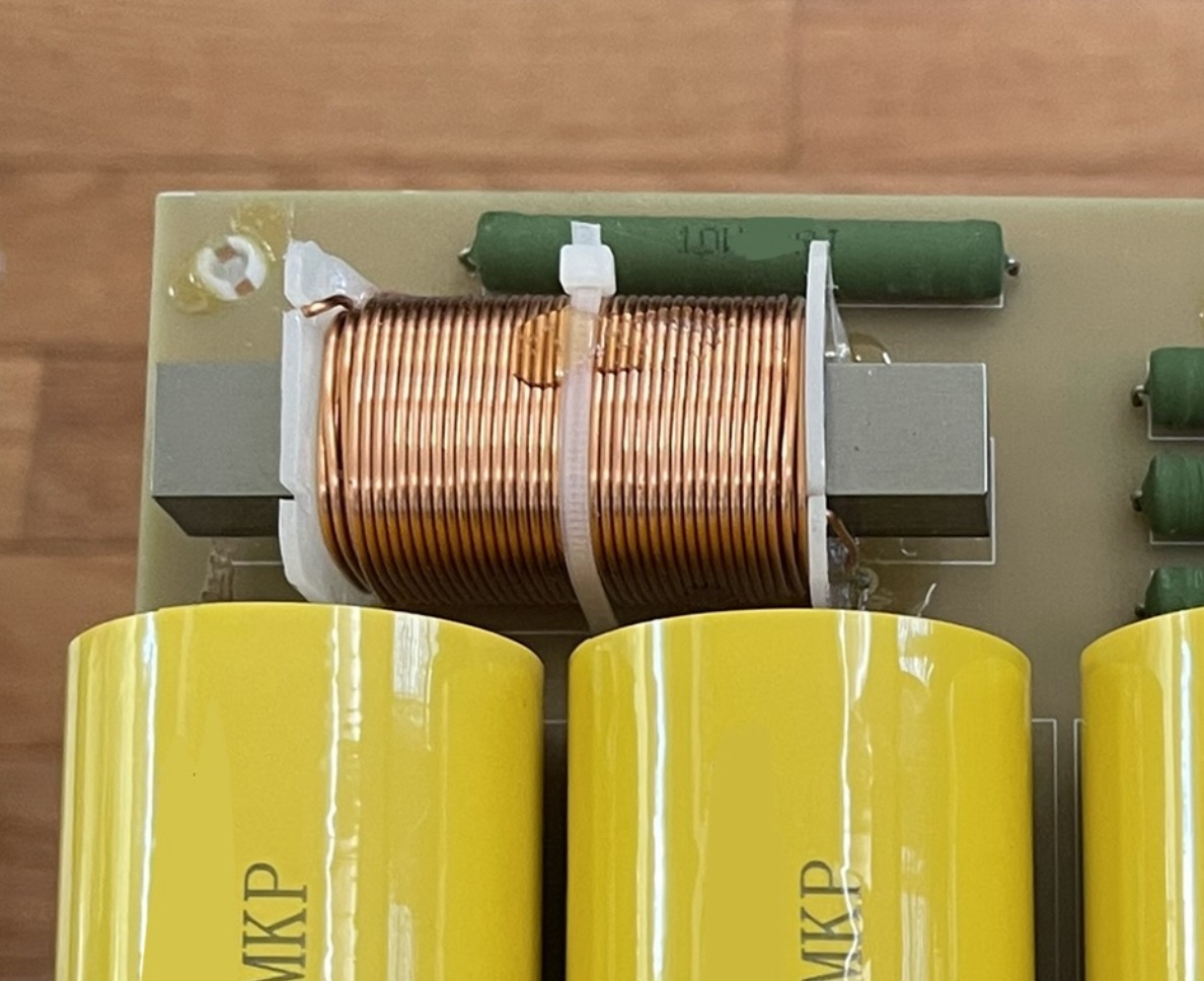

Also, the iron core inductors are being custom made for the XSD crossover GB and should be shipping by this Monday. They will look like the same ones from the production crossovers:
