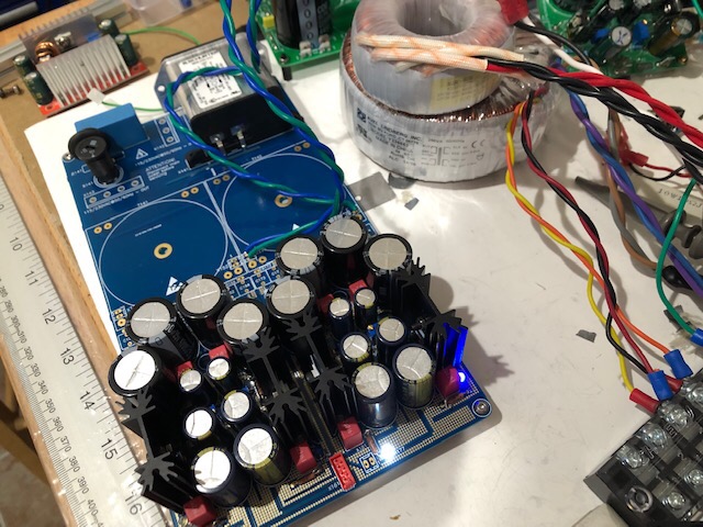

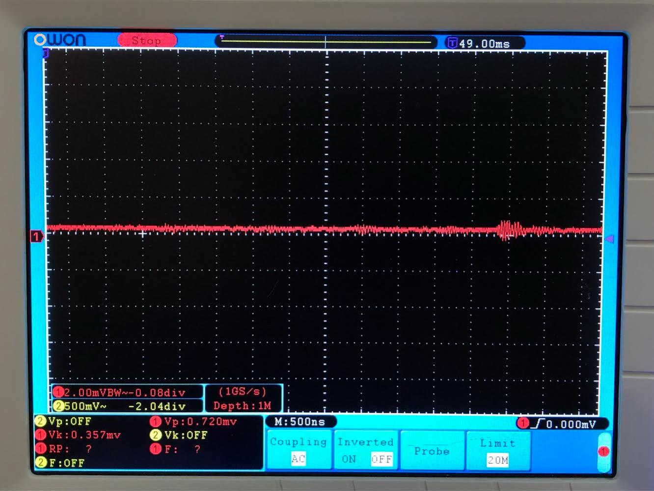

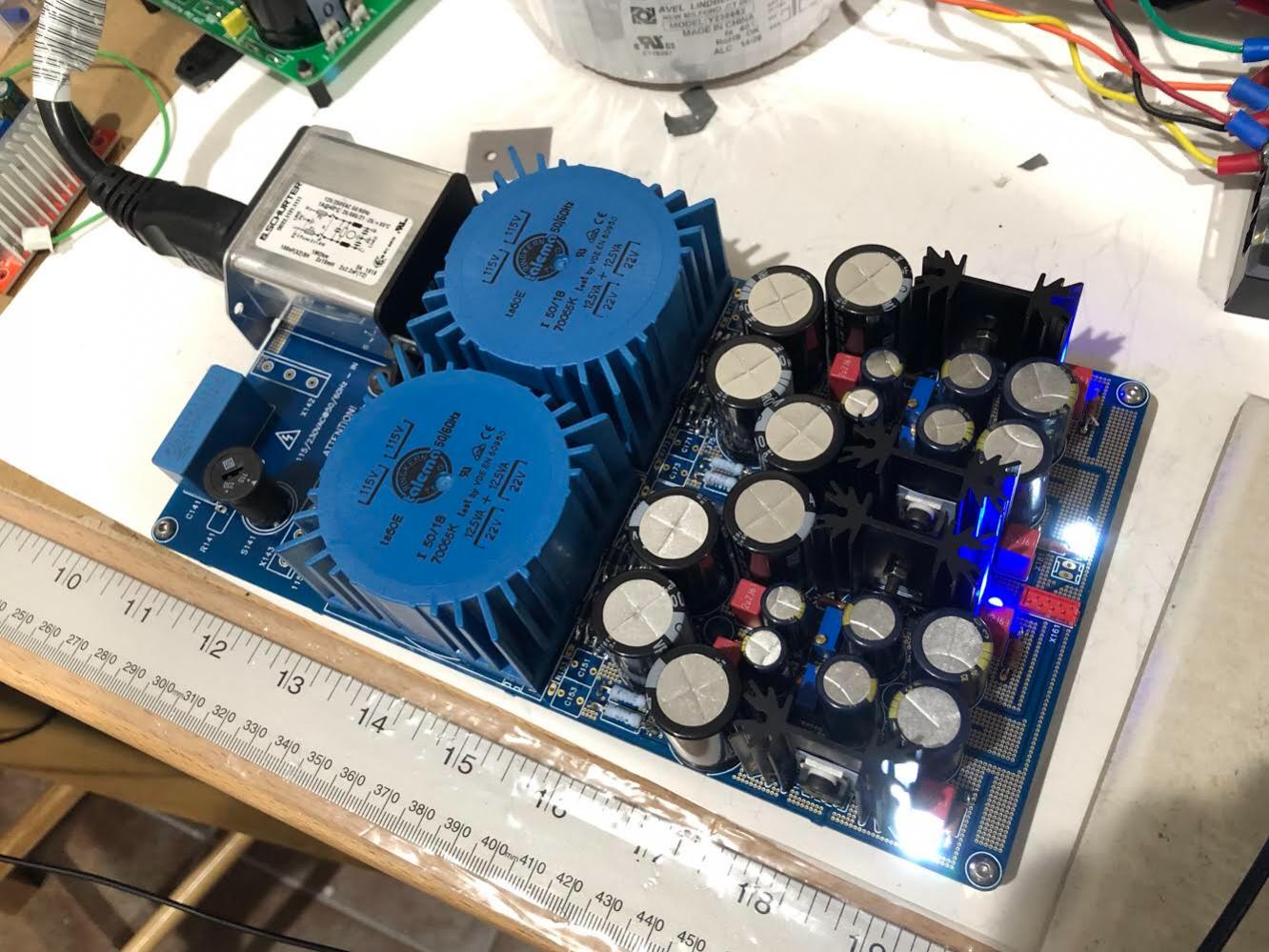

PSU tested with Talema 25VA 22v Talema’s. Excellent low noise performance. Using 600 ohm dummy load for 93 mA current at +/-28v rails. Noise is less than 400uV rms as observed on oscope.

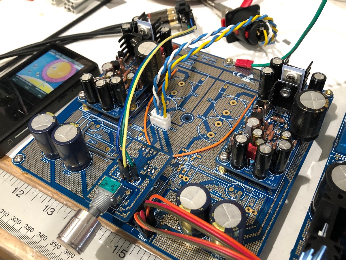

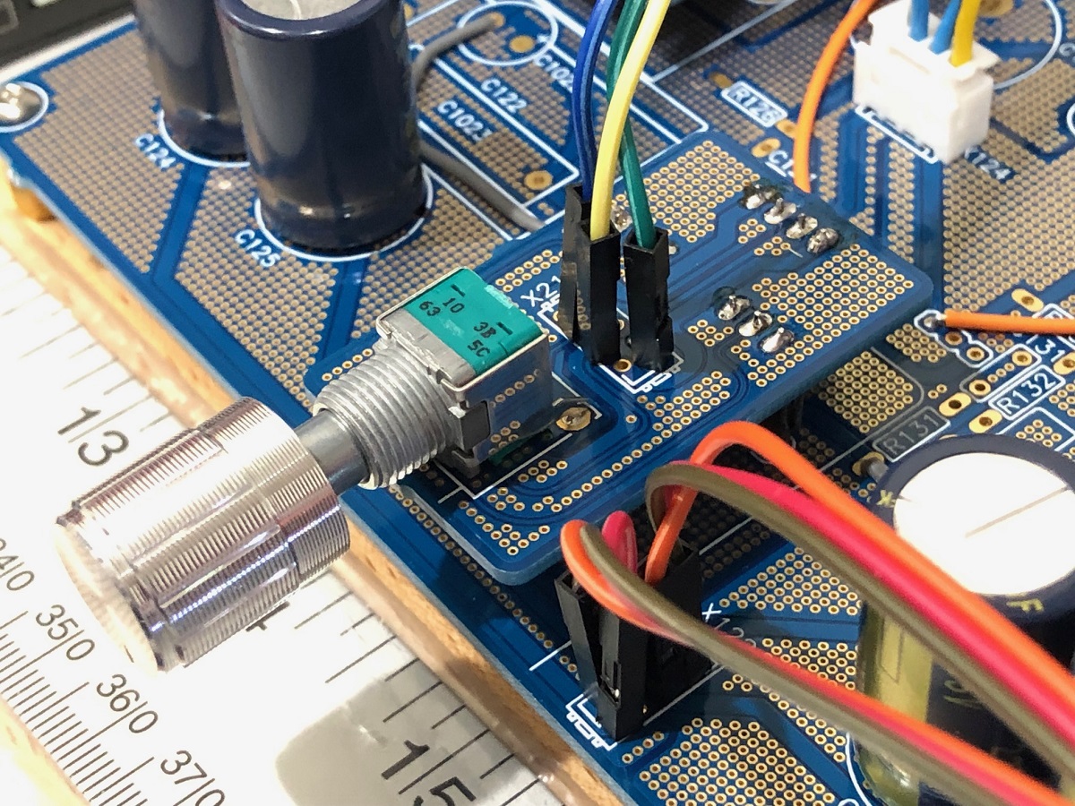

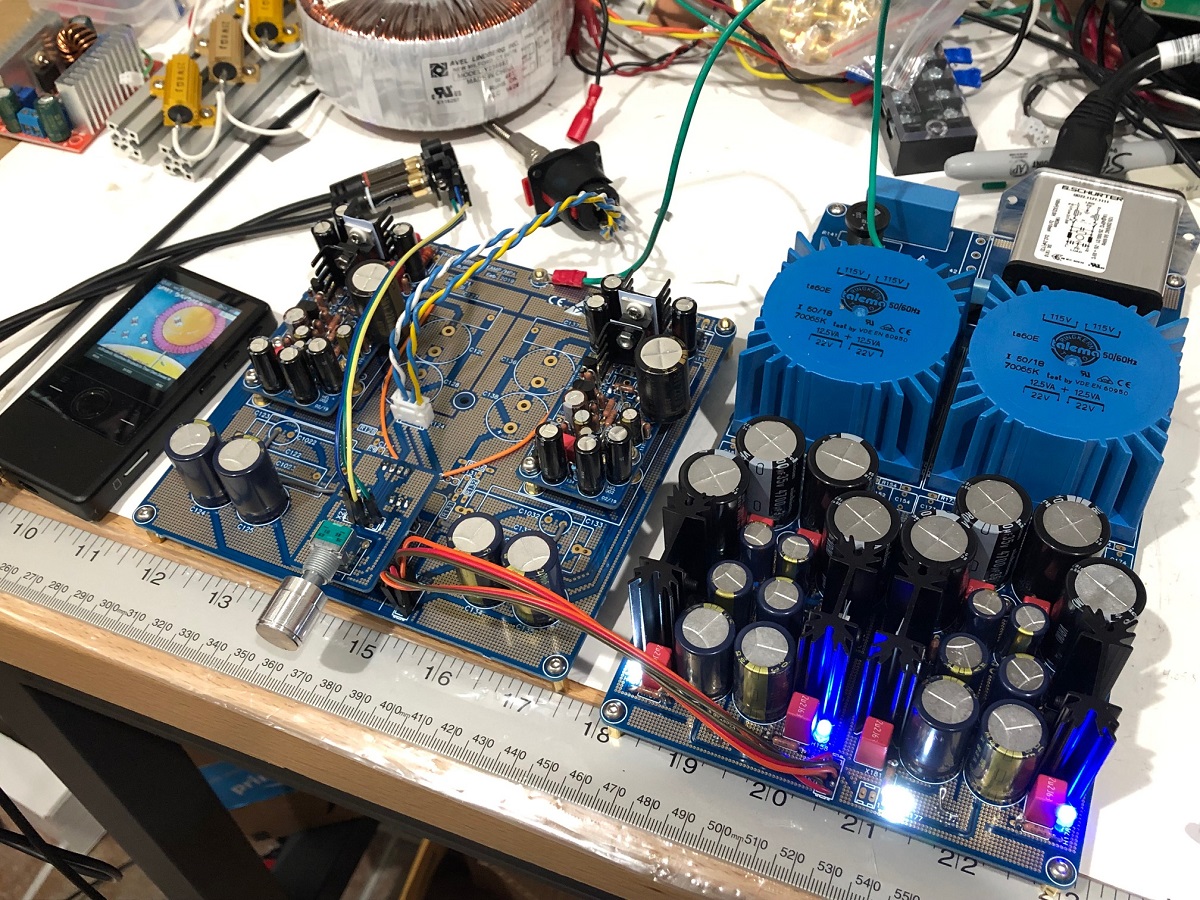

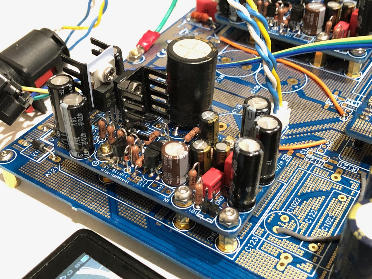

Yarra PCB Successfully Verified
I hooked up a bare bones Yarra motherboard to the PSU with flying leads to test things out. Since my Melbourne is running as a complete stand-alone core, no coupling caps or filters are needed on Yarra and hence jumpers are used. PSU is running +/-29Vdc rails and bias current is 42mA. Wit the current 22V Talema at 42mA, the minimum voltage is about 28.5v. I am running as a headphone amp and listening to the Yarra with OB-1 55ohm impedance phones. Even with only a 220uF output coupling cap, the bass is very good. I am surprised how powerful it sounds for having only 42mA of bias current. The 55Vpp output capability is interesting.
The sound is wonderful - typical Aksa Lender: engaging, clear, natural, with super stereo separation and imaging.
The board is a pleasure to work on - JPS64 did a superb job, as usual.
In looking at how JPS64 laid out the optional HPA or Line-Out selection using an on-board PCB header pin jumper, it seems that one could configure the Yarra to have a SPDT switch at the 3-pin header and then wire a jumper to allow DC-coupling by bypassing the output caps. That would be a nice feature to be able to switch back and forth between AC and DC coupled.

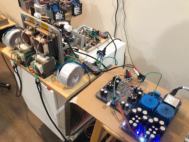

Tested Yarra with MOAMOFO and great news is that with music off it is silent. No hum, hiss or any noise with ear pressed to speaker. The verification that there are no unbecoming groundnliops always has me worried but this Preamp is solid in the noise department. It sounds superb - nice deep foot tapping bass and excellent stereo image and soundstage.

XRK, do you have any amps that are neatly housed in a nice chassis, or do they all look like the ones in test jig style as your photo shows?
At least they would be easy to work on. My wife would not let me bring any of that style into the house from my work shop.
