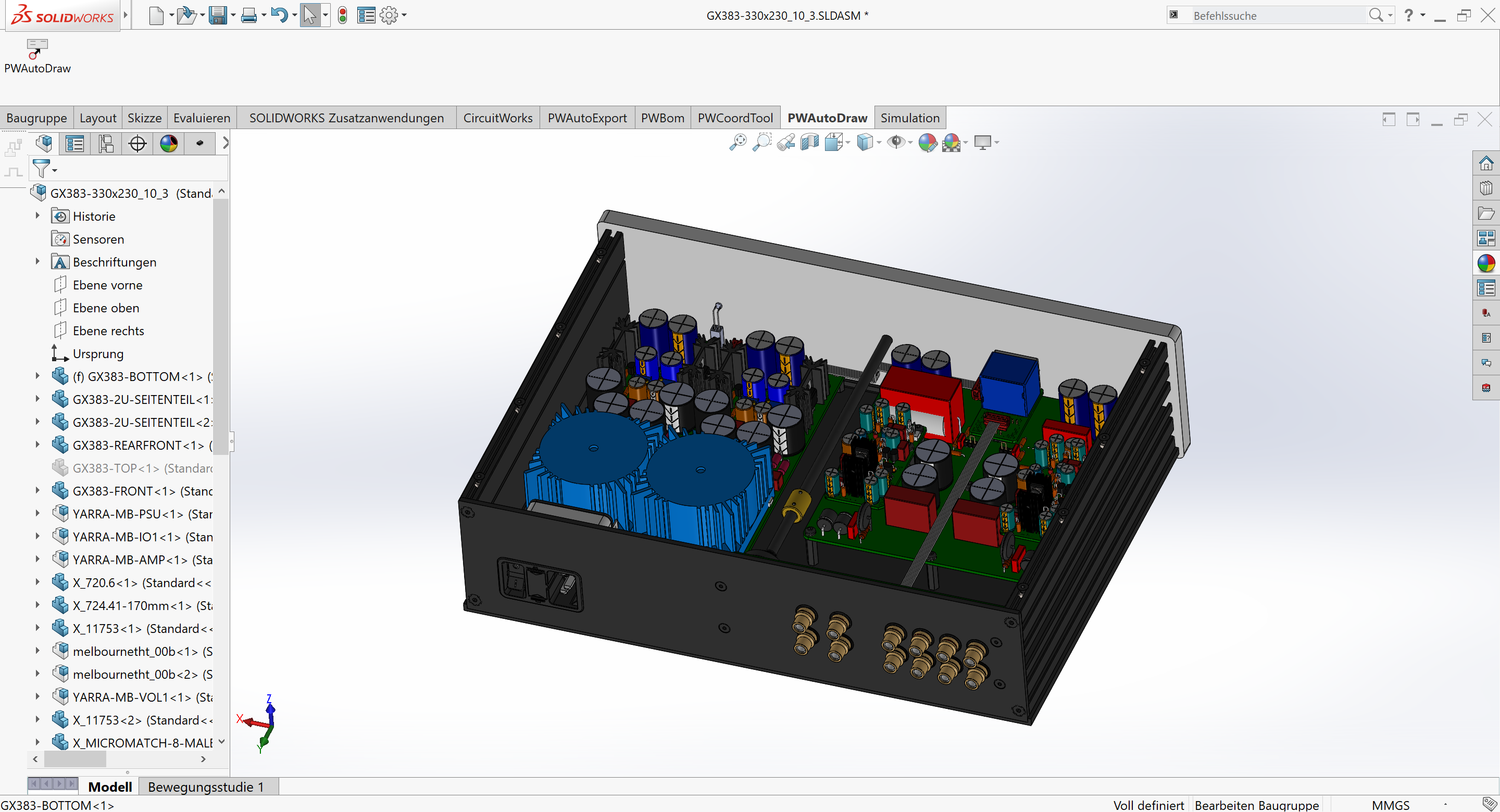

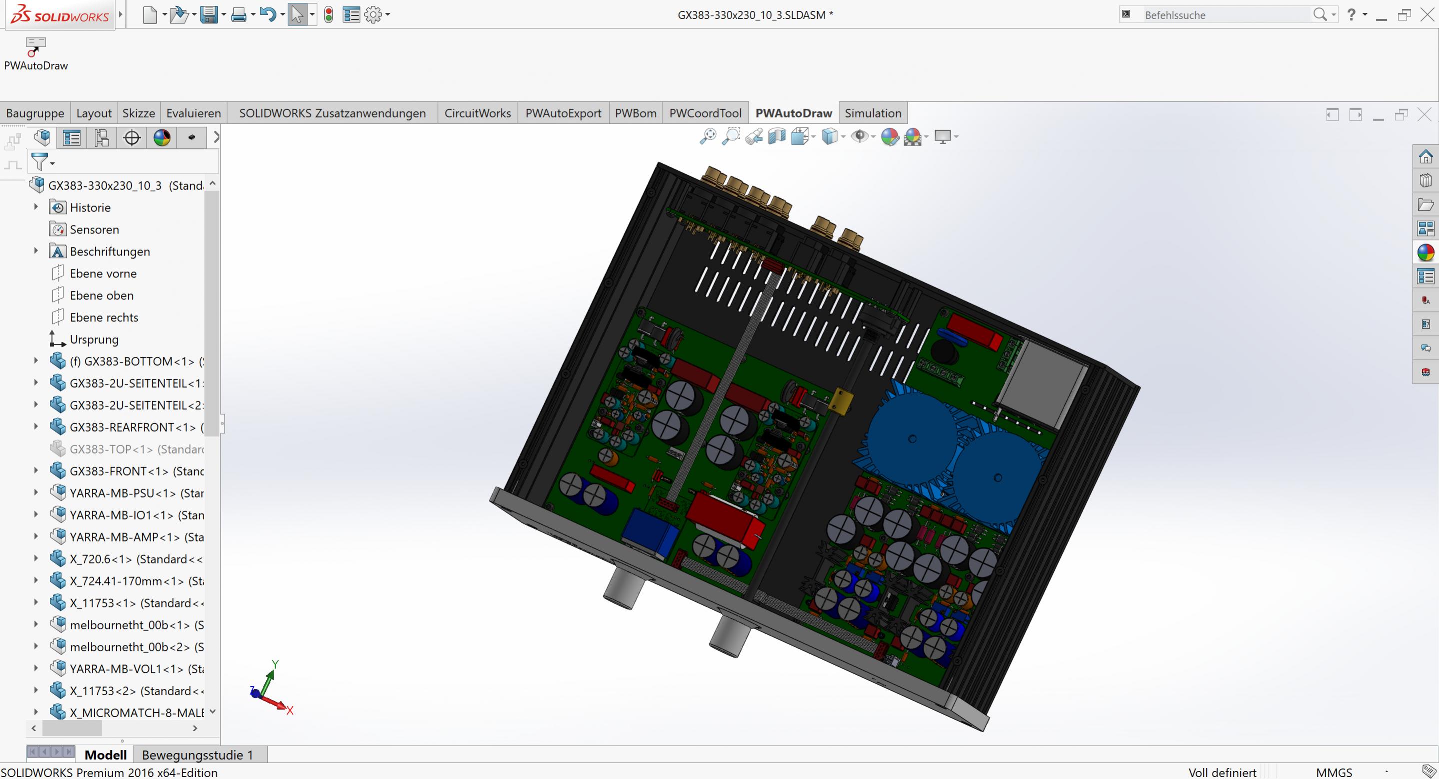

The YARRA Preamplifier/HPA for Melbourne DB Group Buy
This is about as finished as one of my amps can get. Aspen Deltic Class AB - prototype build.
716573d1542661241-aksa-lender-mos-hybrid-aleph-alpha-amplifier-deltic-cased-04-jpg
716564d1542660617-aksa-lender-mos-hybrid-aleph-alpha-amplifier-deltic-cased-01-jpg

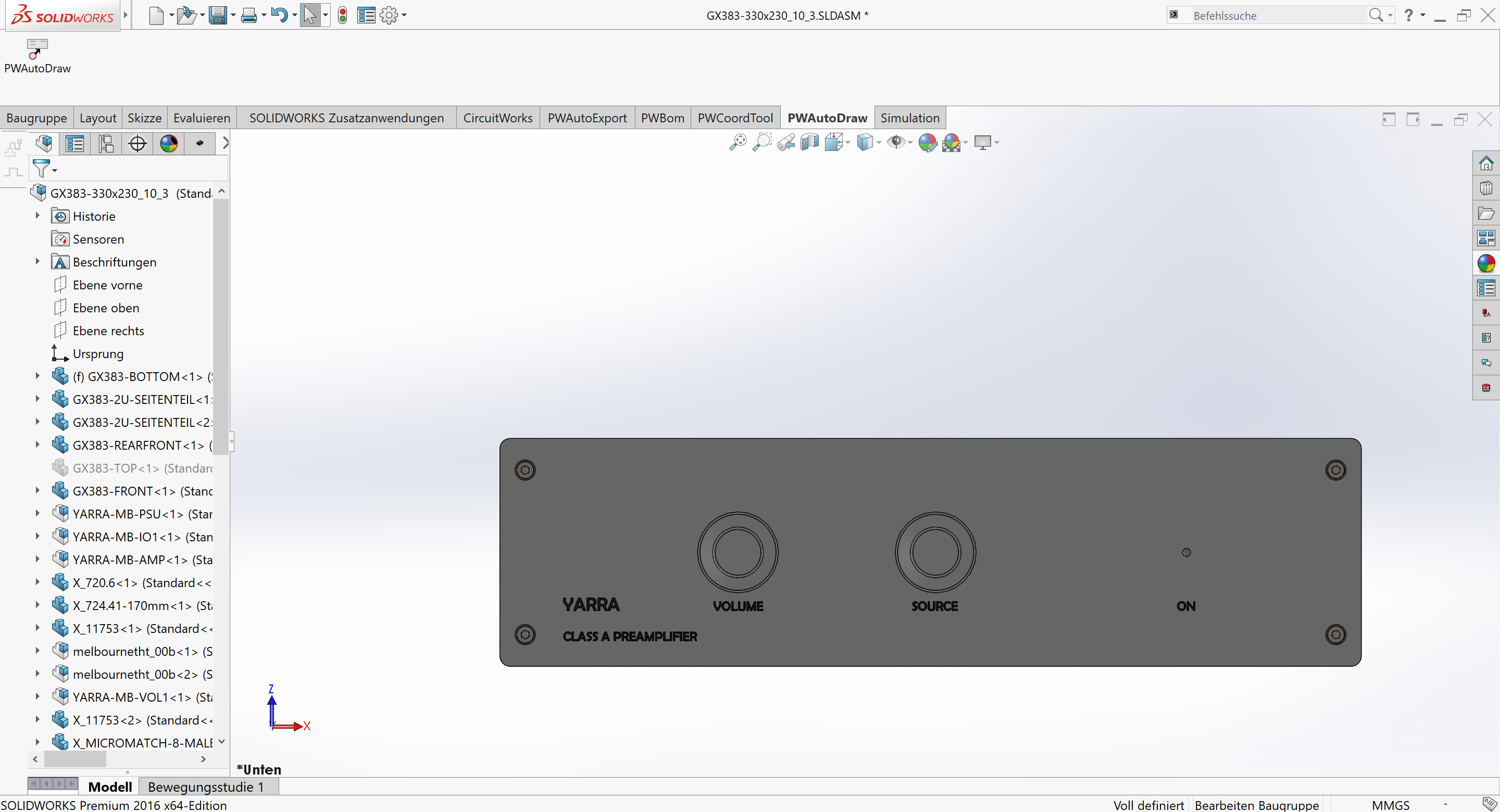

Hello future builders,
only rear plate silkscreen missing.
We´ll have two front plate version, one for the preamplifier and one for the HPA (with XLR jack in front).
Question: it´s possible to publish here on the forum ZIP including eDrawing greater then 3MB?
JP

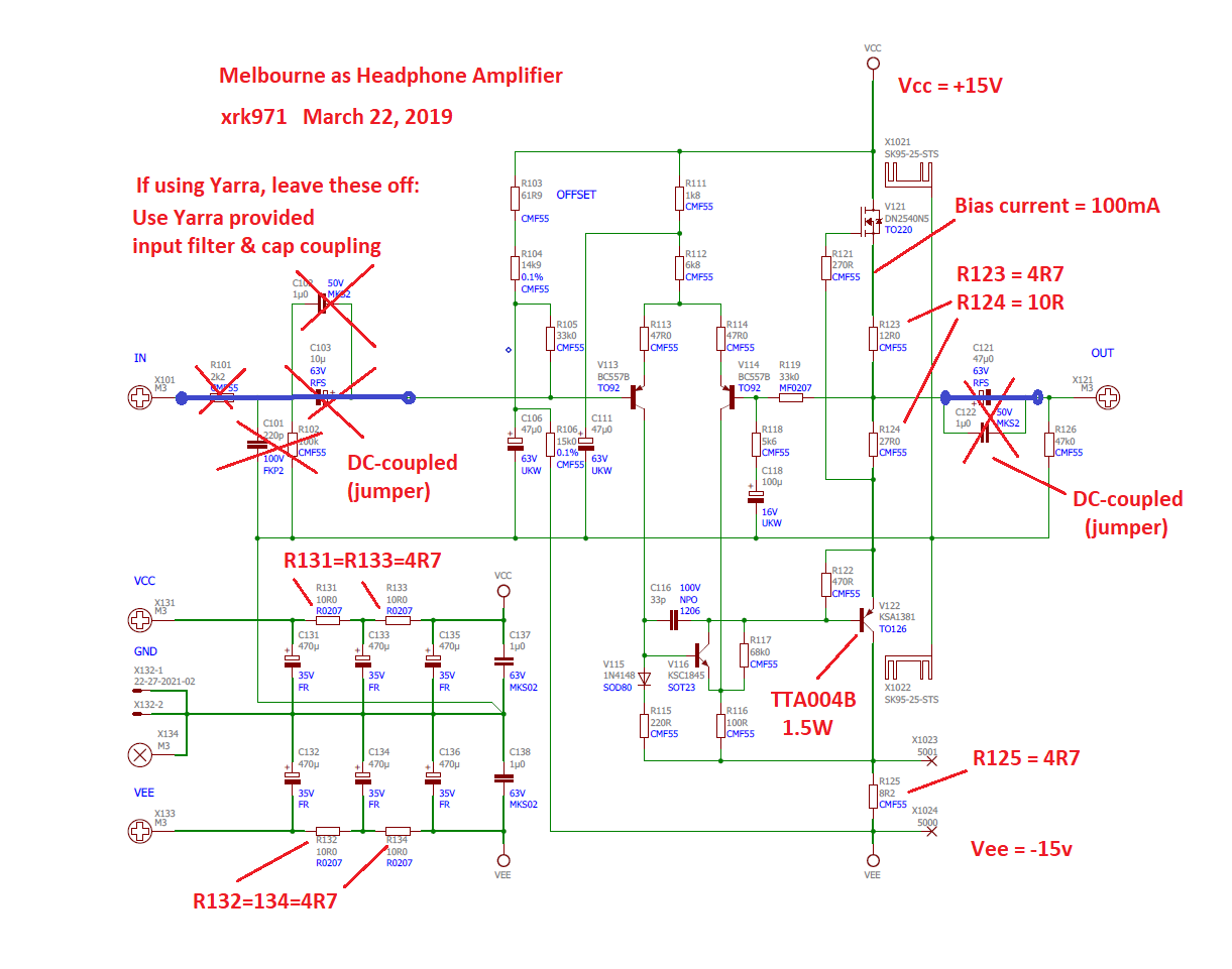

With the Yarra at its default output gain of 16.8dB, would that be enough to drive a set of 67ohm headphones? I’d like to build it with a switch for both option like in the schematic.
So how about coupling? Is there something I could read about that? It’s comes up often in these threads, but it’s still a gray area. DC couples or not DC coupled, are common comments. I though may I was starting get the concept, but then a few posts ago AC coupling was mentioned....
Thanks again for the help, and all the effort you guys are putting into these DIY projects! It’s really quite amazing.
16.8dB is a pretty good gain setting for moderate sensitivity headphones. For 105dB+ headphones, you may want to bring it down. I have tested with 55ohm 96dB headphones at 41mA bias current and it works very well. You can really improve headphone only performance if you change the bias current to 100mA and drop the voltage rails to +/-15v (to reduce dissipation) and this will drive even 30ohm cans. I am posting that schematic below for the mods for an HPA if you are interested. It can still be used as preamp on most 15dB or higher sensitive amps but not on 0dB 25w amps like F4.
Here is HPA centric schematic for Melbourne. Switch the KSA1381 for TTA004B in order to handle higher current .
