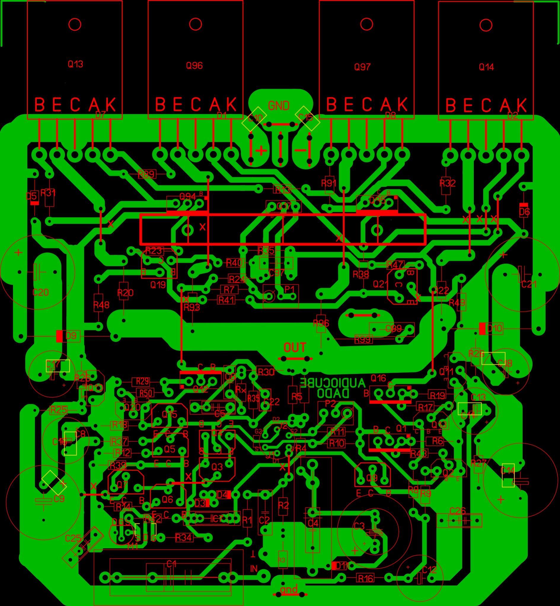

Terry, I think we are getting close to the bug. 13v across a Vbe multiplier sounds very wrong. I would double check resistance value of R24, R40, and R47. Please NEVER turn P1 all the way up, as there should be a fixed resistor in series with P1, to prevent the Vbe multiplier from putting out a hazardous high voltage, that has been omitted. Always turn P1 back to high resistance end and go from there. The Vbe multiplier is supposed to have a voltage output anywhere between 3.5V and 4.2V, measured across C97.
I'd also make sure that Q2 and Q19 were not mounted backwards. The footprint outline of these two transistors are facing the wrong way in the layout drawing.
Yes Nattawa I think you are right. From the photo on the page #338 both transistors Q21 and Q19 are mounted backwards. On the layout the transistor pins are marked correctly but the transistor body shape is turned by 180 degree. Sorry for this layout fault, I was checking it many times and could not noticed that. Here is corrected layout.
BR Damir
Hi Damir, thanks for the confirmation. I went to the post 338 as you pointed and it appears in the photo that Q21 and Q19 are indeed backwards installed. That probably explained why we have an open global feedback loop. Hopefully this gets terry a Champagne break.

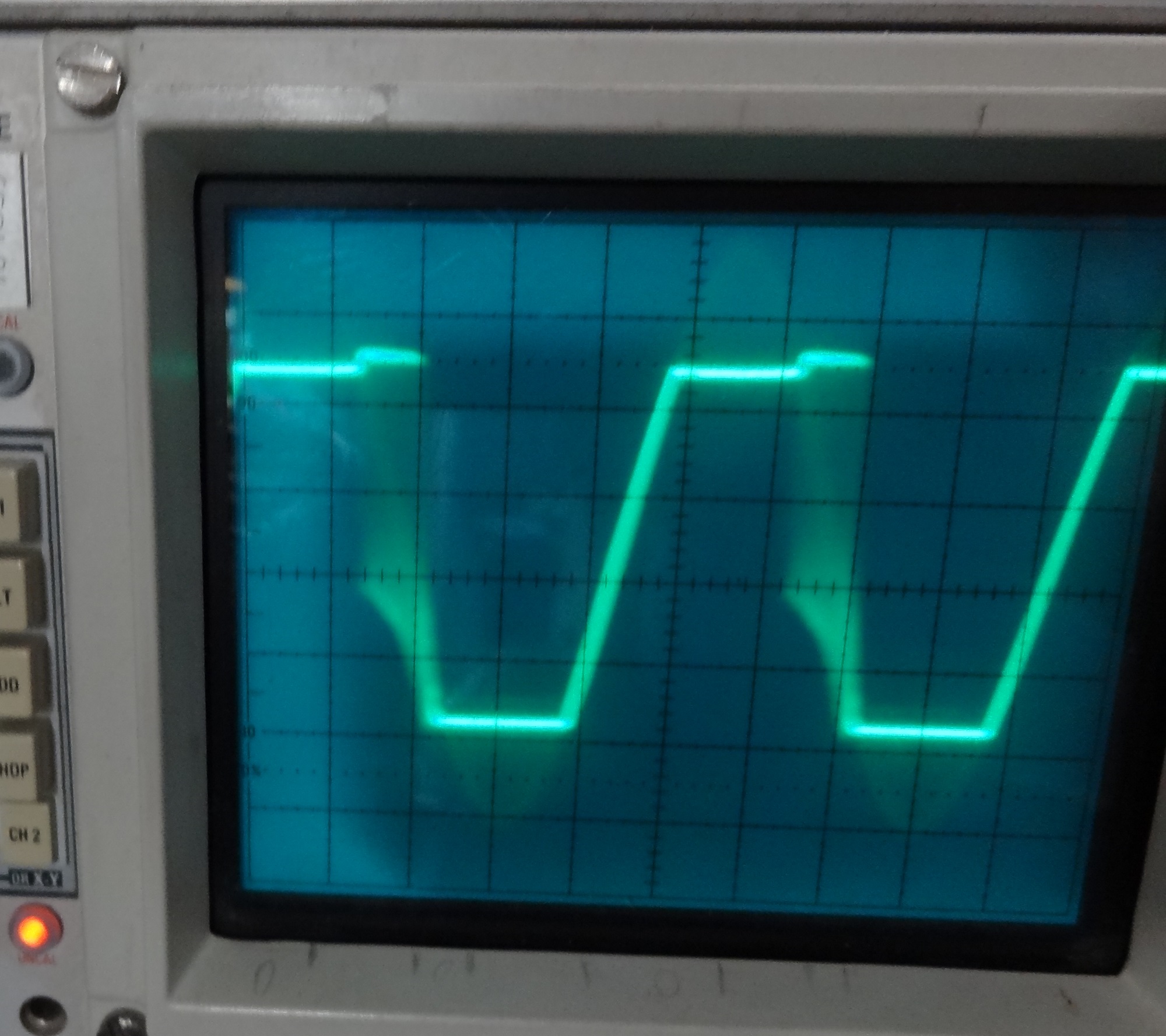

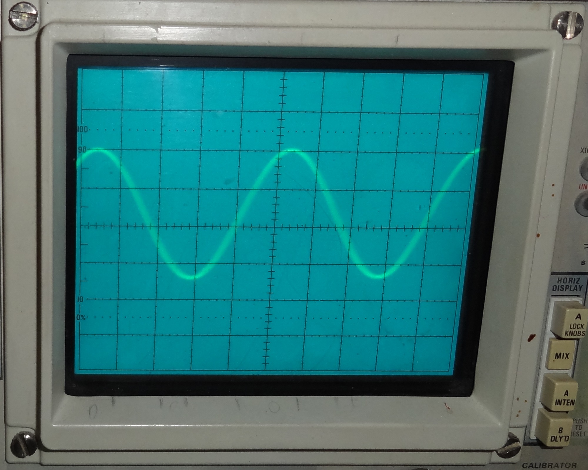

OK Guys,
That was the problem. Everything works right now. Sine and Square waves look good. Music sound good. However, it clips ugly. Latches up badly. I am attaching some pics. One is the sine wave just before clipping and the second is at the point of clipping. Both boards do the exact same thing.
Blessings, Terry
Blessings, Terry

Hi Terry,
I've had some latching but not so much as you have, I could not find the photos to show.
You can tray to increase R37 to 6k8 or even higher to 10K. It should make clipping better. It's not easy to make VFA with TMC to clip with no latching without Backer clamps, but in this case you have to have separate power supply for IPS with higher voltage then that for OPS.
How about thermal tracking? If it's overcompensated you can increase R35 to next value, and if it's undercompensated you can decrease R30 to next value. I prefer a bit overcompensated.
BR Damir

I had some latching on the Honey Badger. OS came up with a solution but I will have to look back to see what he did. It wasn't nearly as severe as this one. It looks perfect right up to the point where it starts to clip and then it goes ballistic. You can hear it in the boards. I will try increasing R37 and see if that helps. I personally would never play the amp that loud, but if someone did, I can't imagine it being kind to your speakers.

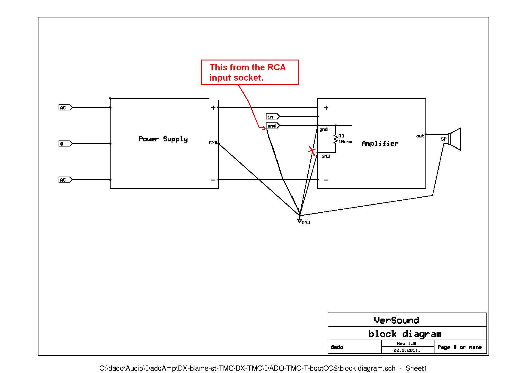

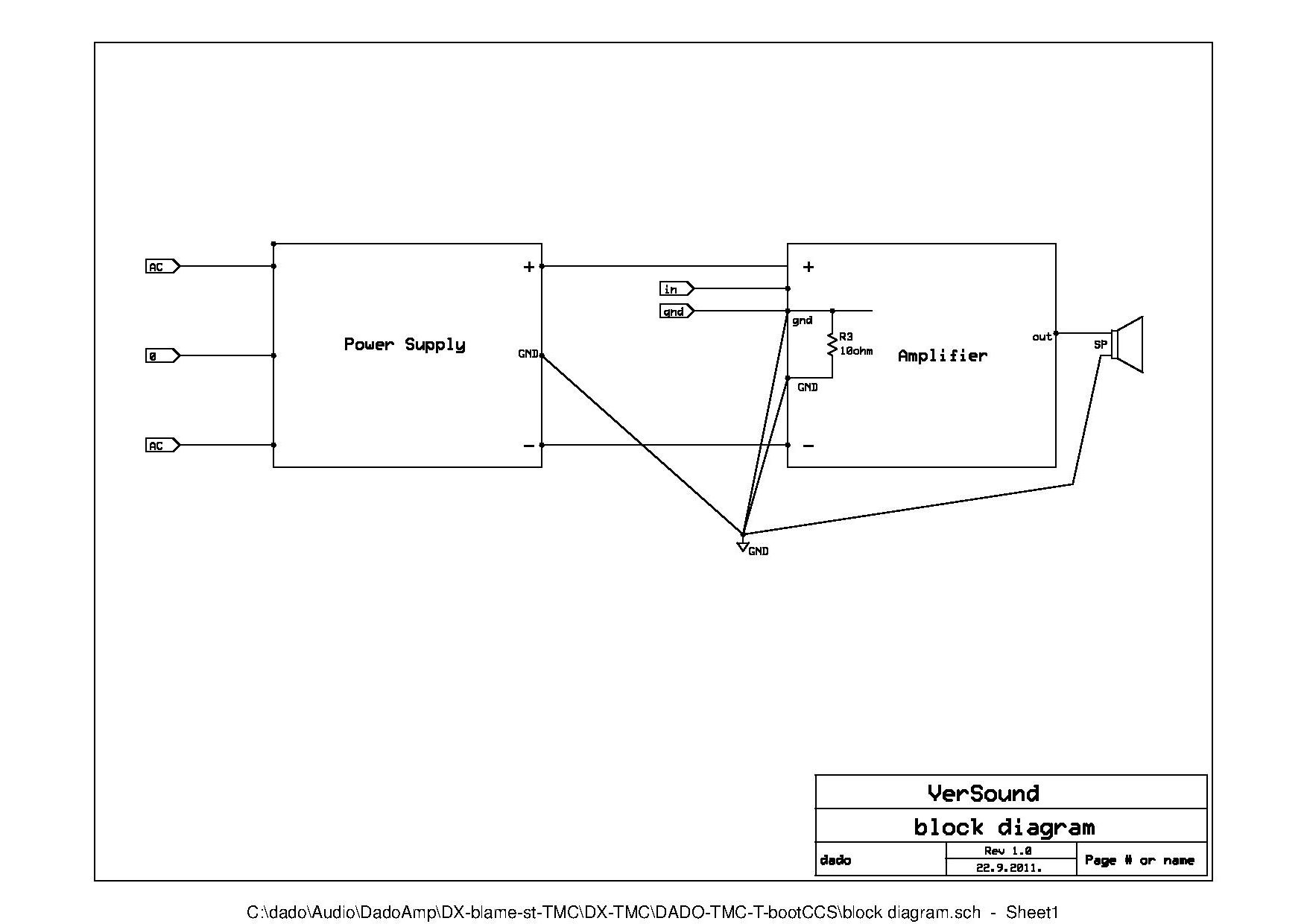

Hi Terry,
It is very important to do the grounding in a correct way, it can influence a latching too. Here is how I do the ground scheme.
If you want to take the best from TT amp I suggest you to build the PS regulator explained in this thread too, but before you do the PCB check with me for the last layout.

Please, so I can understand, what does R3 do, since you have essentially shorted it by running both sides of it to the star ground?
I've tried to explain it some post back, here http://www.diyaudio.com/forums/solid-state/182554-thermaltrak-tmc-amp-32.html#post4182186, but it looks with no success.
You can tray with no ground connected to the ISP lifted gnd and decide by yourself what you like more.
Hi Damir,
That doesn't really answer my question. I am just trying to understand. If the input ground is connected to star ground and the pwr ground is connected to star ground, does R13 serve any purpose?
Thanks, Terry
Hi Terry,
On the board you are using there three separate grounds, OPS power ground, IPS power ground and IPS signal ground. R3 10R resistor is connected between IPS power ground and IPS signal ground. This resistor some call a ground lifter and some a ground loop breaker. During initial test of the single board I don't connect IPS signal ground to the common ground, but when assembling the amp in to an enclosure I connect all three(or two if ops and ips power ground are not separated on the PCB) to the common star ground and I never had any hum or buzz. Yes you don't need that R3 resistor if you allays connect all ground to the star ground, but it facilitate initial test and does not harm if stays there.
