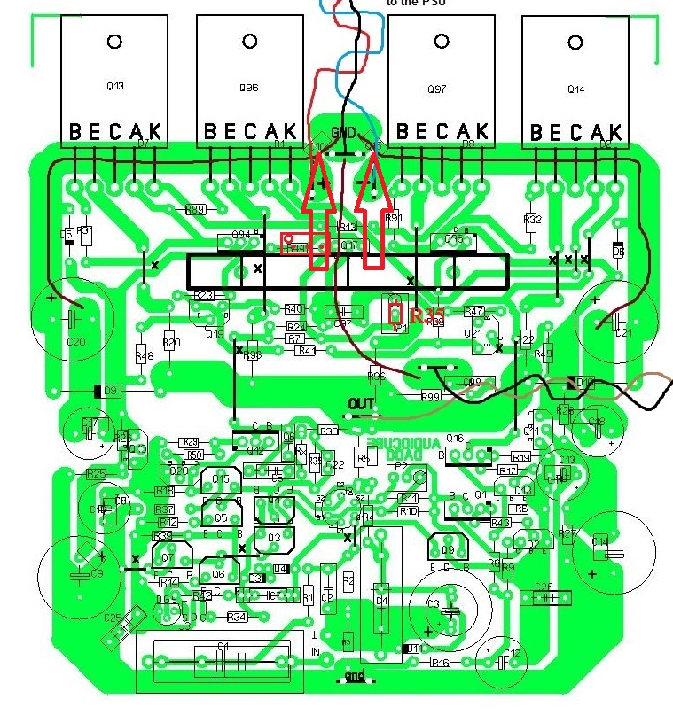

Another question. What are these caps? They are not in the schematic.
That is provision to use SMT ceramic caps here, they get in parallel to the big elcos C20 C21. You can see others SMT caps parallel directly to other elcos soldered from the bottom.
I am not sure that position for those two is good, maybe better to put them directly to the elcos.
What are they? .1u?
Yes I used 0.1u in my amp.

HF decoupling.Another question. What are these caps? They are not in the schematic.
This is the best way to lay out an amplifier PCB.
Power +ve and Power -ve beside Power Ground. The power wires arrive as a twisted triplet at the three pads.
Then you can add in the HF decoupling right next to the three pads. The shortest and lowest inductance routes available.

Andrew, look this PCB wiring, twisted pairs and twisted triples.
http://www.diyaudio.com/forums/solid-state/182554-thermaltrak-tmc-amp-38.html#post4194947
took me to post401?
I saw and commented on this PCB layout today, that showed the +ve & -ve & PG arriving on the PCB as three close coupled pads.
I said "This is the best way to lay out an amplifier PCB."
It even had HF decoupling (smd) between the close coupled PCB pads.
Well done.

It should be post 372, I don't know why it sometimes doesn't work.
Post374 also shows something that is overlooked in most layouts and amplifier wiring.
Start at the speaker leads.
They are a twisted pair.
They go to close coupled Spkr and SPK Return.
SPK Return passes as a black (hard wire) over the PCB roughly following the centroid of the FLOW currents coming from the output devices. i.e. the Return wire is close coupled to the FLOW routes.
Then the Return attaches to the PG and Returns along the Power cable along with the +ve & -ve FLOW from the PSU.
The transient currents in the SPKR cables are resolved in the close coupled Flow and Return traces and wires.

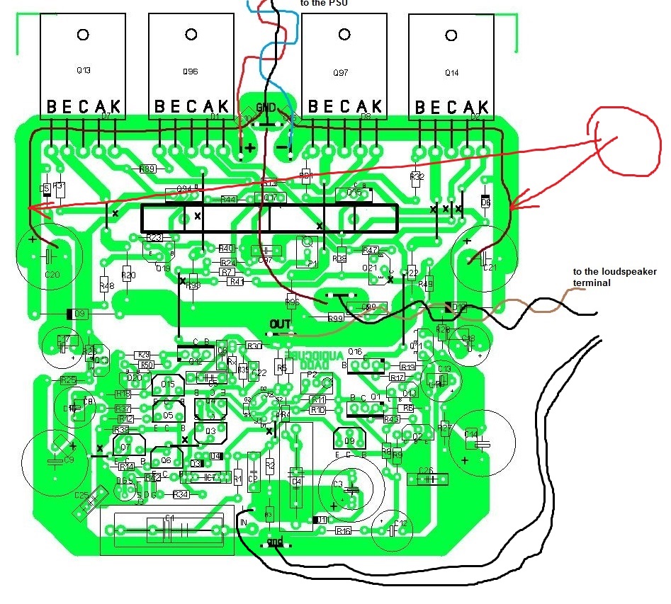

please check here.
That is ISP power ground and goes to the common star ground.
To be clear I added the PCB wiring picture, all black wires go to the common star ground except that one for the speaker.
But why is it "better" to run long wires to the star rather than a short jumper on the PCB?Voltage reference wires that do not carry current can be single wires and they can be long/longer.
It's the current carrying wires that must be close coupled to minimise interference effects.

Because power GND is a dirty GNDBut why is it "better" to run long wires to the star rather than a short jumper on the PCB?
Ok it is more clear nowThat is ISP power ground and goes to the common star ground.
