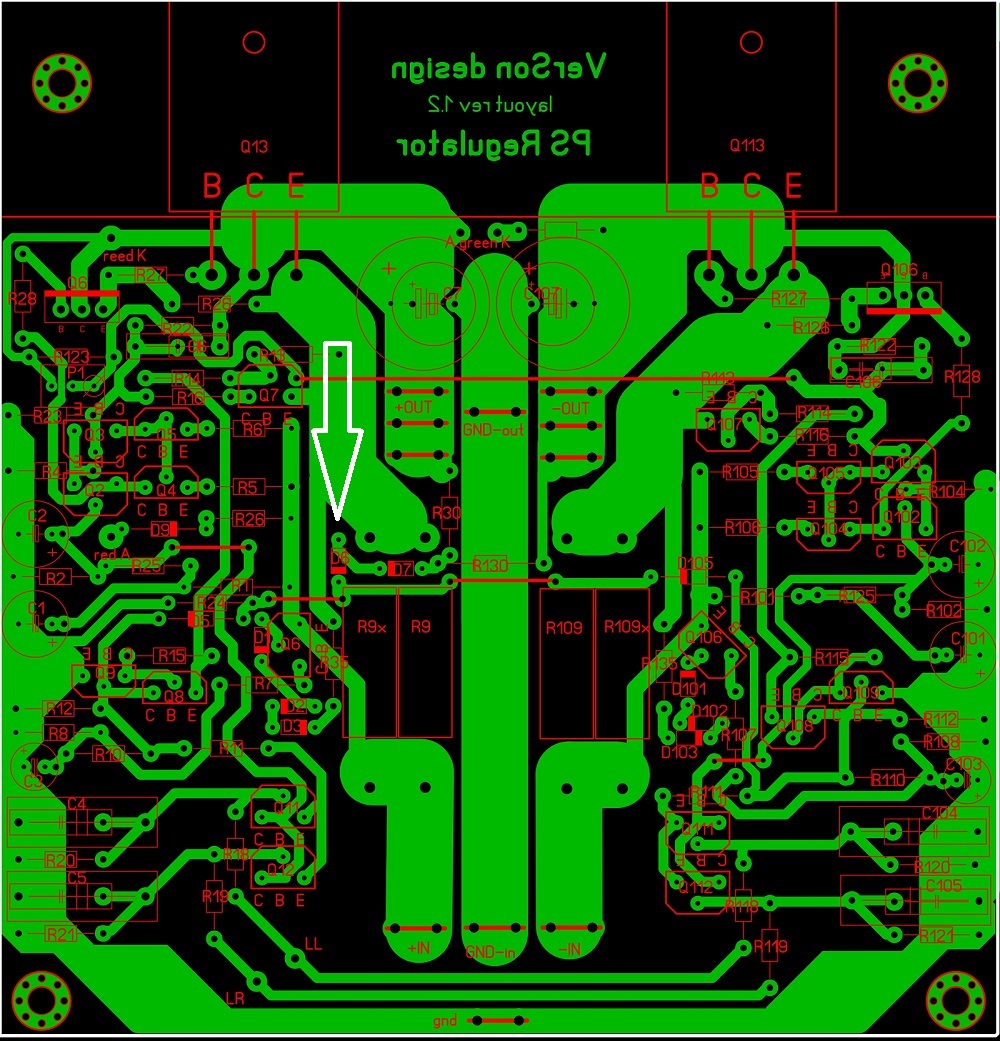

I am trying to test the circuit but it is not working. It seems that D6 is reversed on your layout shown in Post 472. Can you please check that and let me know?
Thanks, Terry
D6 should be reversed, D6 and D7 are 10V zener connected back to back and if difference between + and - polarity is bigger than 10V it will trigger protection. To test the regulator first disable the protection on both polarities, by shorten R13 and R113. After that you have to adjust - polarity with P1 to be the same as + polarity (outputs of course). After that remove shorts from resistors. To test the loudspeaker protection, touch one output with one hand and with other touch in the same time one of the loudspeakers input(LL or LR). The protection should trigger and shut down the outputs. To reset the protection switch off the power and wait a bit to discharge big caps.
BR Damir
I'm using MJL21193/94 for the pass transistors but I have 0VBE on the MJL21194 so only about -5V output on that side. I will try shorting the protection in the morning and see it that helps find the trouble. I already spun D6 and that didn't fix it. All the transistors test right with a diode test. If I can't find the issue I will mark up a schematic and let you take a look.
Thanks, Terry
Thanks, Terry
Thanks, Terry
If + and - outputs are not equal (>10 V difference) than the protection triggers and shut down both output.
BR Damir
By the way, it is good to have some loads at the outputs during testing, let say 330R 10W, or 470R 5W.
