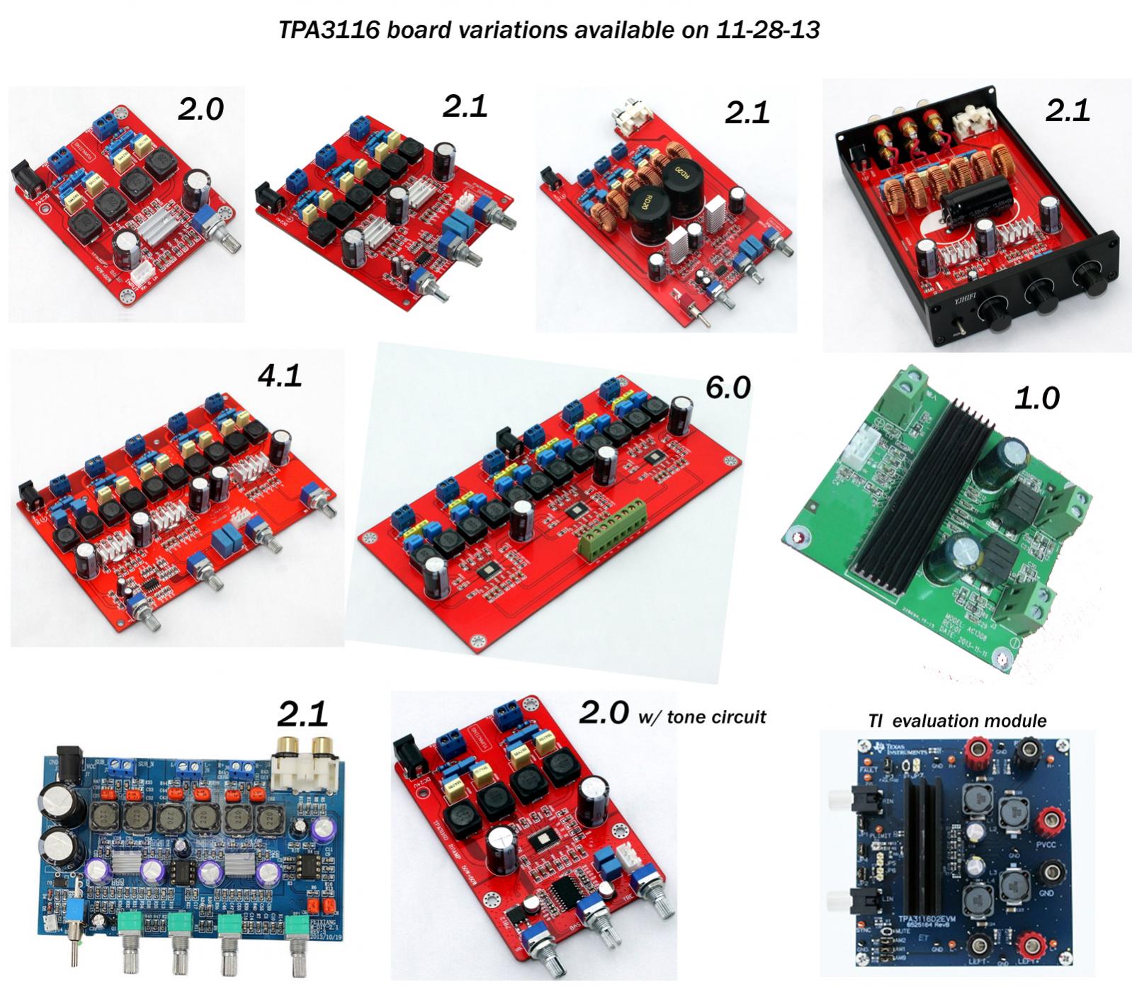

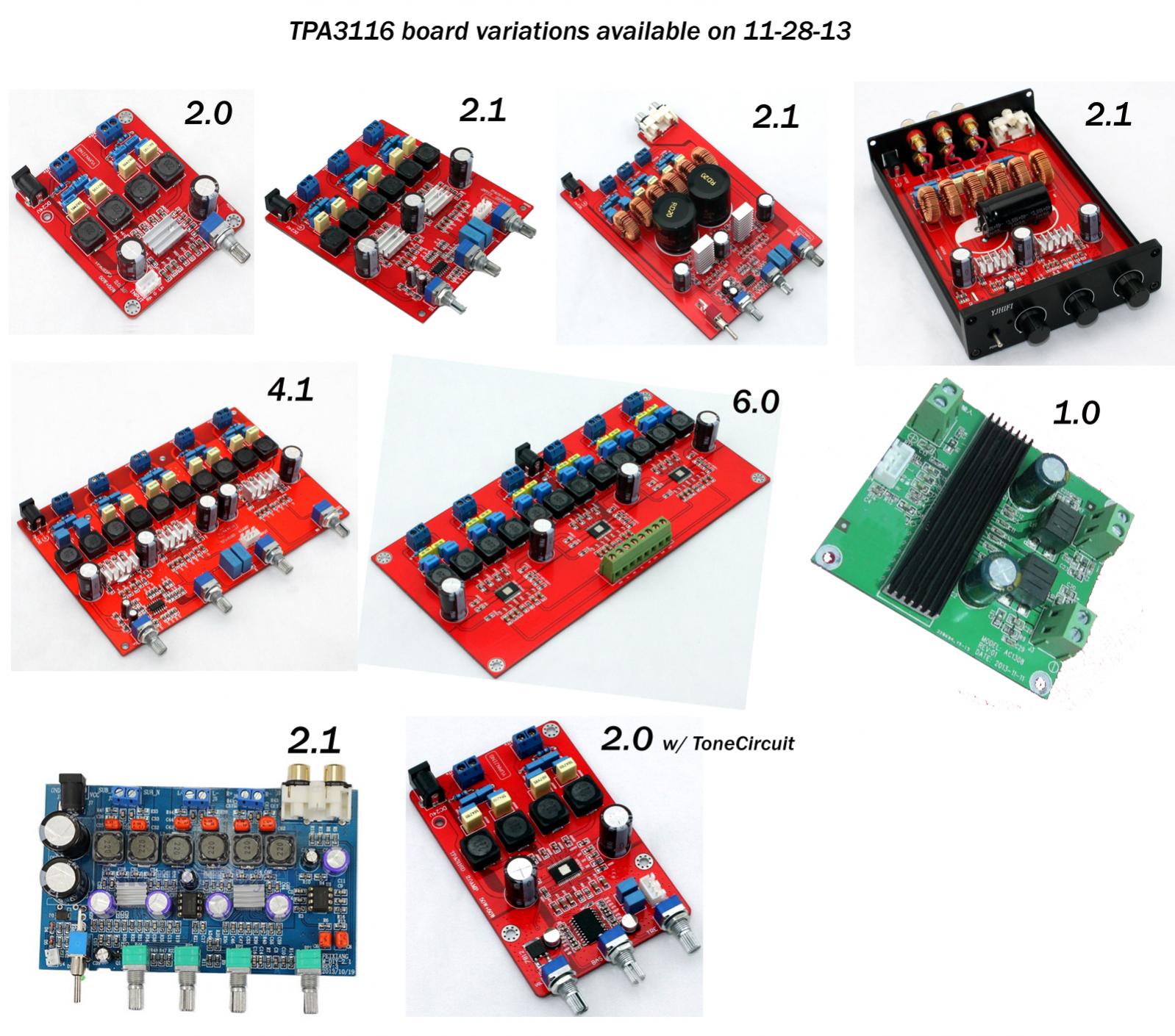

Here are all of the currently available TPA3116 based boards that I'm aware of. Did I miss any?
Wasn't there a board from TI?

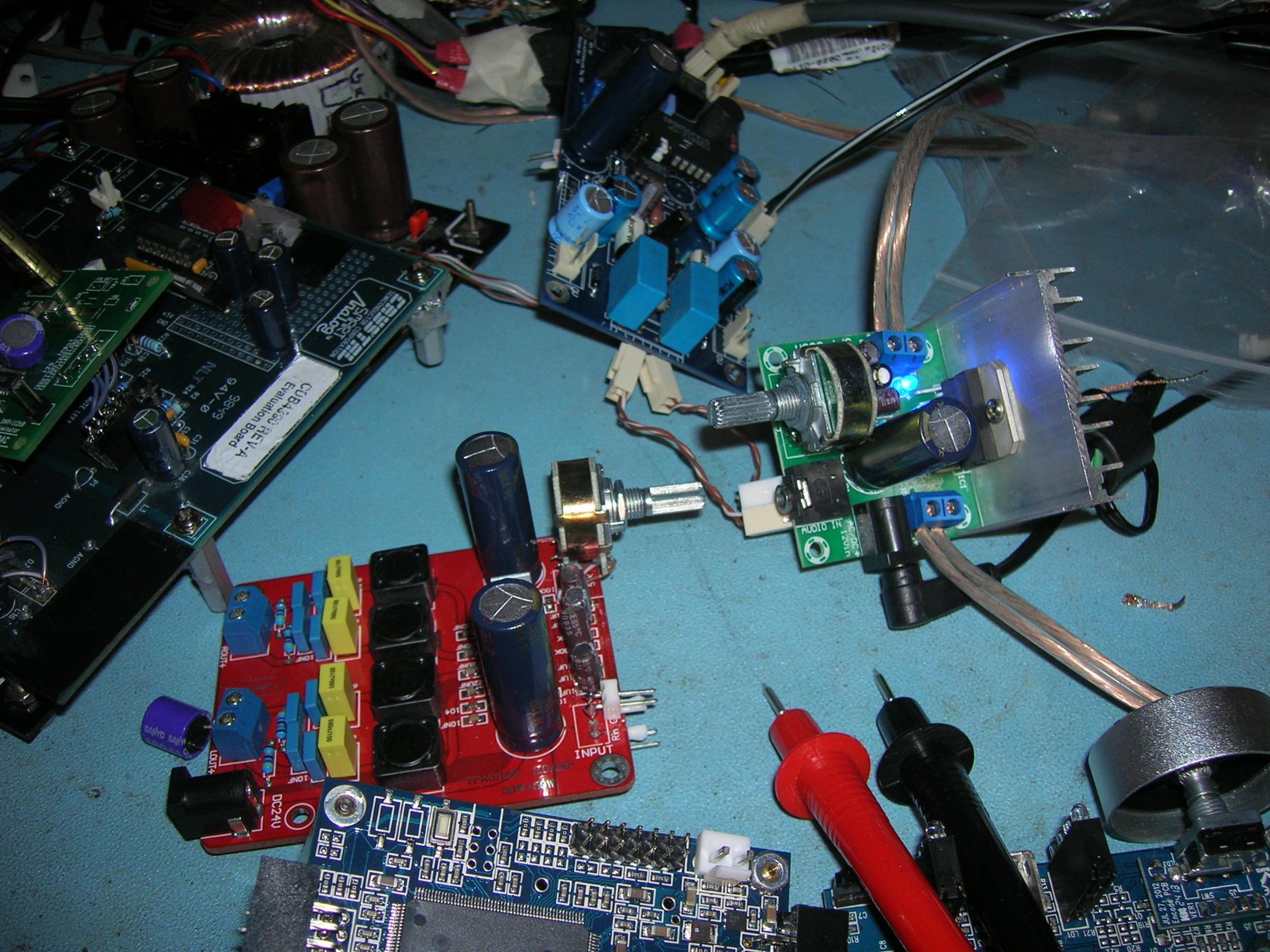

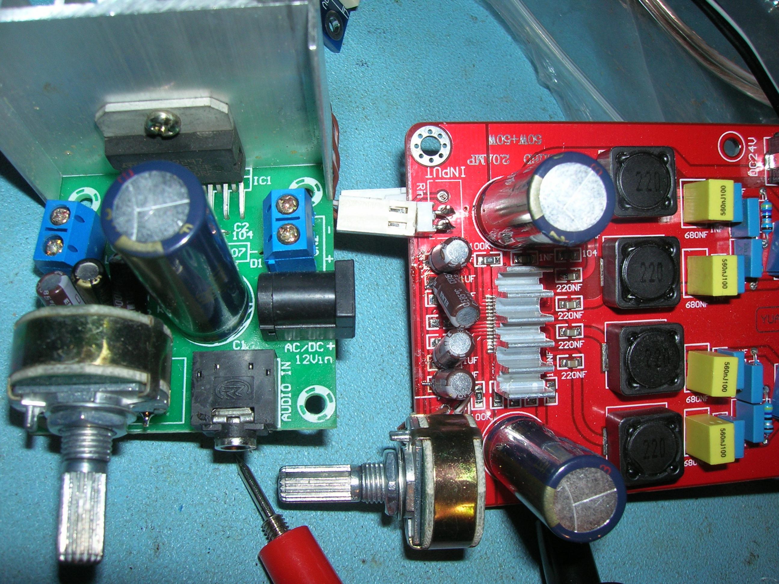

How does this amp compare to the TDA7297 Class AB amp?
Went back and forth a few times:
![TDA7297 ROCKIN'.jpg TDA7297 ROCKIN'.jpg](https://www.diyaudio.com/community/data/attachments/344/344808-379b574ad70b9651efa2e82c2b4c60d8.jpg)
And they have a lot of the same components: Pan FC 2200uf/25V ps, Silmic II input coupling caps, step atten vol ...
![7297 3116 same comp.jpg 7297 3116 same comp.jpg](https://www.diyaudio.com/community/data/attachments/344/344786-ce34cfdd13930137c106532fc44d2a86.jpg)
Hmmmm, both sound very good but if I had to say the 3116 has more 'dynamics' and the 7297 had more 'sound stage.'
PS In a peculiar system: alpha 8 mids, 4 ohm tweet, and 15" w 10mH ! On each side :0
