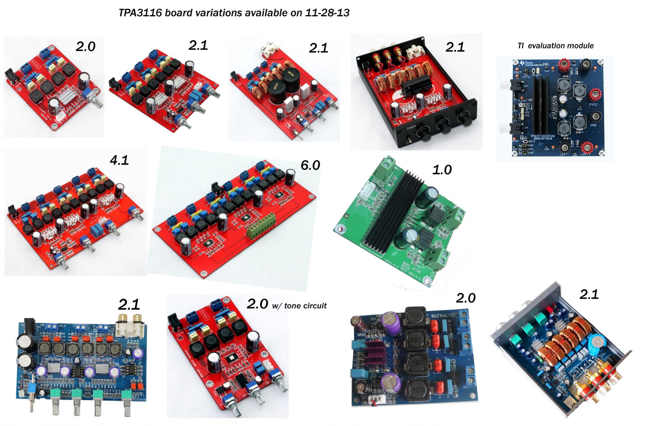

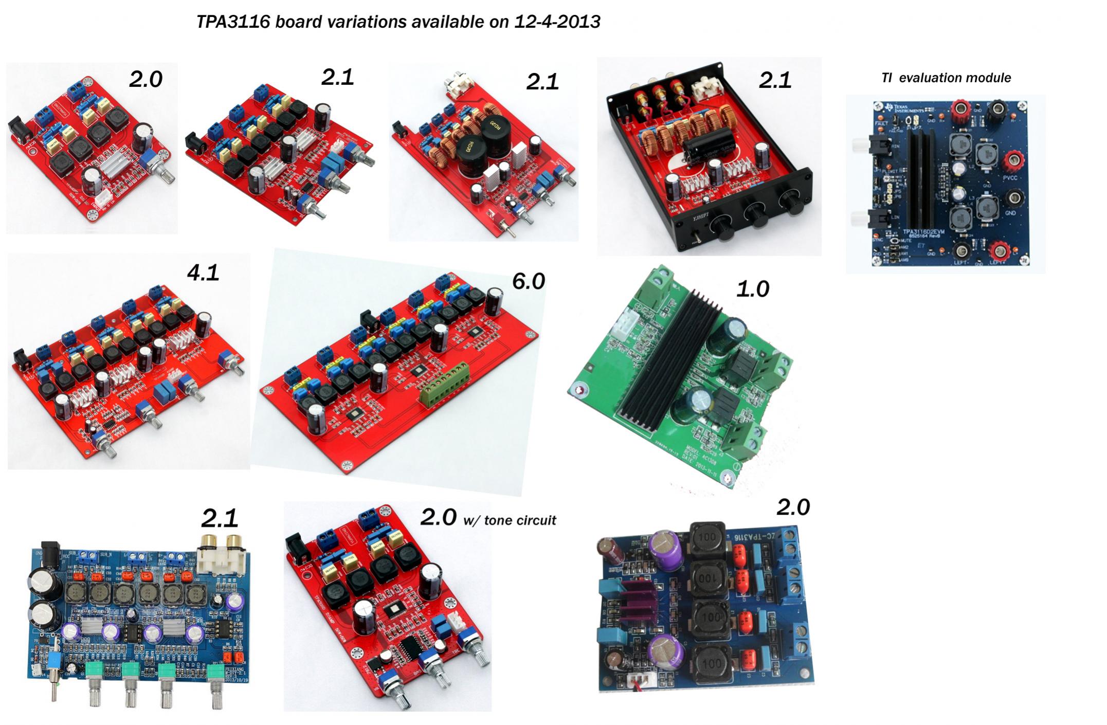

Here are all of the currently available TPA3116 based boards that I'm aware of. Did I miss any?

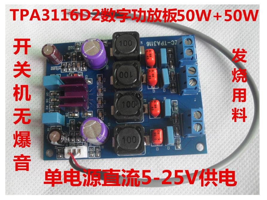

Look like a new player has entered the arena:
TPA3116D2Êý×Ö¹¦·Å°å 50w+50w ³¬TA2024 TA2020 TA2021-ÌÔ±¦Íø

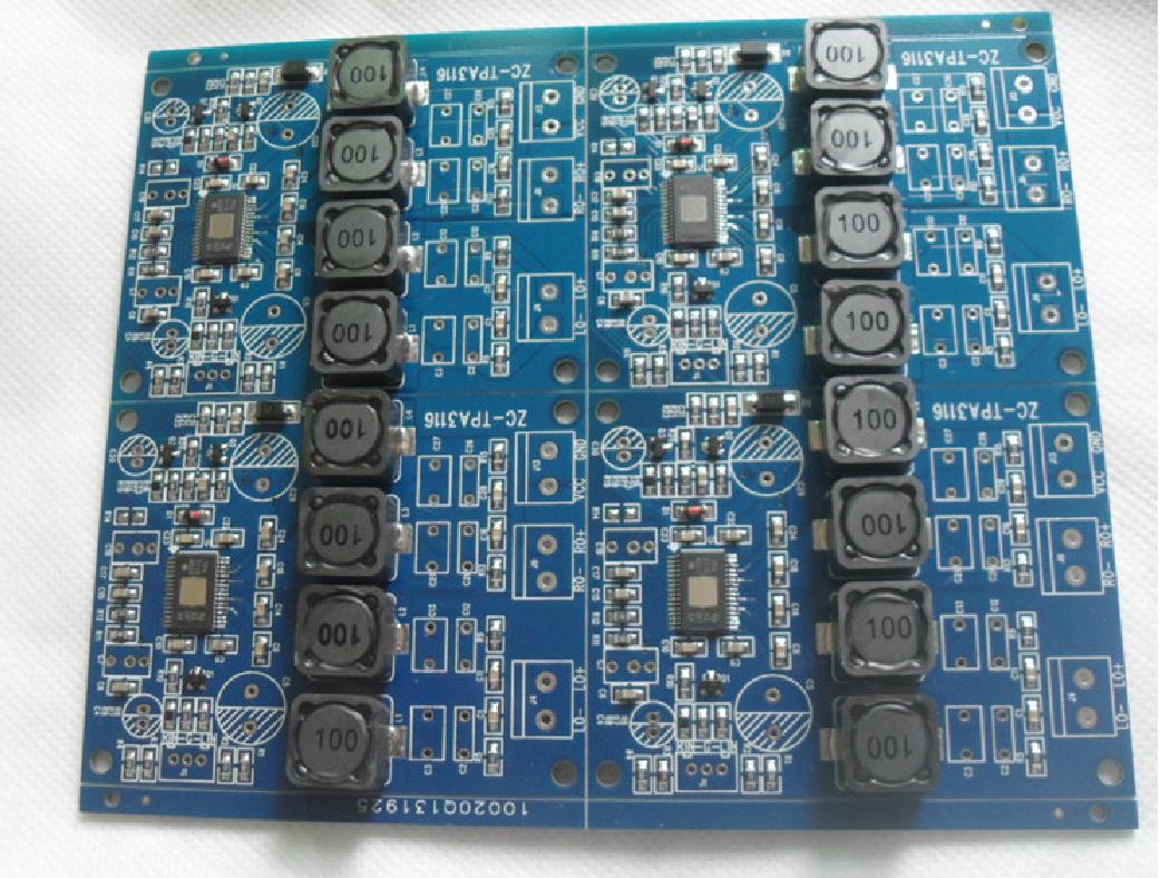

The manufacturer of this board claims to have speaker protection and guarantee no pop at turn on. It uses 10uH inductor, not 220.

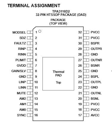

The small Sure TPA3110 does have a mute pin, does the TPA3116 have one also ?
When you see a 3 digit number marked on an inductor, the third digit gives the number of following zeroes. Hence '220' means 22uH - this value is recommended for 8ohm speakers.

Yes, it does.

Don't see any speaker protection or pop sensing circuit on the board though. Not that it matters, it looks to me like a significantly better designed board than the YJ one. So I'll give this a go right away.
Thanks for the heads up.

I was wondering too. Usually, speaker protection circuits use relays. I did not see any relay on the board?
