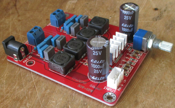

I originally attributed the lower optimum voltage to pushing the 25V electrolytics close to their voltage rating but even with 50V caps I prefer running these @ 20-22v.
That mirrors my impression which leads me to think the cause is in limitations of the chip itself. Most likely in the output stage.

I have been really enjoying my little 2.0 YJ board. It's running a pair of EL70 full-range drivers and is being fed by an AirportExpess. One issue I have had is that the board has a strong turn-on pop. It only happens when the volume is up. If it's turned down there's no pop.
Any thoughts?
Kyle
Absolutely same experience with my MA Alpair 7.3, connected directly to the amp.
Strong bump at starting up. Now I use to regulate the pot towards low volume to minimize the effect, but I can't get rid of it at all.
On my system if i plug the 24v to the board after having powered on the PSU, I have no bump with volume pot removed.
Does anybody know what (physical and electrical) size inductors are mounted on the standard YJ board?
I have ordered one and I am planning to try some other inductors. Not because I want the best sound possible, but because the board is going to be mounted in a see-through case and it's gonna be a hell of a lot cooler with other inductors...
Wouldn't it deteriorate the speakers?
How?
22 uH Shielded square type SMD 12x12x7mm - Sumida CDRH127 or alikeDoes anybody know what (physical and electrical) size inductors are mounted on the standard YJ board?
methinks stock ones are nice. unshieled are way cooler indeed but could degrade EMI/performance
To avoid bump you could just leave amp on permanently. It draws very little current when quiescent.
This is what I do now. I just turn the volume off when I'm done. I do worry about this though if I end up using this or another amp on a tweeter in an active system. My miniDSP also makes a pop (on shut down). Is a protective cap a prudent thing to use?

FYI.... The last YJ 3116 board I received has a few different components (main electrolytics and filter caps) It also has a thinner PCB ( 1.52mm vs. 1.73mm that the first 6 boards I received had)
