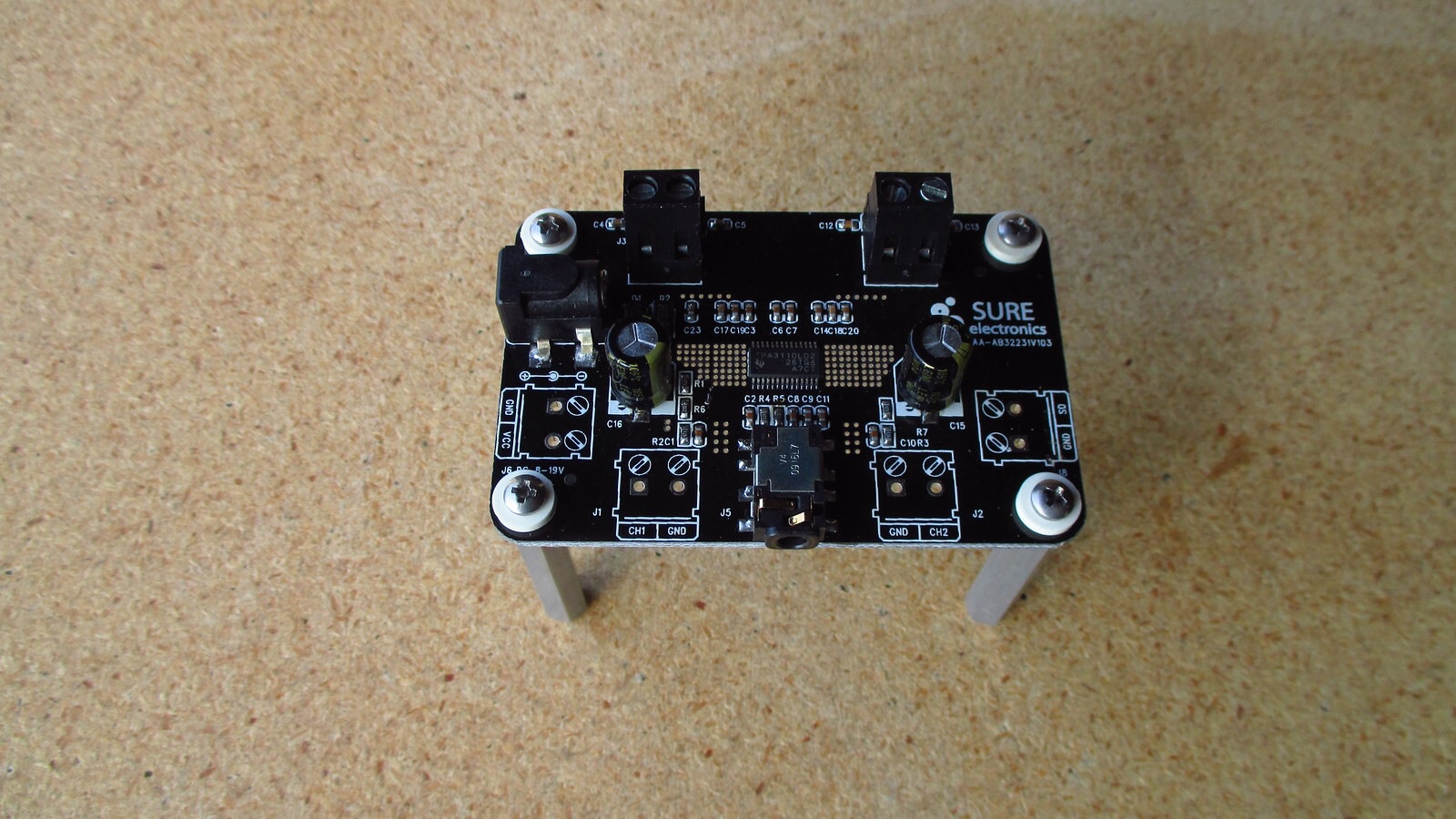

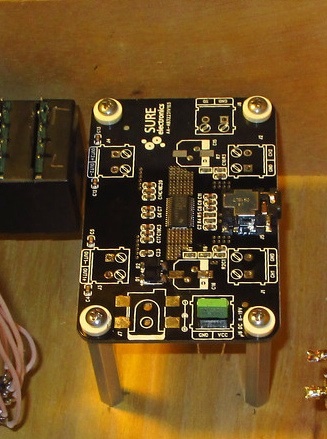

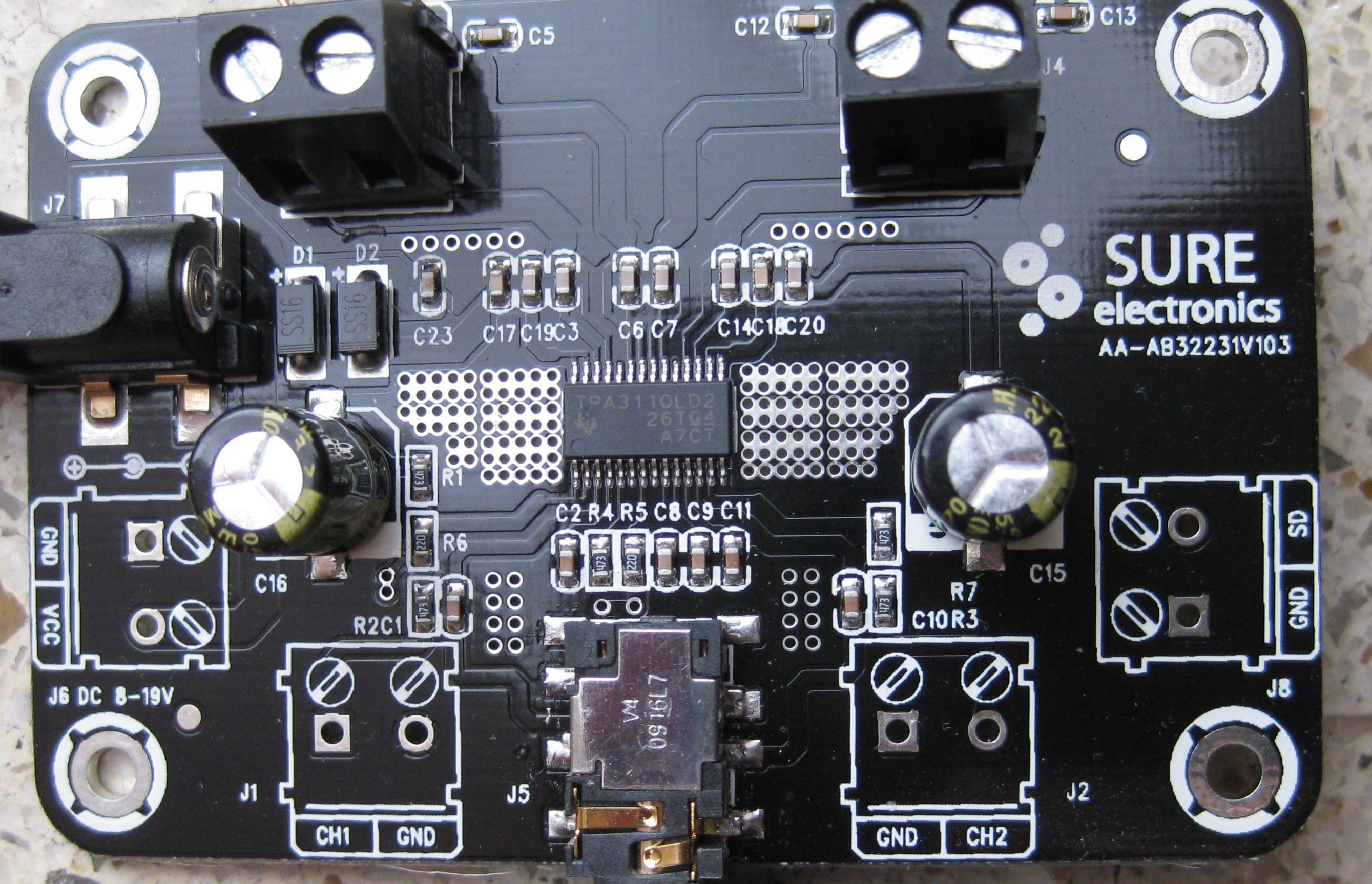

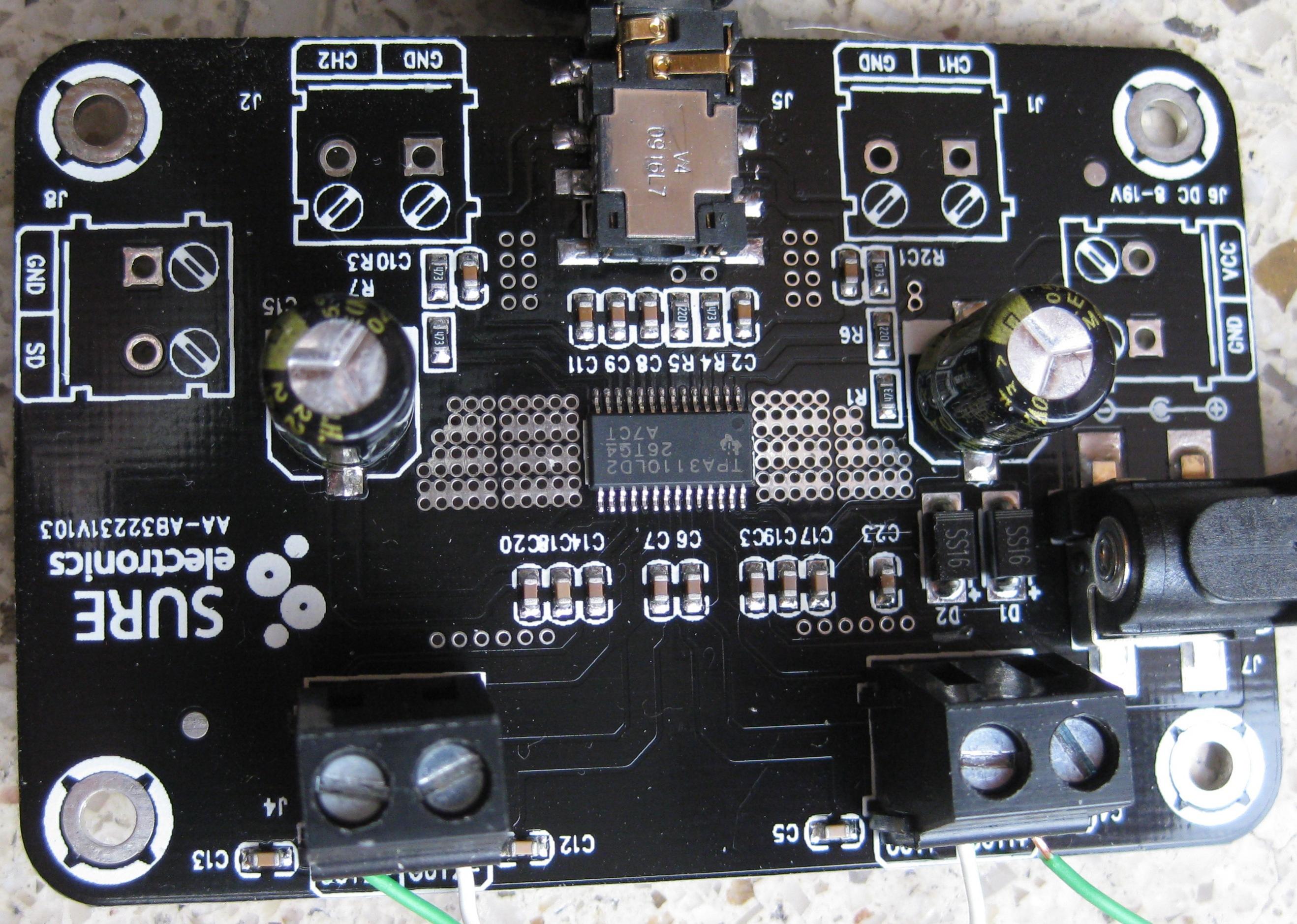

I have tried several input caps on my red 2.0 board ( without potmeter and 20V mean well smps ). This didn't give the improvement i was hoping for. I have ordered the sure tpa3110 board, because it should be the same chip, with a different outputfilter. The board arrived two days ago and it really does sound better. I am quite happy with the sound now. The high notes of a piano do sound like a piano. Does anyone know what the outputfilter of the sure tpa3110 board is? Can the same filter be used on the 3116 board? On the board itself i cannot find the beads that are in the documentation of the sure boards.

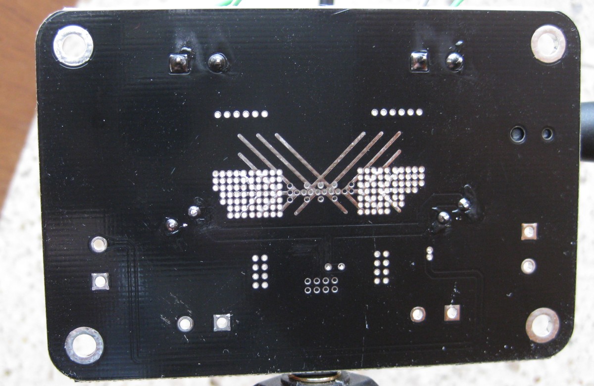

It's a ferrite bead filter. I can't see them on the published pictures of the board even though they are in the schematic but they might be on the back side. They are tiny (3.2 × 1.6 mm) SMD parts marked L1-L4.
Yes, the same type of filter can, and should, be used on the tpa3116/8 as well. I have long argued that it provides the best audio quality.
This is a picture of the sure board.
