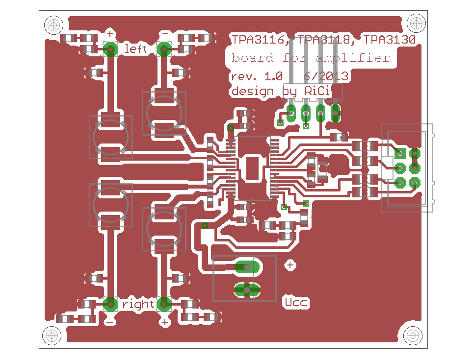

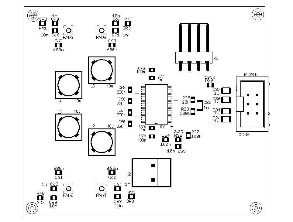

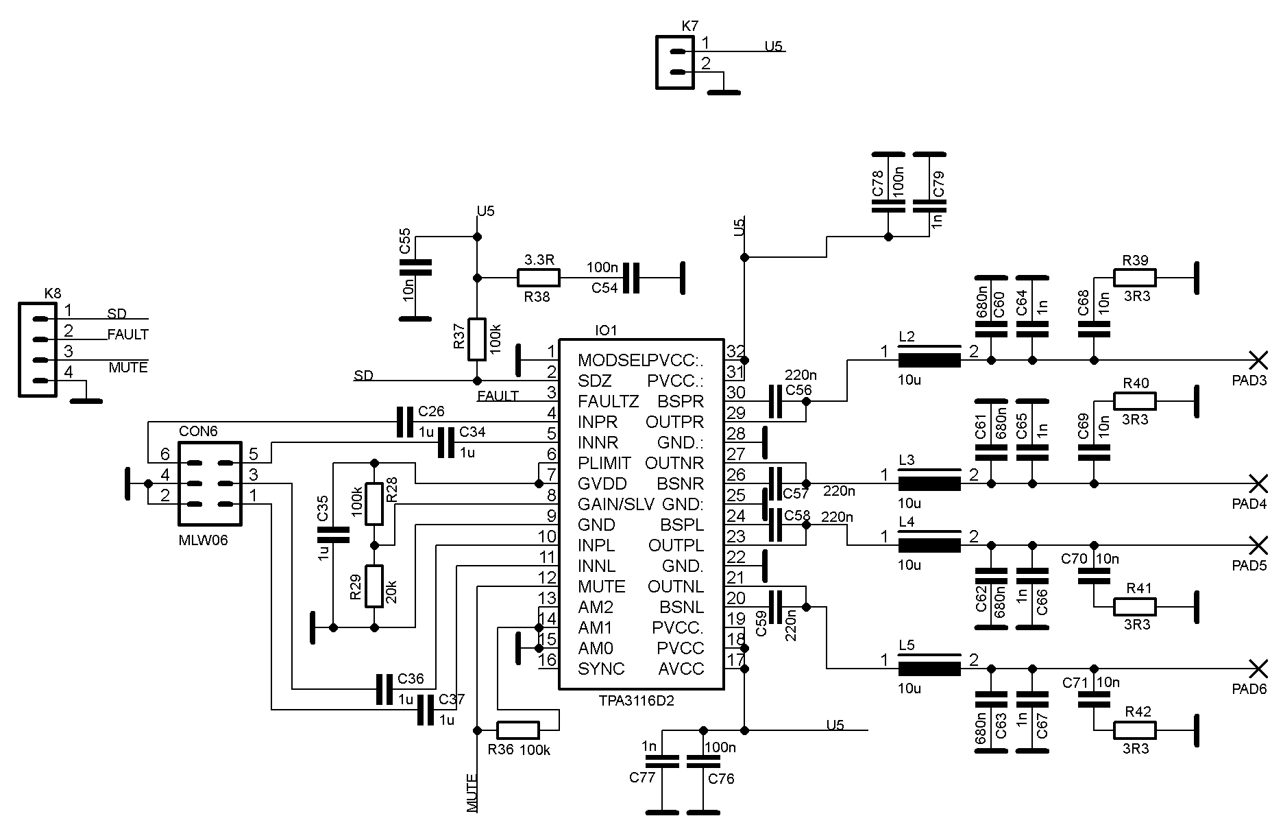

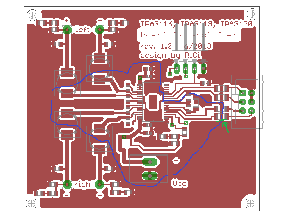

Hi guys, I create my own PCB for this AMP. It works, but very quietly. When i powering it by 10V, it played same, like when i powering it by 20V. When i want loudly music a must intensify volume on the maximum (portable MP3 player)
Is there anyone, who know why did that's happen?
Are FAULT and SD jumper pins normally connected? If not, then that will be an issue. In that case you have to pull the SD pin low while audio signal is connected and disconnected otherwise you will have a fault that will not clear again until SD is pulled low. Or alternatively you have to cut all power while you connect or disconnect an audio source.
Also on the board layout AM0 is not connected to ground. Please make sure you connect this to either ground or logic high, otherwise the chip does not function properly.
Lastly, I do not see a ground connection to the negative inputs. If your input is single ended the negative must be grounded.
Thank you
Thank you very much, it work ... and maybe i have got wron a setting of input impedance, i have got set 60kOhm ...
You probably accidentally changed R28 and R29 around.
EDIT: You also have a ground loop on the board layout. I have illustrated it below (in blue) and where you should be able to cut the loop without affecting other functions (green arrow).
