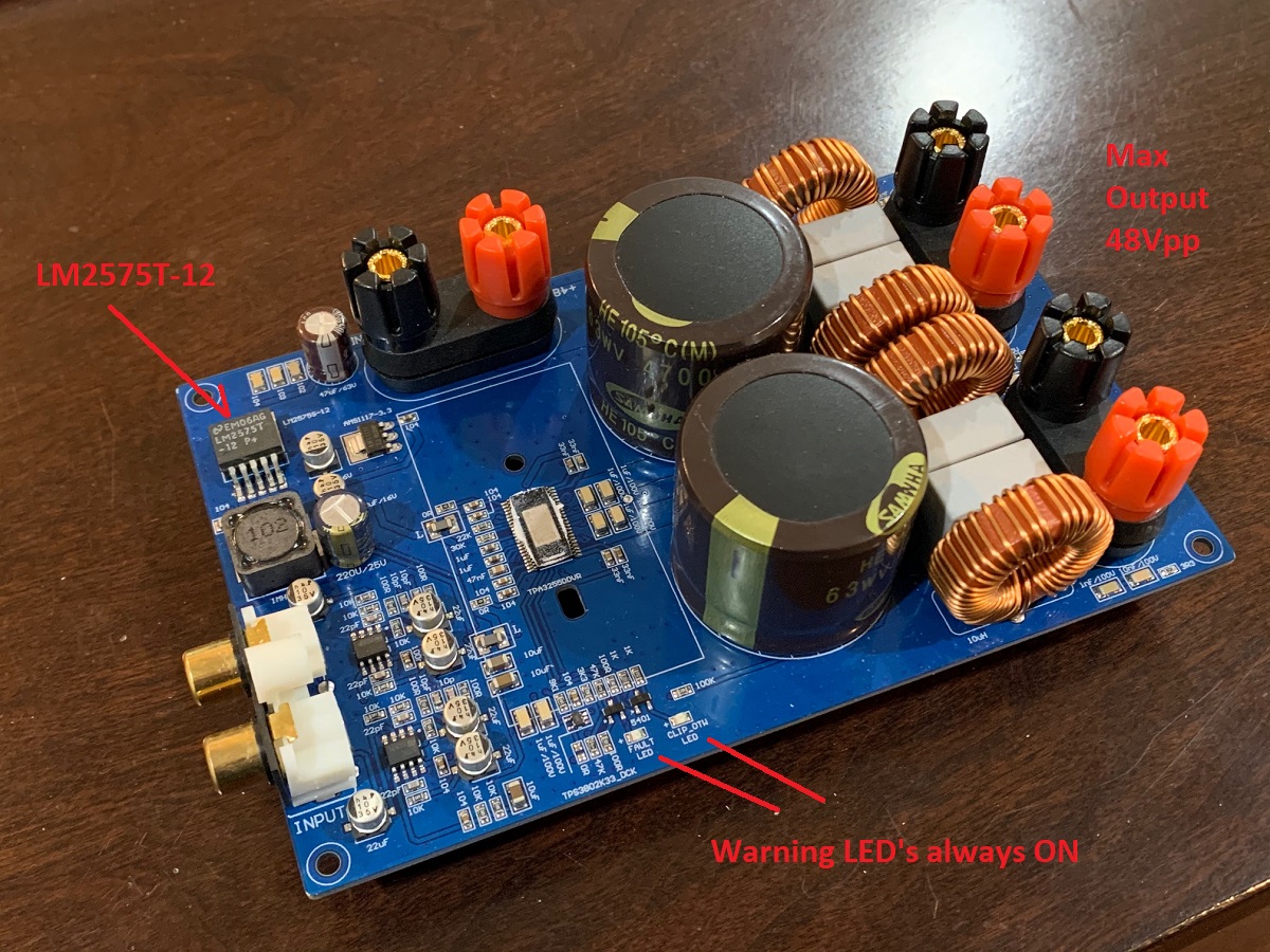

That board has errors on it that prevent it from being a practical amp. I bought two from different vendors and one was on Amazon. Still same problem because same layout.
1. The error lights for fault and OTW are always on when operating normally. How useful is that?
2. The amp has no remote reset capability, so if your input RCA has a glitch, the amp goes onto protect error mode and shuts down. The only way to reset is to unplug the power input. That is every inconvenient as the errors can happen with something like hot plugging in the RCA to a source.
3. I was unable to get more than 48Vpp out of it with a 51v PSU. I believe the hardwire soldered or layout based setup mode jumpers were incorrect and so it is not working in BTL mode which should give a swing of close to 2x48v minus MOSFET dropout on each end or 96v-8v or +/-78v theoretical max or 27.6Vrms for 190w into 4ohms.
4. It has an LM2575T-12 switching step down regulator for make 12v. That’s only good for 40V max input. It needs the LM2575HV-12 version which can go to 60v input. So I suppose the regulator must be sort of working because it makes music with a 48v to 51v supply, but who knows what the regulator is doing in terms of regulation.
5. The measured harmonic distortion profiles were not close to the specified levels of the TI reference design.
Basically, I can’t believe they went into production of tens of thousands of these boards without anyone catching these glaring errors.

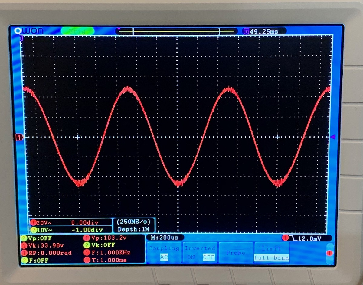

I did a full power test to see where clipping occurs. 51v DC-DC from 12v battery as power source for 51vdc. Driving with 1kHz sine wave from a pocket DAP and headphone amp through THAT1646 SE to Balanced line drivers Amp connected to EBG 300w 10ohm resistor cooled with CPU cooler. I got 32.1Vrms from a Fluke 116 True RMS DMM, that's about 90.1Vpp. The Oscope showed closer to 100Vpp. If this were driving 4ohms, it would be about 190w, maybe 200w.
Here is Oscope screenshot - this is right at onset of clipping, so starting to get a little ragged at the peaks:
Into 10ohms, this is 103Wrms. This amp can definitely make some power.
