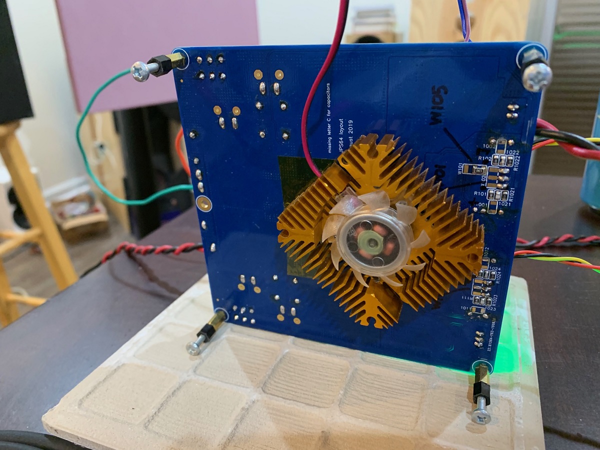

Regarding a HS, or HSF.... You've shown several different styles and sizes throughout the thread, including one low-profile CPU cooler. Image attached. Do you have a link to this particular one? I've been searching some this afternoon and can't find anywhere. Will keep searching. I'm not sure exactly how I will mounting it, but would like to have it on hand just in case. Noted that you had a 60Hz hum with it attached to AUX PSU.
Yes, that’s it. I used a couple of Faston spade terminals as the copper spacers to elevate the heatsink above the components. Just drill and tap two M3 threads at the specified spacing. I used a 100R 2W resistor to slow the fan down. But if you have a conventional heatsink you will be fine for most playing. I needed it when doing the full power 190w test. That’s about 20w per channel or 40w if running both.
Yes, the cpu cooler is mounted so close to the amp that if it has any hum, that leaks into the signal. When I powered it from the on-board 12v LDO output, it was silent. I did not see any sign of noise from the fan in the FFT either.
Other things to look for are standoffs tall enough to handle the board and bottom heatsink whether fan cooler or thermal block to conduct to main chassis panel. Remember that the thermal pad should be electrically isolated from the chassis. I used a ceramic transistor spacer pad and thermal paste.

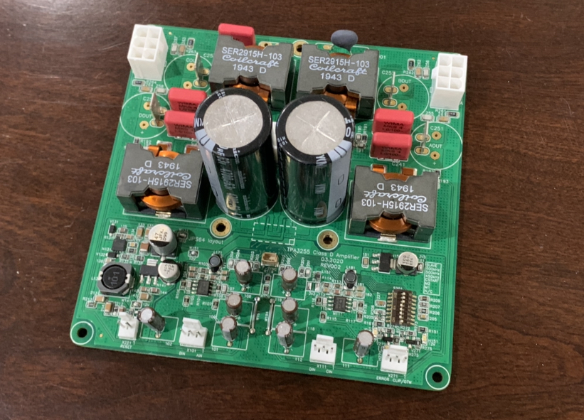

Hi Redjr and all Folks who ordered a RTR amp:
So sorry that this is taking so long. If any of you bought RTR SSRs from me, you will be familiar with the time it takes and that is a simple small board. My lesson-learned is that production of fully built boards takes an enormous lead time. The parts have been ordered and delivered to the assembly house in California. I had to order more boards as I did not have enough and they are about 2 days from finishing production. They will be express shipped via DHL so I should have them to the assembly factory by end of this week. The pick and place machines have been programmed and will be loaded and ready. Actual robotic assembly and reflow will take a few days. Then another few days for the through hole parts to be hand soldered. So, my estimate is 2 more weeks.
Thank you for your patience!
Great news folks. I just received the first verification unit back from the assembly house. It looks superbly well built and very neat. I tested it and it works great and sounds excellent. I will tell them to complete the rest of the amps. They should be all done soon.
