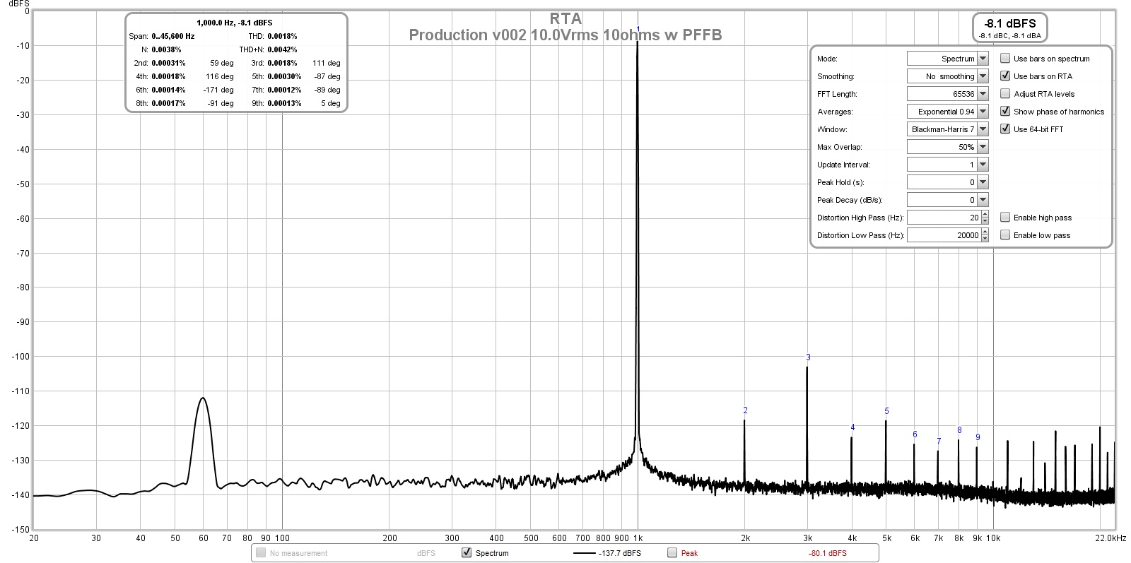

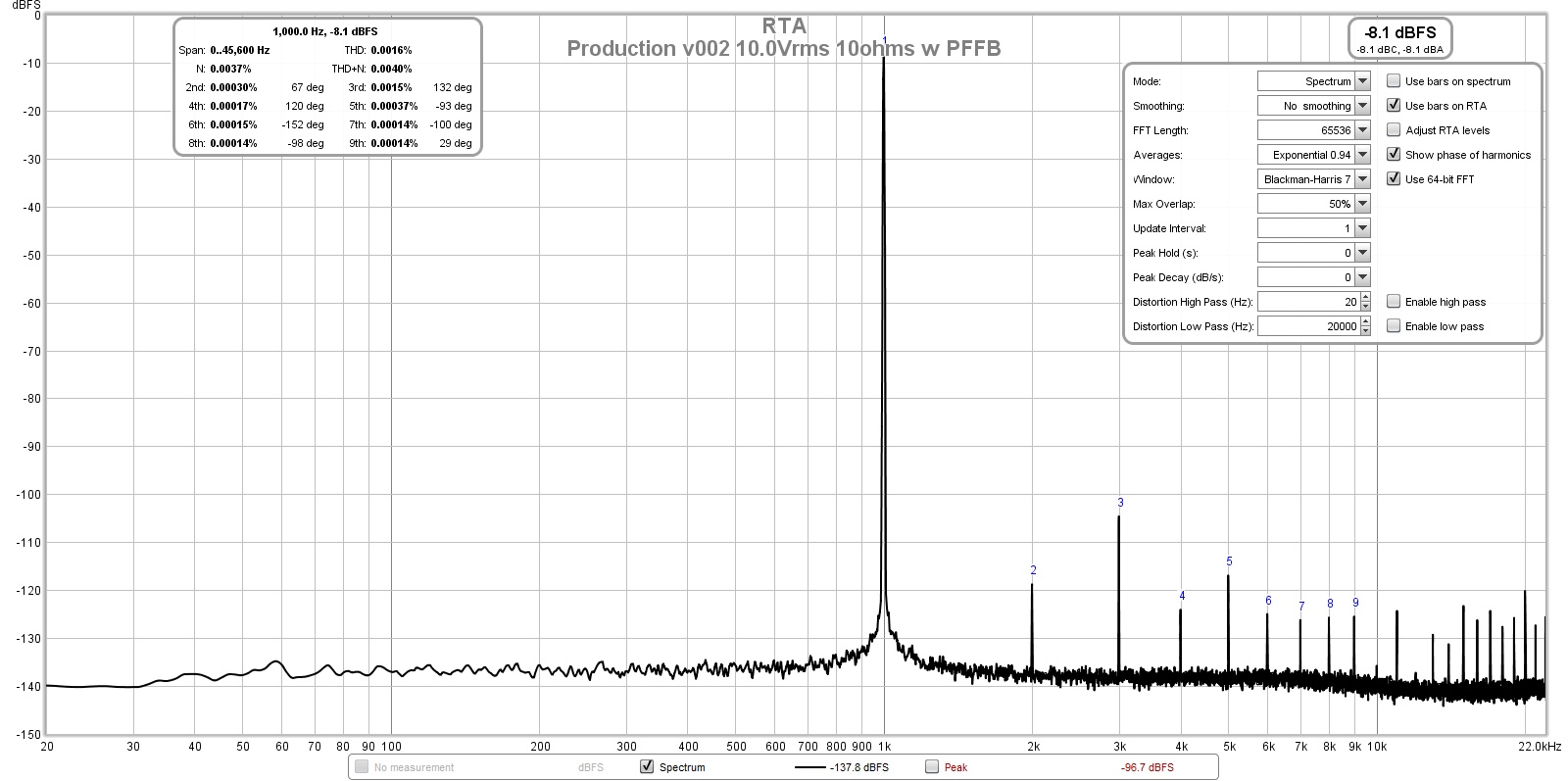

I measured the new amp's performance for THD at 1khz and 10W to compare with the TI application note on PFFB for the TPA3255. Table 48 says that at 10W, THD is -93.55dB (or 0.0021%THD). I measured 0.0018% (-94.89dB) using an EBG 10ohm 300w dummy load with a THAT 1646 SE to Bal driver and a Cayin N3 playing a 1kHz Flac file. Here is the FFT for 10w:

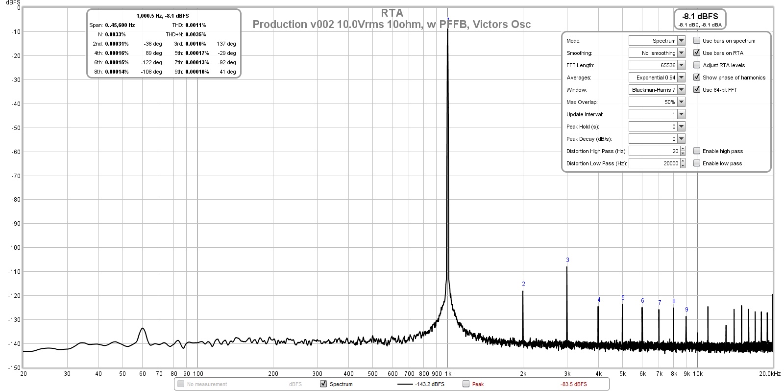

So one more thing I tried was to remove the Cayin N3 and Fiio A5 from the source chain - they are nice headphone amps, but may actually have more distortion than the TPA3255. So I installed the aboslute best DIY sub-ppm THD 1khz oscillator I could get my hands on: Victor's oscillator (uses 4x 9v batteries and has THD that is basically below the measurable limits of most consumer gear). I used it to directly drive the THAT1646 (which in itself, may have limitations at some point). Surprise! For the reference test case of 10W into 10ohms at 1kHz, I now get 0.0011% THD! Wow!

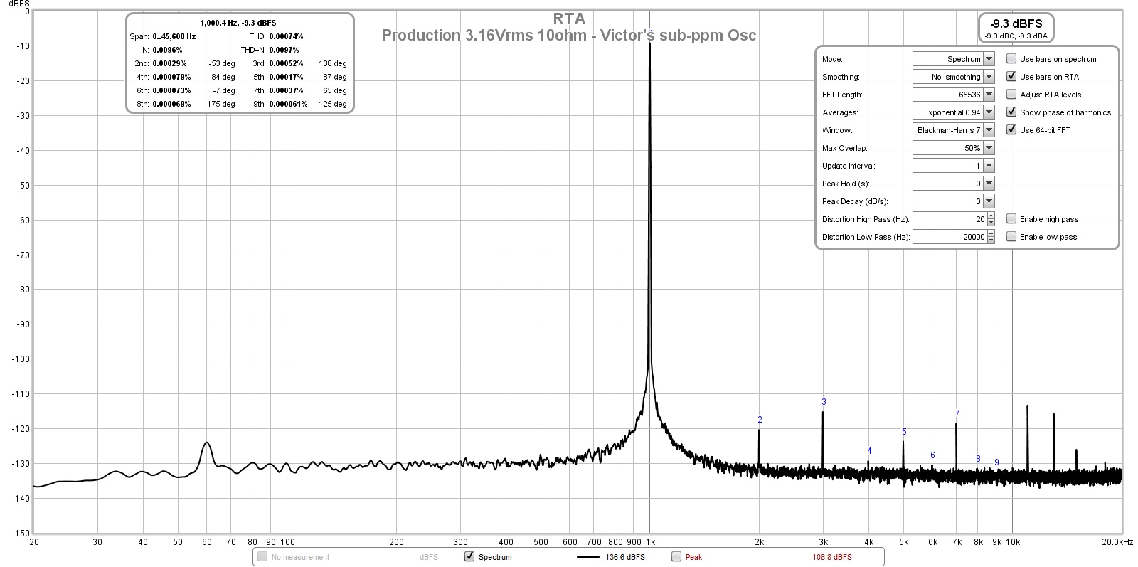

And just for completeness, here is the 1W case or 3.16Vrms into 10ohms, I now get 0.00074%THD:
Ok, I think my job is done now. This amp rocks, and the performance significantly beats the published specs from TI - probably due to JPS64's layout, the use of a great low distortion output inductor, and other quality parts and fantastic Made in the USA (California) assembly!
