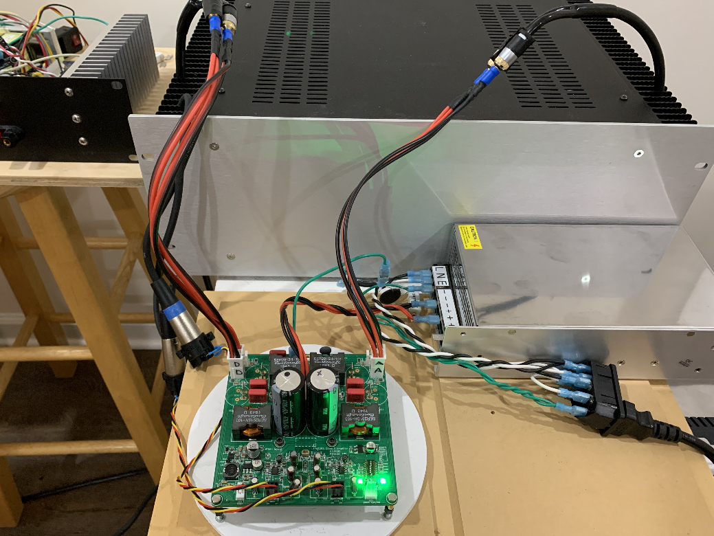

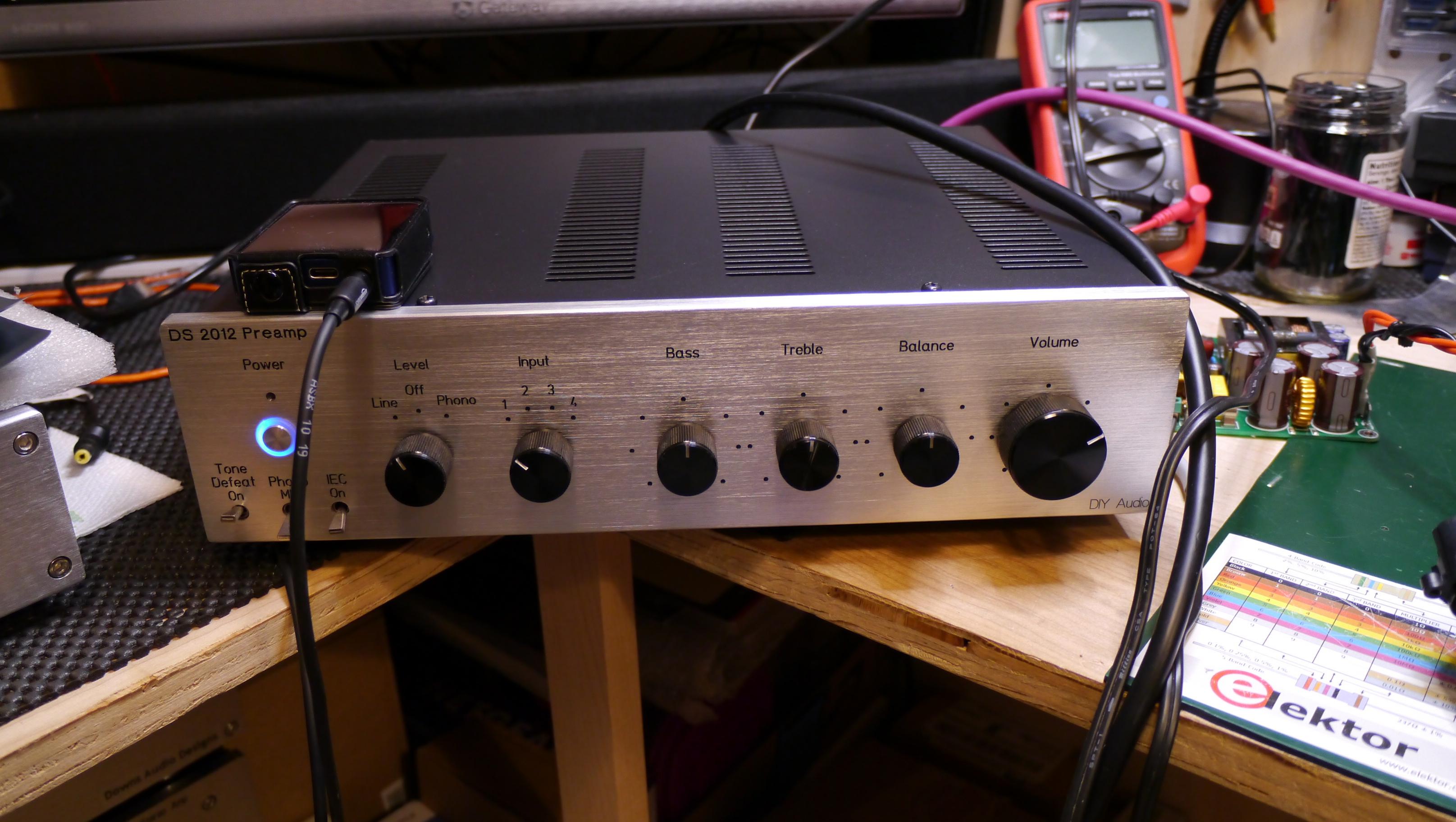

Have the 3255 singing quite nicely on my bench this morning, letting it break-in a bit. For testing purposes, I decide to wire up some XLR connectors. This allowed me to use my Doug Self pre directly, without wiring up the 1646 THAT adapters. Listening to it now as I write this. Even using some cheap speakers on my bench, all I can say is that it is very articulate, lots of dynamics and quiet, quiet, quiet. No PSU, pre, or amp artifacts getting in the way of the sound. The way it should be.

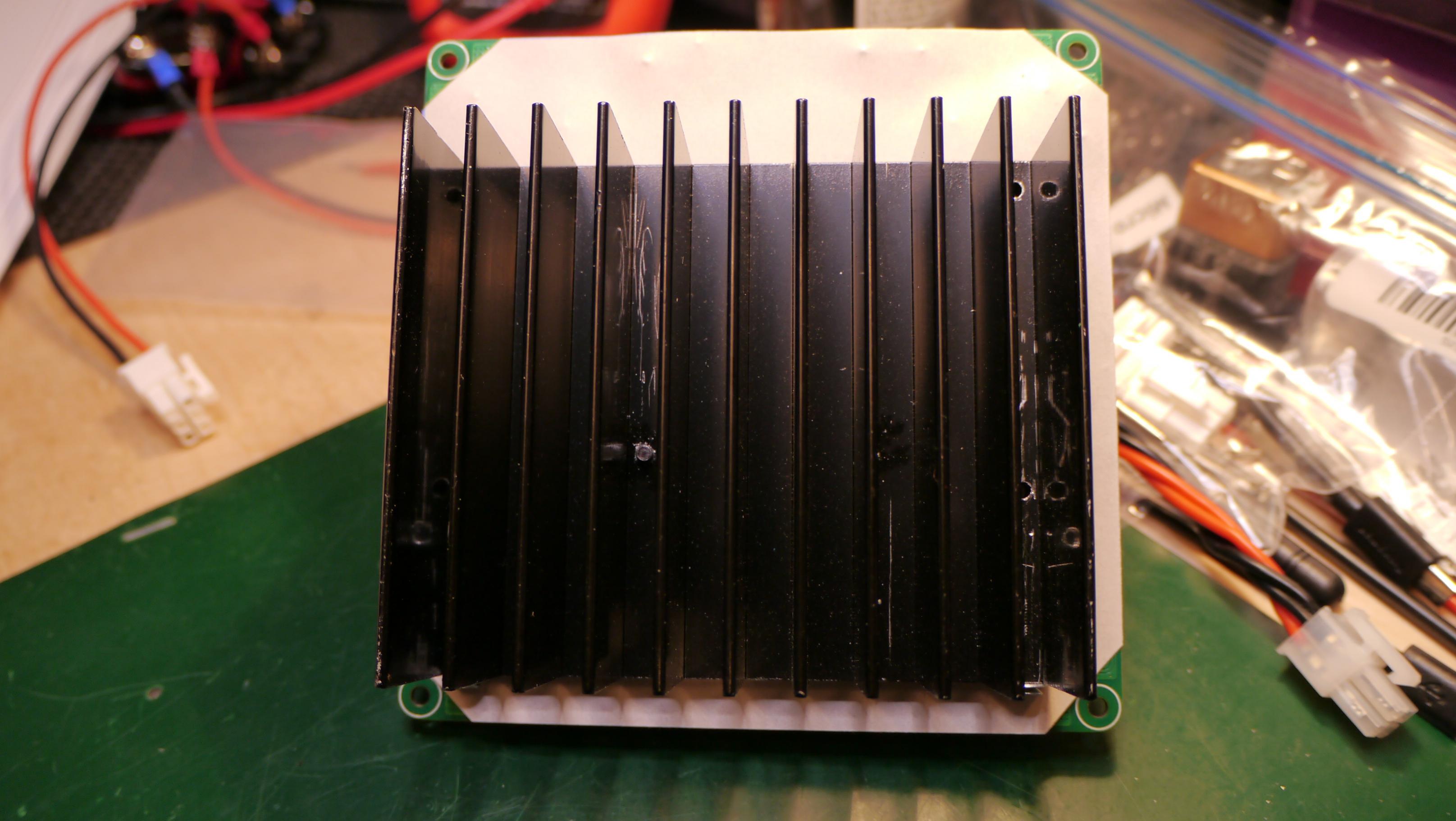

Attaching the heatsink to the chip was a bit tricky (and delicate), but I managed for purposes of testing. Not sure if this will be the approach I will use when I fit it all in a enclosure.
The pictures below illustrate my approach using thermal tape and a small piece of copper to act as a riser and heat spreader for the heatsink. I then cover the bottom of the PCB with fish paper to avoid any shorts to the HS. This way I can reuse the same strategy if I use its final enclosure as a the heatsink.

Very nice work, Redjr! Glad you had a balanced output Preamp. Doug Self one is outstanding. Kapton tape makes a nice insulator shield to prevent shorts. I found a 2mm spacer between the chip and heatsink clearly elevates it to prevent any shorts. Please try double 16ga silicone wire on the speaker outs of you get a chance. I was surprised by the difference in bass dynamics.
My TPA3255 came just in time for me to test my new Purifi PTT6.5 and RS28F passive Harsch XO speakers as they are 4ohm. All my other amps are 8ohm.
What brand of PSU are you using - sounds like it is quiet! This amp’s quietness is very impressive.

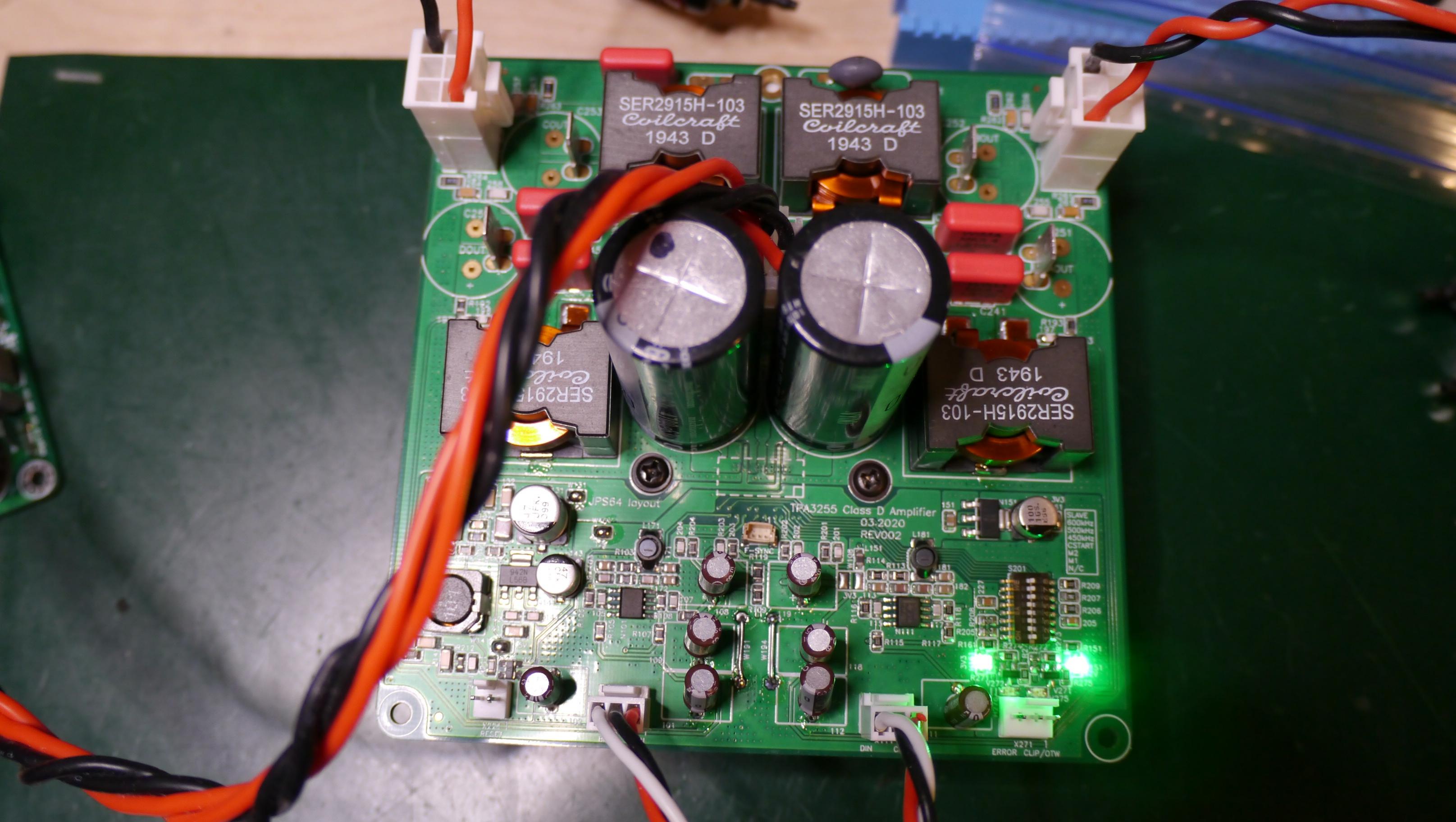

I just noticed that your speaker out on the left side is reversed. Red should be on the back (C) and black on the front (D). On the right A (red) is on the front, and B (black is on the back) - you have that correct. The bass may be low and the sound will have a strange phasiness if output polarity is flipped on one speaker. This assumes Ain and Cin are +ve from the balanced preamp (which your photos shows correctly).

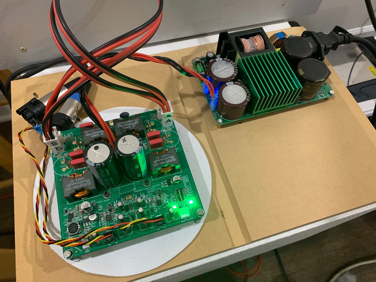

At the moment, I'm using the positive side of a Connexelectronic SMPS300RE I had. I read in one of your threads awhile back that you mentioned that brand had a lot of noise. I've used many of his (Cristi) PSUs over the years, and been pleased with the results. Keep a couple on hand. Most of my little chip amps have them inside, as well as my ICEPower amp I built a few years back. I guess, if I can't hear any noise with my ear at the speaker it's good enough for me.
I also used 2 of Cristi's SMPS800RE variants in my favor amp of all time (FirstOne), and thought it was an excellent sounding amp. One that I grew to love the sound of. At least to my ears, in my listening space. But I digress.
I think I will double up on the speaker cables and add the extra wires a see what that does to the bass. Anyway, I'm still testing it and letting it 'warm up' a bit more today.
Thanks. I'll fix that now.

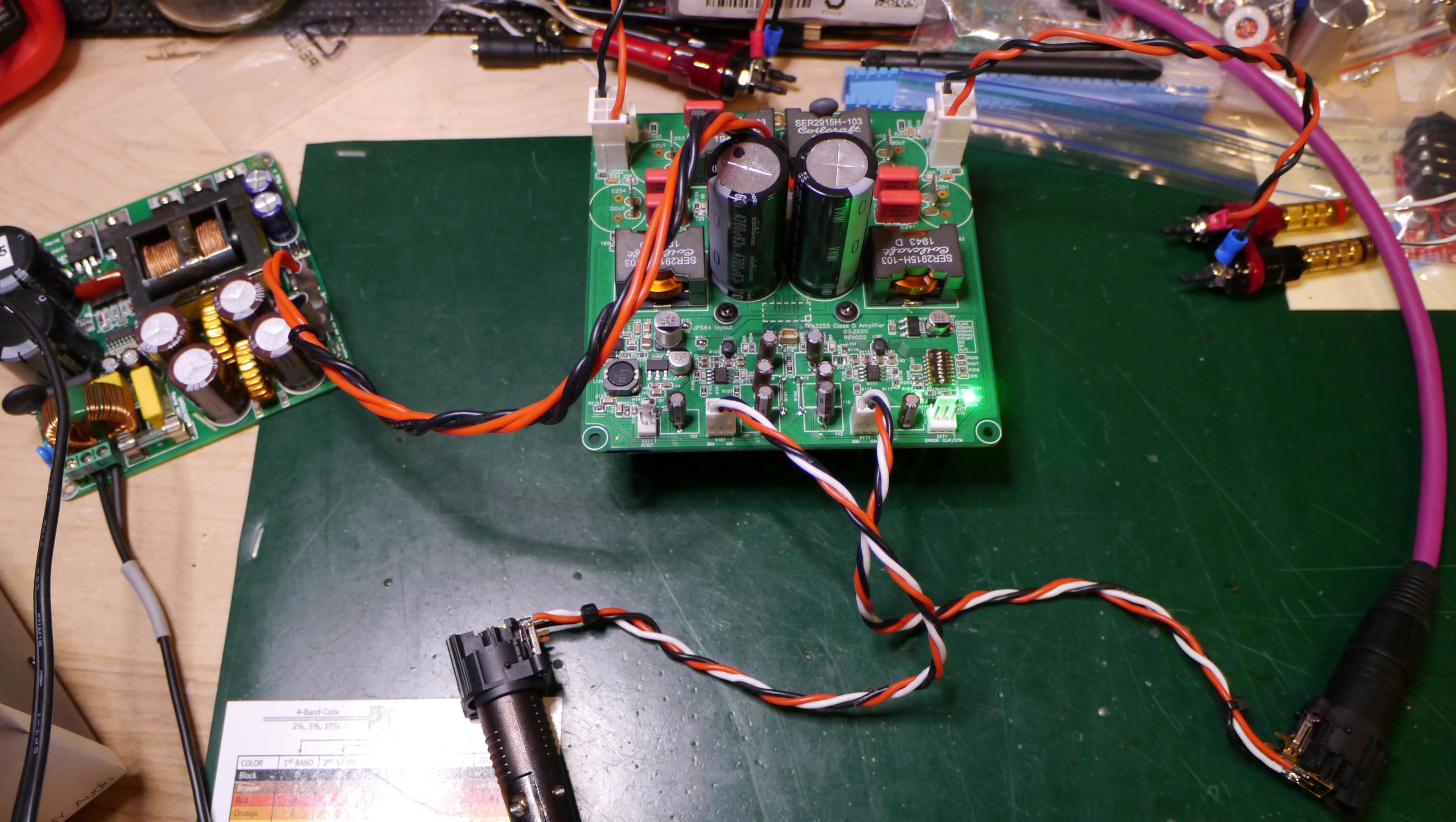

Your experience with the Connexelectronic PSU and this amp got me to give it another go. The last time I tried it was with the 3e TPA3255 amp and the Aliexpress/ebay EVM clone (blue board) and the SMSPS800RE. It had terrible hiss that could not be eliminated. I even tried adding a CLC filter in between. Finally, I gave up and relegated the Connex SMPS to the heap of unused "junk" boards.
So I dusted off my SMPS800RE and connected to MY TPA3255 Reference Class D amp, and it is quiet! There must be something in JPS64's layout and my extra RFI filters in the circuit! I know JPS64 pays extra attention to the filtering of his on-board DCDC step down circuit to make the 12v and 3.3v auxilary power for the opamps and digital logic. So great news is that my formerly $150 (with shipping) "door stop" of a PSU is now useful again. However, I see no benefit over the $44 Aliexpress LED 800w SMPS that I used previously.
So thank you for testing it with the Connexelectronic.
Let this be a retraction to my earlier comment that the Connexelectronic PSU cannot be used without noise on my particular design of TPA3255.
