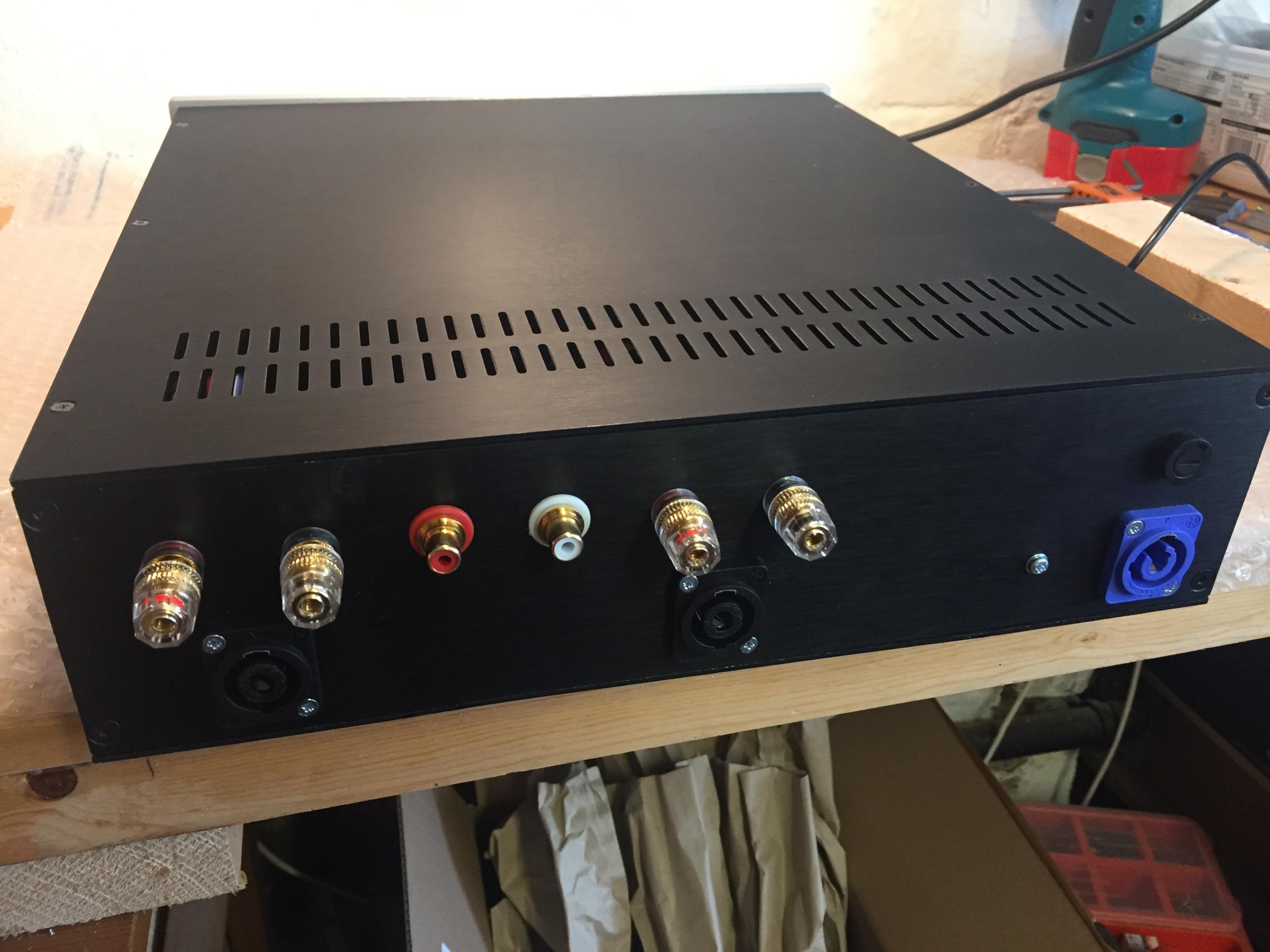

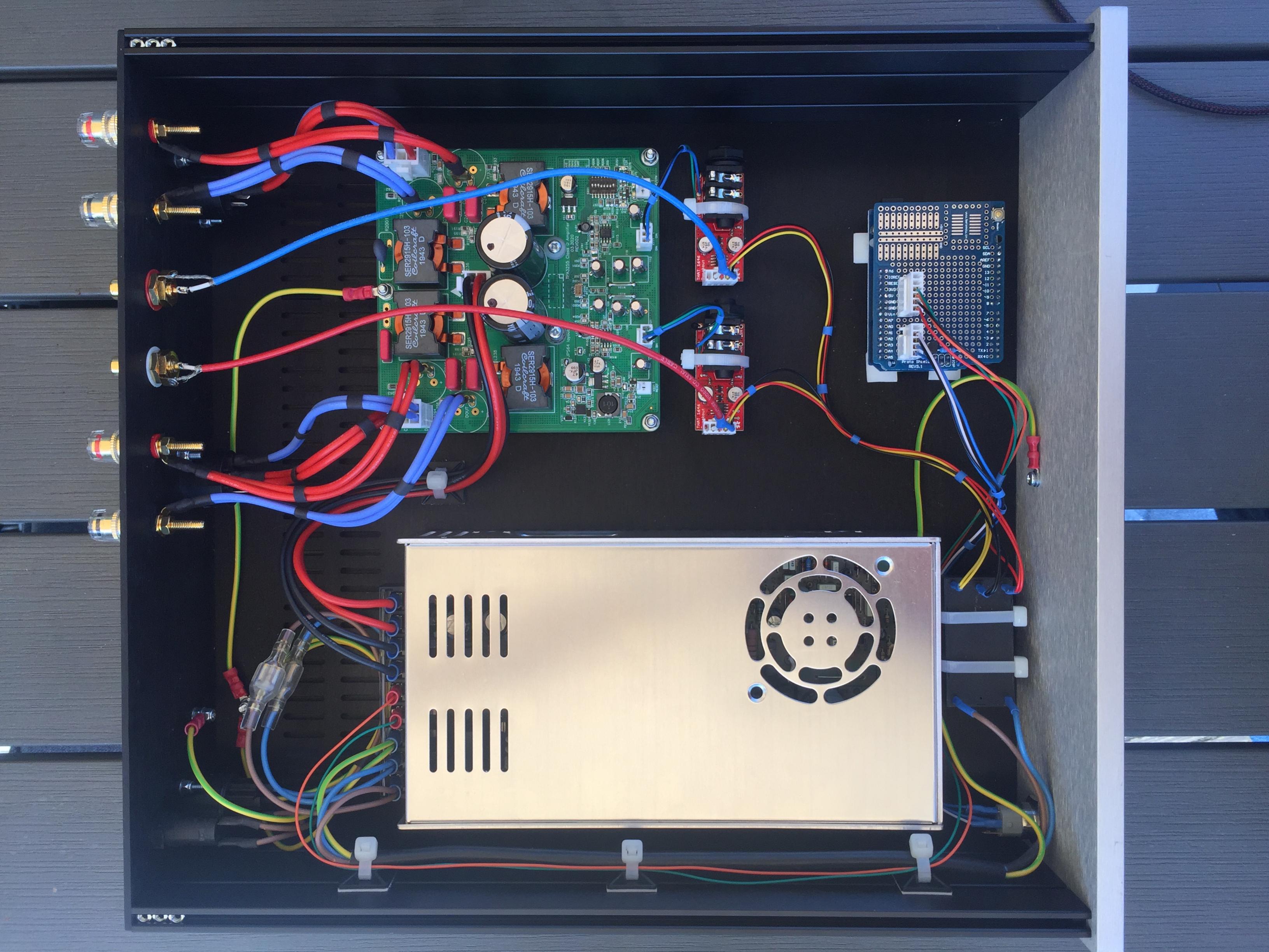

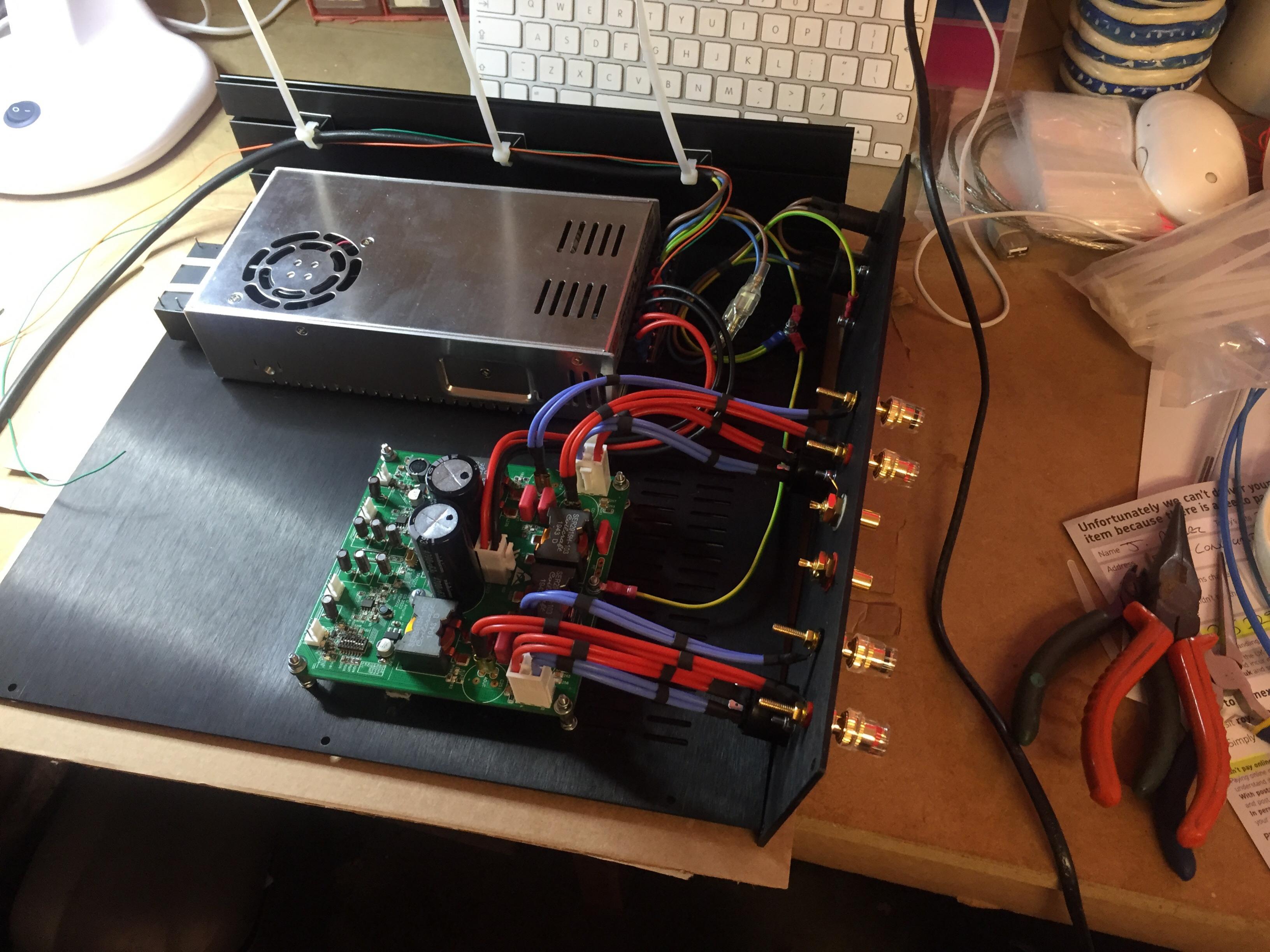

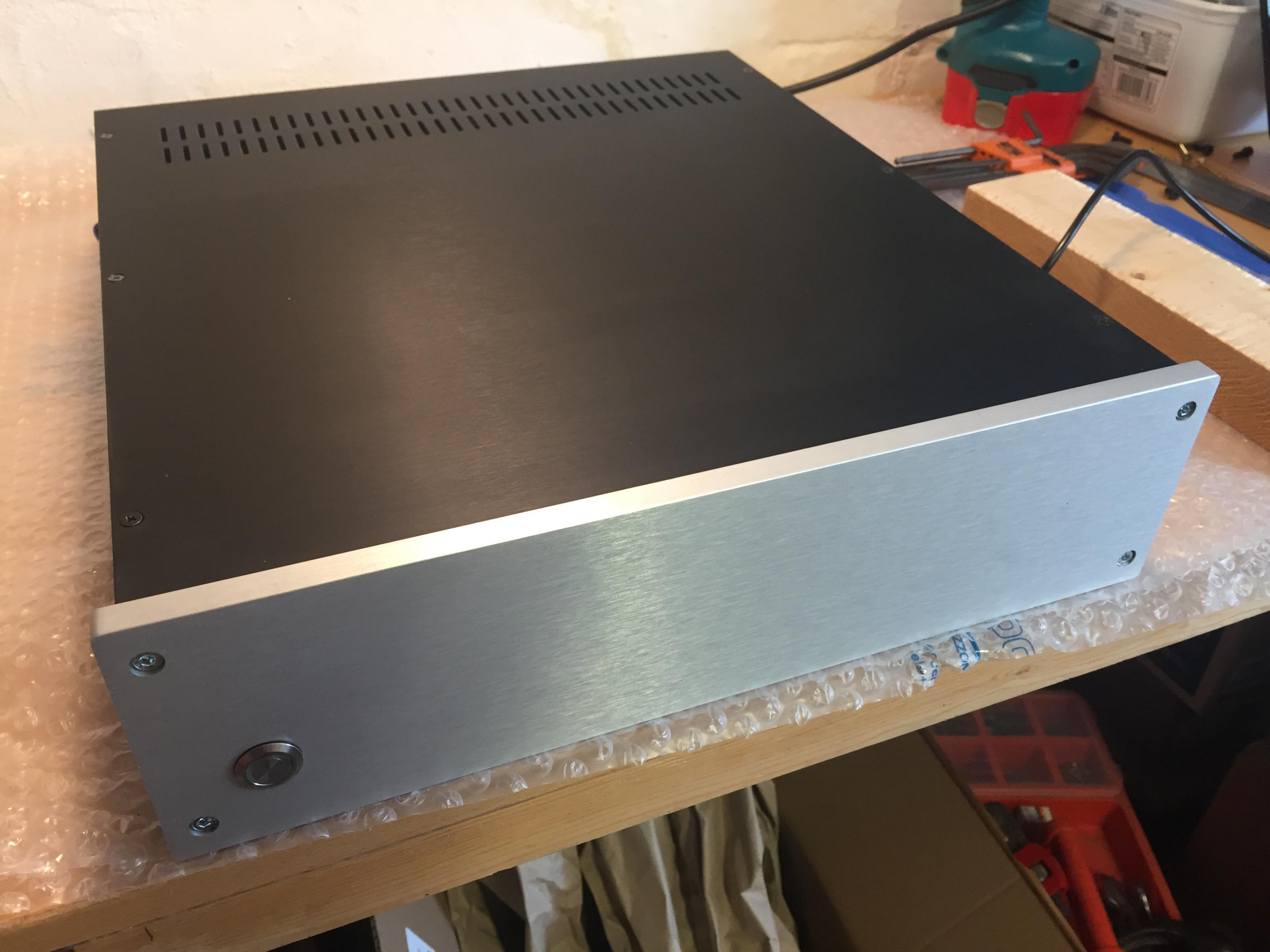

It lives! Playing now :) The PCB is really nicely done. I used the chassis as a heatsink.
Modushop box, Meanwell SMPS, Sparkfun SE/Bal converter, Arduino Leonardo.

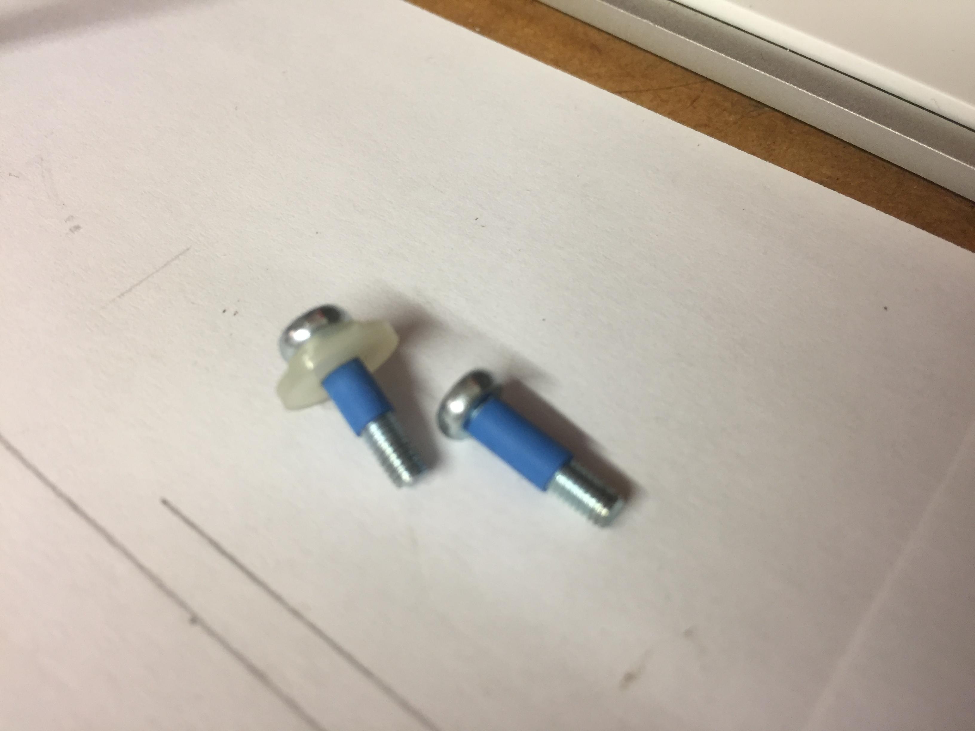

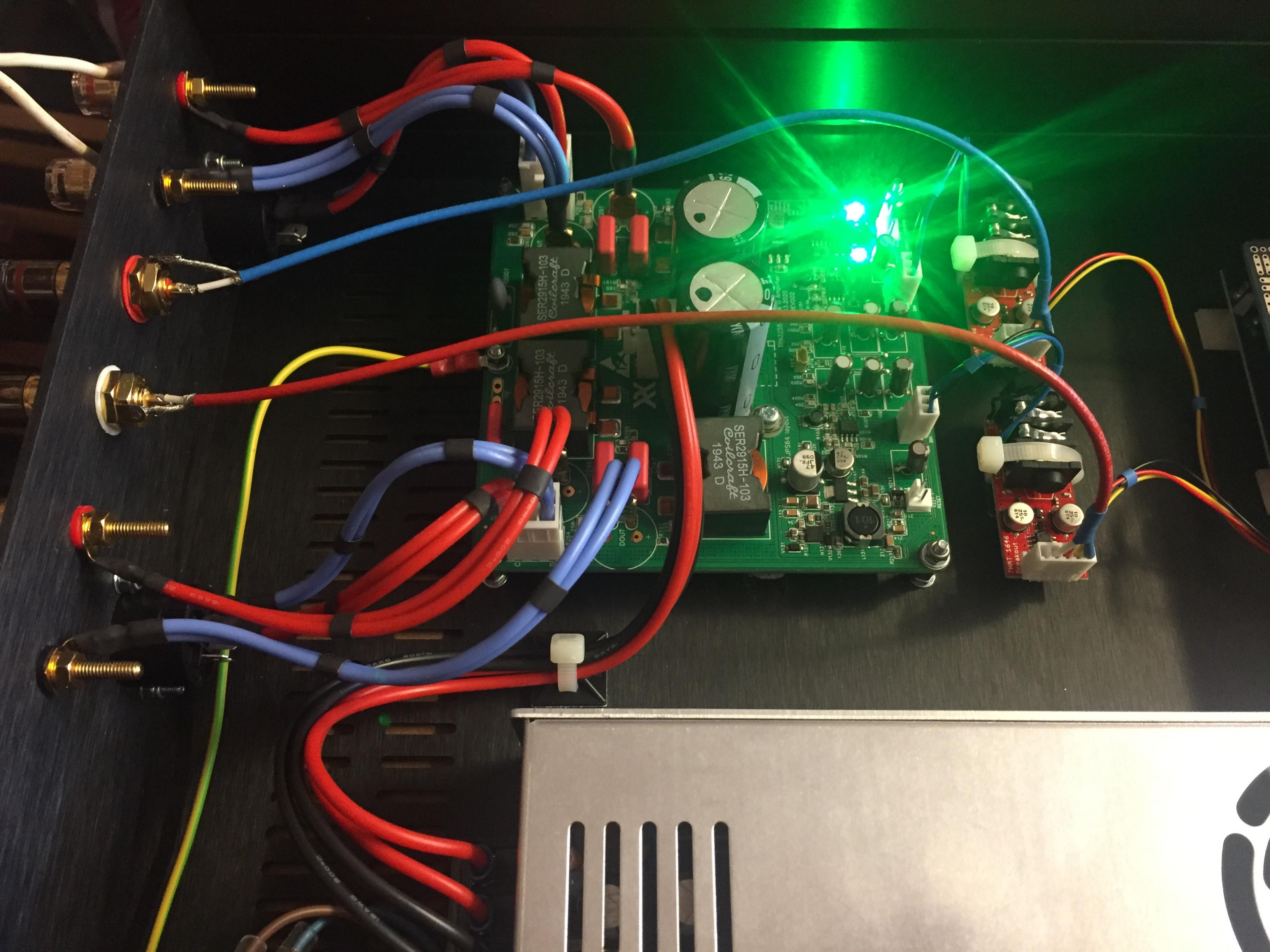

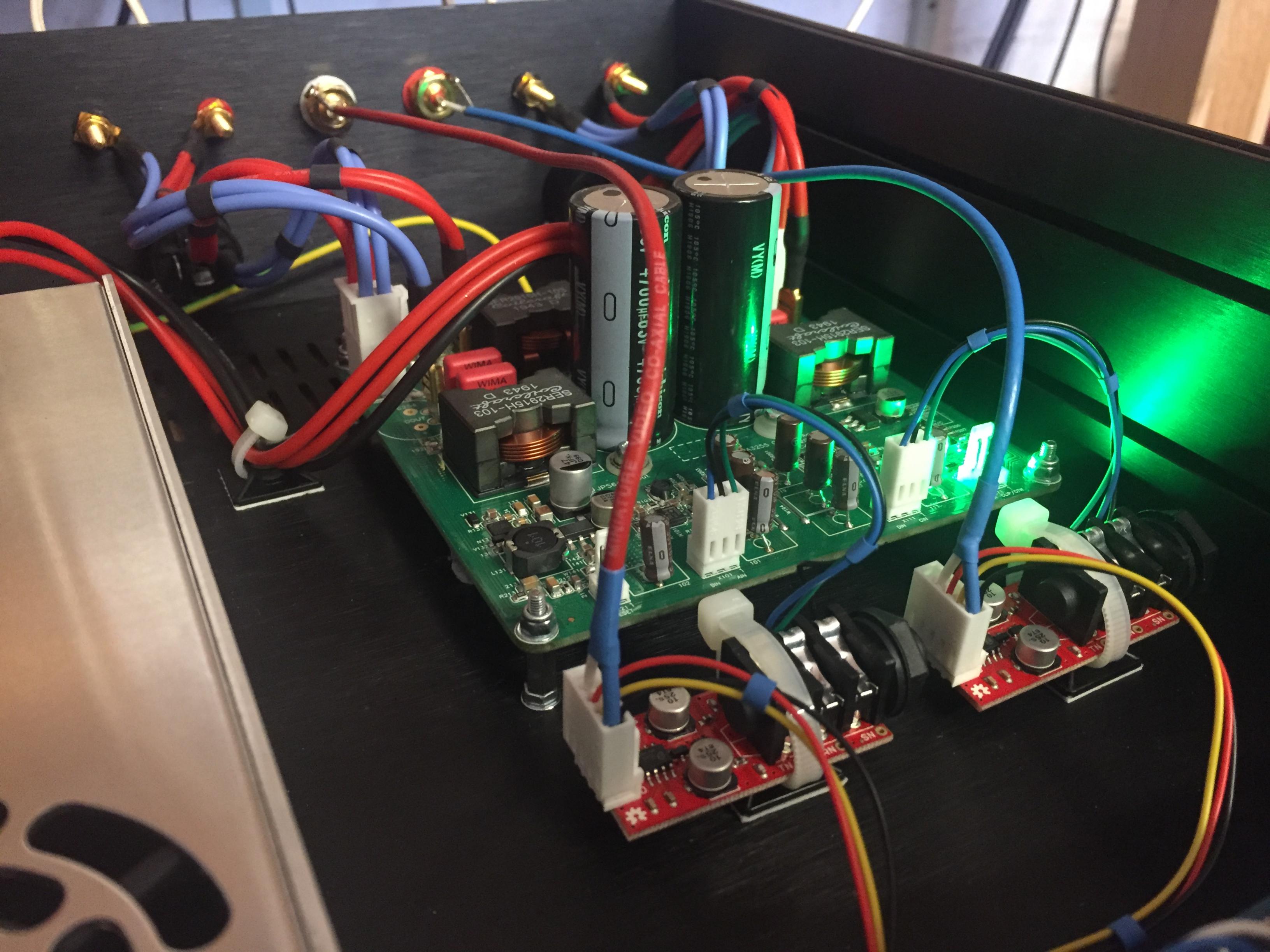

I used the PCB to make a template for drilling the chassis, and then a 10x10 aluminium bar with a TO220 ceramic insulator for heat transfer to the base plate. I got the height of the PCB right by adjusting the make up of the mounting bolts, ending up with 1 washer, 1 nut and a 10mm hex spacer. Improvised some insulated screws for the heatsink mounting by adding some heat shrink and the only nylon washers I had to hand which were far too big to drill the PCB for.
The ceramic insulator must be rotated 90deg to the orientation shown in the photo (see the arrow). The end of the insulator with the hole should hang over the edge of the bar towards the "input" end of the PCB otherwise it will rest on the SMD capacitors rather than the IC. It needs to be placed accurately as there is not much clearance to the surrounding components. I added a very thin layer of "Arctic MX-4" non conductive heatsink compound between the IC / Ceramic insulator / Alu bar / chassis.
I'm really pleased how this has come out - great work xrk971 and all involved.

Beautiful job, Jrosser! Very impressive looking and so neat and tidy!
You are certainly not going to have any loss of impedance between the amp and the speaker output posts with 8x 14ga wires per speaker! :)
What does that Arduino do?
How is the MW PSU working out for you? Does the fan kick in and out t the noise and issue?
Congrats on one the nicest builds for a Class D amp I have seen.

Just to clarify the grounding of the thermal transfer block from the chip to the chassis: The block itself can be bolted to the thermal pad of the TPA3255 directly. No shoulder washers or insulation or ceramic pad needed. However, the thermal block needs to be electrically insulated from the chassis. This can be done with silicone sheet.
The way you did it works too - isolate the thermal block from the PCB 0v and TPA3255 thermal pad. Then the thermal block can be in electrical contact with the chassis.
The nice thing about the silicone thermal spacer is it allows some give so that the height differences are accommodated somewhat.
Hi xrk971 - thank-you for your kind words! I've really enjoyed putting this together, probably taken about 30hrs with all the metalwork.
The speaker wire isn't quite that excessive :D I've used speakons on the back panel as well as 4mm posts, so the mini-fits go to the speakon outlets and the fastons to the binding posts, it's 16ga silicone wire which crimps beautifully. Doubling up the wire and adding the heat-shrink rings makes it 'set' into place and stay put which has really helped the tidiness.
The Arduino is connected to the front panel switch (momentary) and LED, plus it drives the "RC" input on the Meanwell SMPS so the 48v is on/off controlled by the software. I want to add an opto isolator input for remote start, and may also hook up the fault/clip header of the amp board to flash the front panel LED. It's really there as a bit of forward planning....
The Meanwell PSU is working out fine so far but i've only had it running for a few hours so it's a bit early to say. I've had to remove the fan completely - the datasheet says it is speed controlled but it's very loud right from first power on. For normal domestic duties i'll probably be OK without it. The SMPS is this Mean Well SPV-300-48 chosen for the remote on/off logic input.

Please double check your left and right inputs. This amp board right input is on left side and output on right side. It crosses over since TPA3255 is on underside. Your photo shows left driving right and vice versa. Just swap the output wires from the THAT1646 to the amp.
