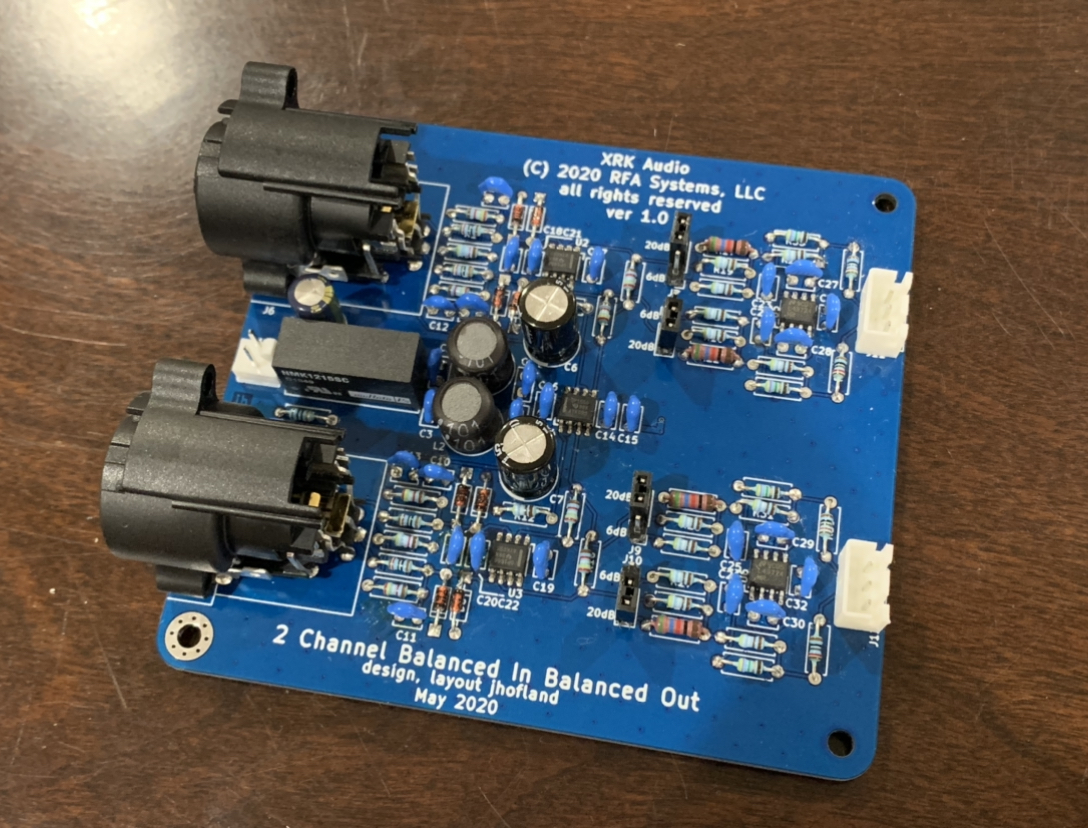

Let’s check with Jhofland if that’s possible. The boards have been ordered already. I’ll post the schematics, PCB image and details in a new thread later tonight. It will he called the BTSB (Best Thing Since-sliced Bread) Buffer. It does it all: Bal/SE in to Bal/SE output with selectable 0dB, 12dB, and 20dB gain. All using state of the art low distortion OPA1656 and LME94724 IC’s. Built in dual rail +/-15 PSU requiring only +12vdc input.
Soo, there is a "switcher" onboard!?

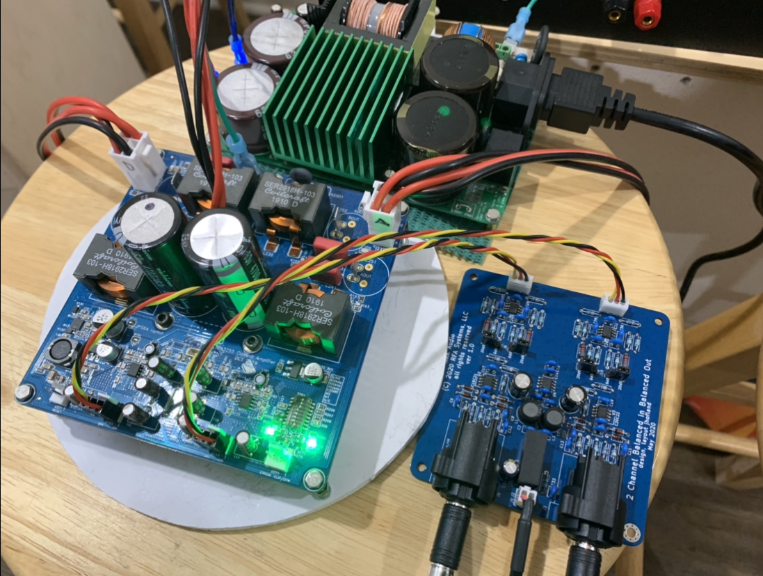

The SE/Bal to Bal preamp works great. Just tested it and it works as expected. Clean, no noise and gives the gain needed to drive the TPA3255.
I am using a 12v 1000mA Class 2 wall wart adapter. I am also using RCA to mono 1/4in TR plug adapters in the combo Neutrik jacks to emulate an RCA input jack.

That’s good news!!
It turns out I totally forgot that my Traktor s8 DJ control is also a DAC with balanced output. I’m waiting on a pair of CLR cable from Hosa and I’ll be able to make it play some music. Should arrive next Thursday.
Concerning the input impedance of the buffer, did you get some answers from Jhofland?

BOM has errors:
Part# for C133, C261-264 is incorrect
Part# for R1021-R1024 is incorrect.
I wish I verified this before placing Mouser order...
Typo is 0.047uF 100v X7R 1206 should be 0.01uF 100v 1206 X7R. Please use this cap for C133, C261-264:
VJ1206Y103KBBBE31 Vishay / Vitramon | Mouser
For R1021 to R1024, use anything from 10R to 220R. I have found 51R to be a good compromise.

This is good news too! Thanks Jhofland for your answer.

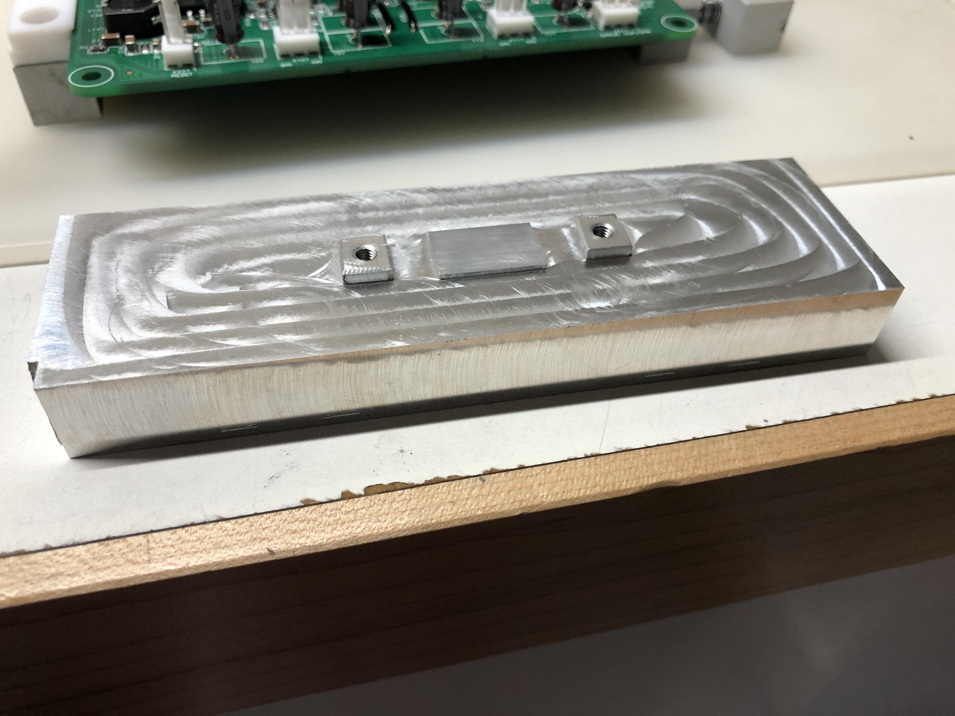

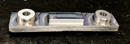

I got a spacer for the heat-pad machined today.
It provides the required clearance for the chip and the capacitors.
Fine adjustment is possible by filing down the bolt pads to exact height.
I'm attaching the GibbsCam file.
If someone has access to a machine shop it should be a breeze to make.
I used a 2"x0.25" flat bar of aluminum.
