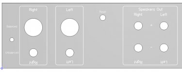

Please double check your left and right inputs. This amp board right input is on left side and output on right side. It crosses over since TPA3255 is on underside. Your photo shows left driving right and vice versa. Just swap the output wires from the THAT1646 to the amp.
Oh ha! Completely didn't spot that! Thanks

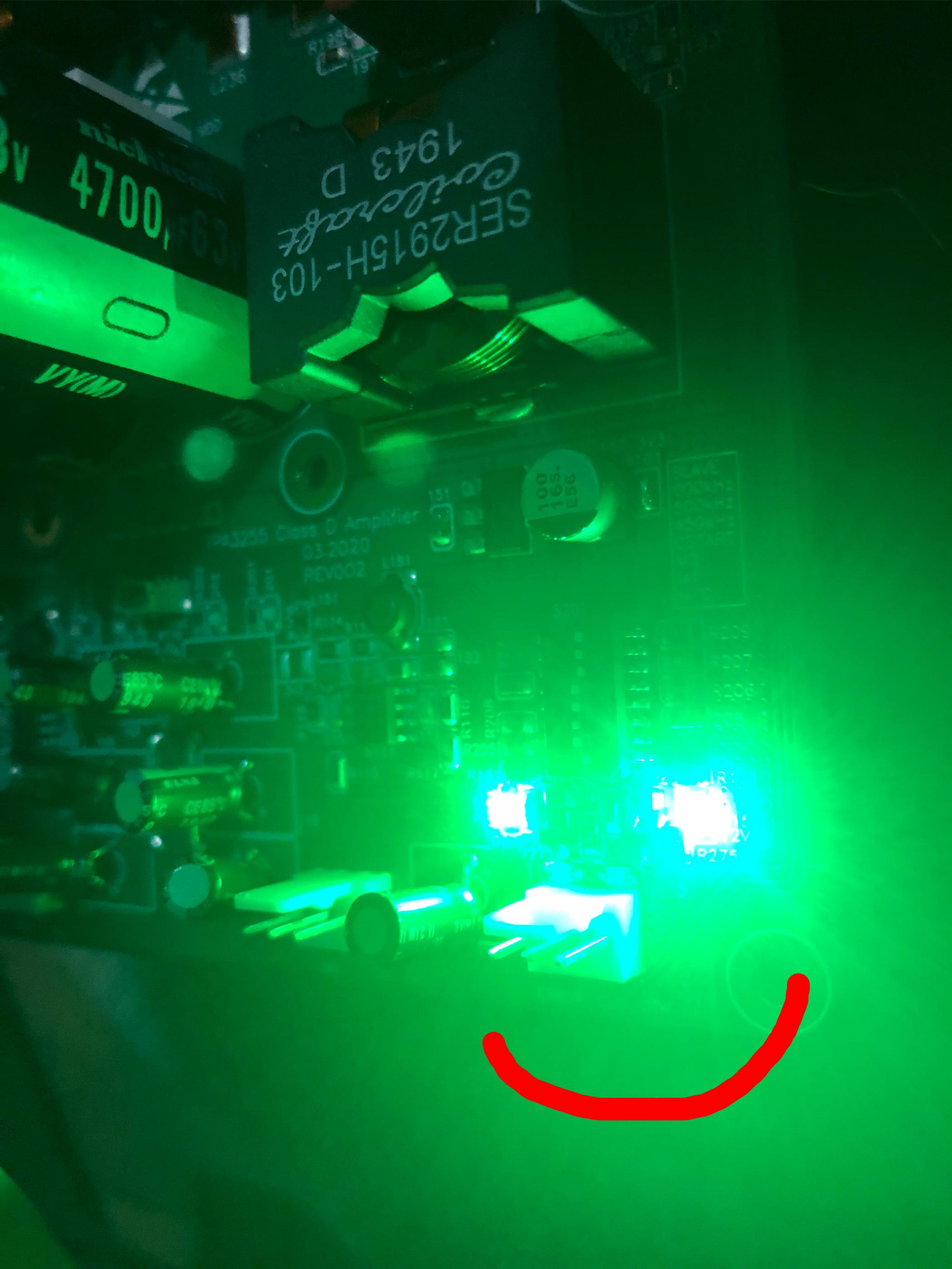

I got the board and now and I'm so stoked. This is a GORGEOUS board. I can't stop thinking of all the details to make a nice power amp with it, but I'm a newbie that is slowly learning through this forum.

Glad to see the green lights!

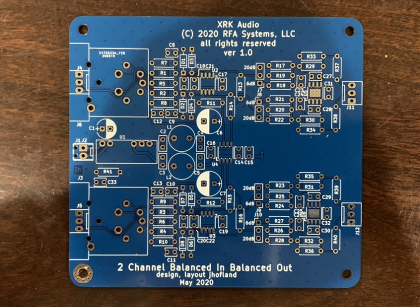

Here is the board. I just ordered the BOM and will be assembling it as soon as parts arrive. It should sound completely transparent like it’s not there but provide the gain needed and conversion to balanced if needed.

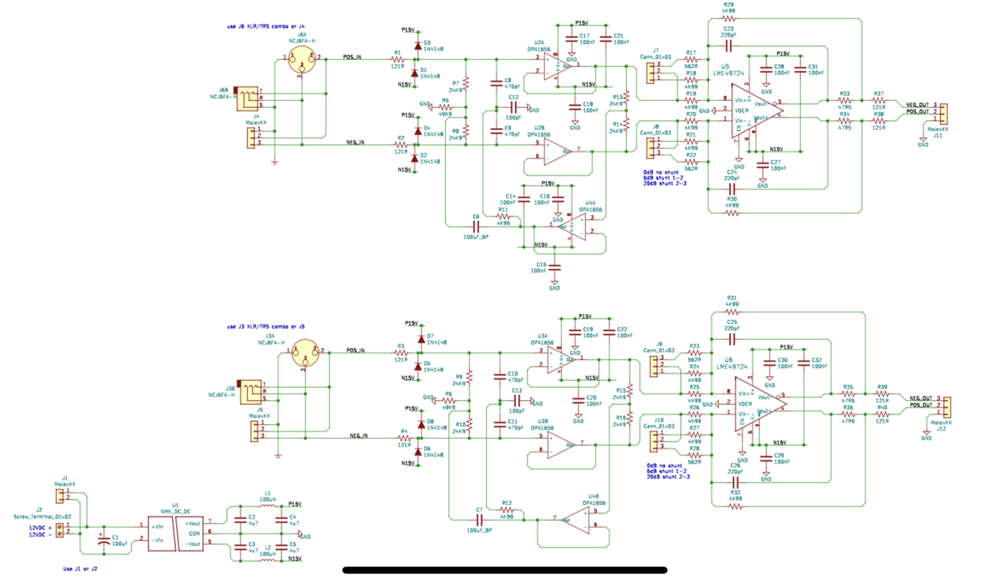

Here is the schematic. Excuse the low resolution image - screenshot of a big pdf from my phone was best I could do.

Hi X,Here is the board. I just ordered the BOM and will be assembling it as soon as parts arrive. It should sound completely transparent like it’s not there but provide the gain needed and conversion to balanced if needed.
I would be very interested in this board. Right away! I was looking for a workable solution to allow for dual inputs (Bal or SE) to build into my amp. I was going for some type of active switching off of the THAT boards when using the Balanced-In connectors. Your module is the perfect solution. Do you have an extra PCB you can spare and the BOM?

Jhofland built the prototype of the SE/balanced to balanced buffer and it works well. We are going to make a few mods for the final version for production. We are adding a SE output in parallel to the balanced output. We are also changing the gains to 0dB, 12dB, and 20dB.
So it’s a Bal/SE to Bal/SE converter. Should be really handy - the best thing since sliced bread...
